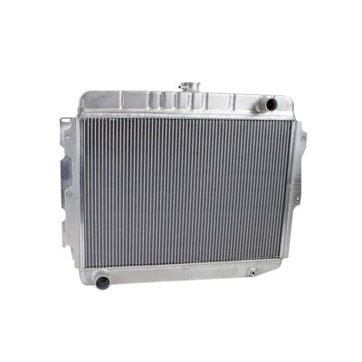

yes the room to fit a clutch fan or ele' fans is what we deal with. so the champion rad is 2 row 1-inch tube diameter rows and the fin design is what makes the transfer of heat to the air flowing thru the radiator.[ and yes the coolant is the carrier of the heat that comes later ] back in the 60's and 70' it was row's now it is fin count and design of the fins that why the new cars and trucks use thin rad's . so it is not always 3 or 4 row that is needed if you are getting a NEW STYLE HEAT TRANSFER UNIT i.e radiator.

The Griffin is a high-dollar, seriously - built unit that came recommended to me by some rather wise old Mopar guys (such as Rick Ehrenberg, for example).
I'd done my time dancing with the usual aluminum jobbers from distant Asian countries....
and yes, that dance included Champion, among others.
The American craftsmanship of the Griffin is impressive - but it comes at a price.

The surface area of the tubes and the design of the tubes varies greatly based on the core and tube thickness. Two one inch rows has a much greater surface area than 3 5/8" rows. Also, the gaps in between the two rows creates double the turbulence of a 2 row that only has one gap. Turbulence slows the air flow. All of these factors plus the ones you mention affect the fans ability to pull air through the the radiator.
