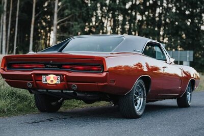

Did I read in post #7 that you have a Chevy LS series engine in the car? Please let that be a typo....
If so, WTF is happening nowadays?
Beautiful car though.
