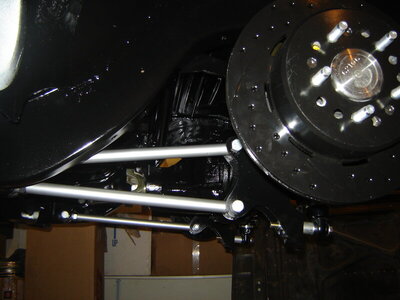

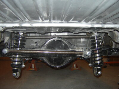

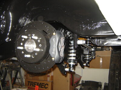

Parallel 4 link works really well. Not really anyone doing a kit anymore. This is a weld in kit by Martz chassis. They don't do them anymore unless you send them your car. Bummer too because the kit was only 1600.00 with qa1 shocks.
