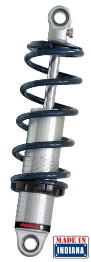

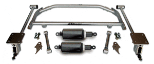

RideTech rear suspension w/coil-over
or Air - Shockwave (airbag over-shock)
is the choice for a bunch of Pro-Touring or even resto-mod guys
many swear by them, good ride & exceptional handling
mostly bolt-in kits
there's welding the upper bars tabs to the top of the housing
these are like $1300-$1400, without the Shocks
shockwave kit, with the Shockwave airbag shocks
here's their coil-overs, can be used instead

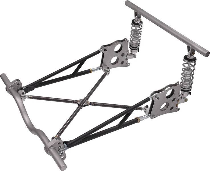

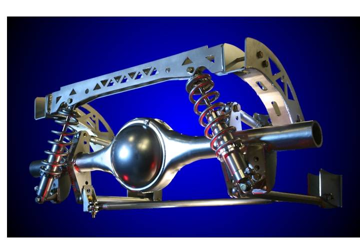

A real parallel 4 link
really has the most adjustments (real fast racecars use them too)
for the street a softer end links/heims with poly or rubber bushings
(bushings vs spherical Heim joints) will not be so ridged
need a Panhard, watts-linkage or a diagonal bar between the bottom bars
to keep the rear centered
can use several styles of shocks, most common is coil-over or a Shockwave
you can get spring rates in so many different combos,
to fit your driving style or needs
most are a shorter travel suspension than a Leafspring style shock
but unless you are 4-wheeling, it can be made to work well on the street
depending on ride height & your driving style

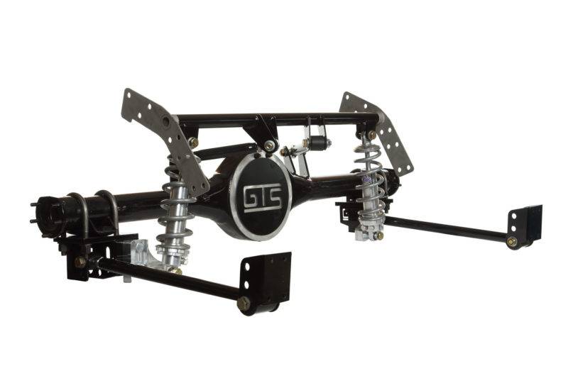

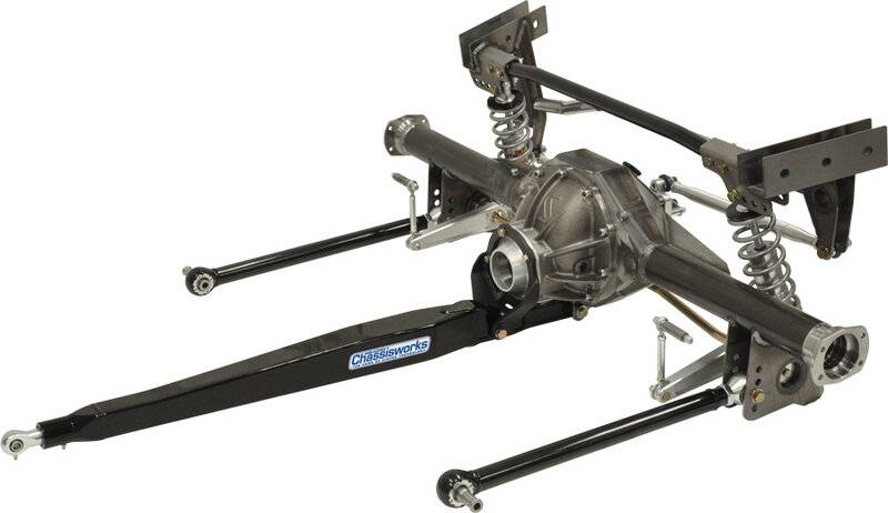

this is an Art Morrison (Probably Camaro/Nova just for reference)
another generic 4 link for reference I think it's a Competition Engineering
partially why the 4 link or triangulated 4 Bar
handles so much better
control rise height much easier, almost infinite adjustments
some think the ride is too harsh, or too hard to dial in
BUT in reality, you can change spring rates easily
you can even get progressive (coil) spring rates too,
shocks are a huge deal in the combo

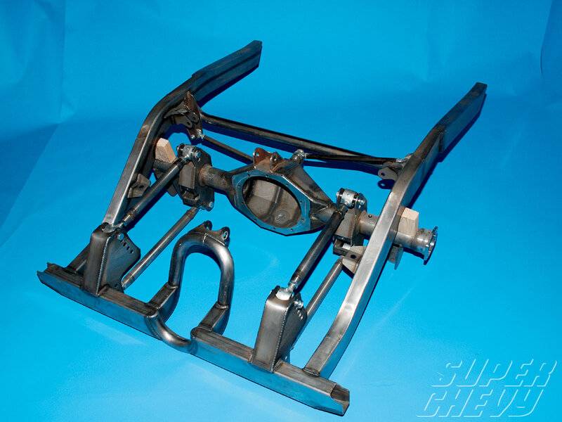

this is a generic short/long bar 4 link
Chris Alston (probably for a Camaro/Nova for referense)
Also uneven triangulated shorty 4 link, but some really like it

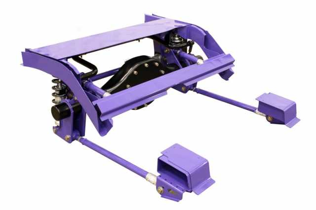

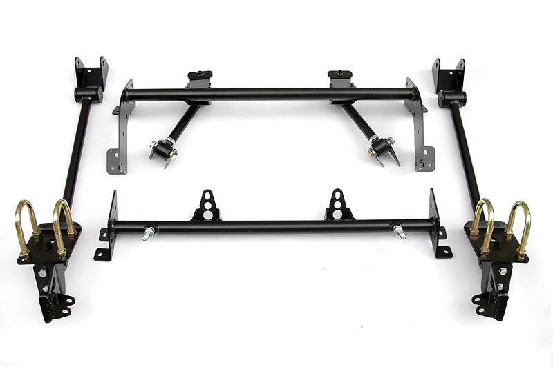

ladder bar & a coil-over can work on the street
like the Street Lynx or
the short top & long bottom bars, 4 link
like the MagnumForce style 4-link/Pro-Link
or like the triangulated short/long bars
Gerst 4 link below, some people love them, even some racers

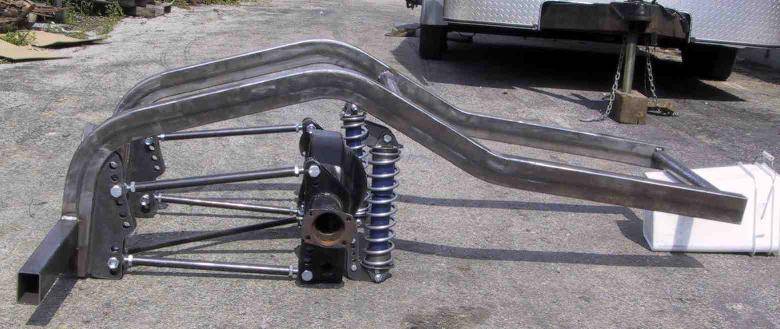

then there's a Torque Arm style
really I've only seen them made for GM stuff, it works really well
could adapt it to a MoPar pretty easily if you have fab skills
