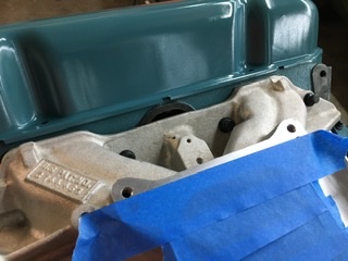

While I’m asking stupid questions, the current valley pan I have doesn’t completely block the crossover passage (see pic). Is that a issue?
That is fine. The stock intake does not cover that area either.

Fel-Pro 1214 has the exhaust crossover blocked and fits the "B" engine 361-383-400
Fel-Pro 1215 has the exhaust crossover blocked and fits the "RB" engine 413-426W-440
