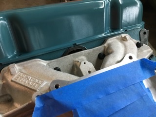

I have a 383 that the heads have not been milled on. I tried to install a new torker 383 intake manifold with no luck. At first I had a gasket between valley pan and block, gasket between valley pan and intake. I could not get the intake bolted on! I currently have the intake bolted on the engine, but I had to remove the gasket from between intake and valley pan. So currently I have A gasket between valley pan and block, but no gasket between intake and valley pan. Will it leak with this configuration? I know, I’m a idiot! Lol! I have read of people using valley pan with no gaskets at all, that’s the only reason I’m considering it. Thanks for reading this mess!

Do not use the gaskets. Put RTV directly on the steel valley pan (both sides).
No gasket is required. A thin layer of rtv black around each port and across the front. Put a dab in the corners where the sides tip upwards.if the heads weren't milled the holes should line up. I dry fit first.

Years ago we tried the bathtub pan with gaskets on both sides and had a very hard time. Some kits offered the paper gaskets in different thicknesses. I would get some Copper spray a gasket and coat the port areas. The front and rear rails just use RTV sealant. I also put a light coat of RTV between the valley corners and the intake bolt hole.
I've only used the valley pan with no gaskets and Gasgacinch around the ports and front and rear. Never had any issues.
Valley pan only. No gasket, rtv around ports, front and back and at corners. ruffcut
I appreciate all the replies. I dry fit the intake and it fit ok. Fit ok with just the valley pan. Was hard to get on with one set of gaskets and valley pan, impossible with both sets of gaskets and valley pan. I guess I will order a new valley pan and start over.
While I’m asking stupid questions, the current valley pan I have doesn’t completely block the crossover passage (see pic). Is that a issue?
That is fine. The stock intake does not cover that area either.
Oh, I've been down this road before...... Forget about the paper gaskets. Some kits do come with 4 paper gaskets, but they've never fit on any motor I've run. From "what I understand", they were originally used on aluminum 440 six pack engines, so I must "assume" the intakes were milled a little more than the cast iron ones. R413 said he can fit one paper gasket in (like you've got). They won't "hurt", but in my experience they don't fit and aren't needed.
