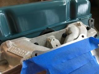

I appreciate all the replies. I dry fit the intake and it fit ok. Fit ok with just the valley pan. Was hard to get on with one set of gaskets and valley pan, impossible with both sets of gaskets and valley pan. I guess I will order a new valley pan and start over.

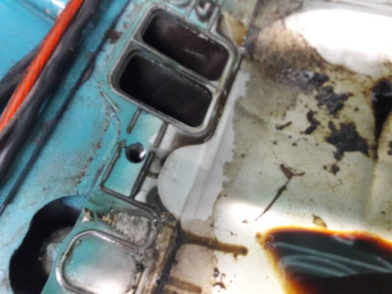

While I’m asking stupid questions, the current valley pan I have doesn’t completely block the crossover passage (see pic). Is that a issue?

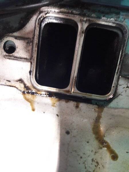

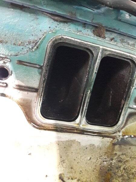

So what was the final consensus here? Both paper gaskets, one paper gasket, or no gasket? My car is sucking oil on the right bank and has no paper gaskets. Edlebrock aluminum intake. I ordered this for delivery tomorrow
How thick is the cross over shim? That will affect sealing.
Mike
The valley pan already has the blockoff stamped into it, there is no shim. Use pan only. Use Indian head. Seal the intake bolts also. No leaks.

Glad the valley pan only works for you guys. I decided to follow the Edlebrock Performer intake instructions which is a paper gasket on the head plus valley pan. It's back together, but need time to start it up and check out what I've got.
