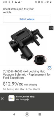

When I was putting my Charger together I didn't want all of those hoses going through the firewall so I used solenoid actuated vacuum valves. Ford used them to actuate their 4WD, readily available just about anywhere.
Interesting concept, sounds like a worthwhile thing to do. If, possible, please provide a list of the solenoid valves you used, a possible source for them, and a schematic diagram of how the valves are connected, both vacuum snd electrically. I may want to connect my N96 this way.
BOB RENTON
BOB RENTON
My application may differ because in my case it was for opening the headlight doors. In my case the high and low beam wires were used to trigger relays both for the headlight relays and the solenoids, since both high and low beam activate the solenoids I had to use diodes to prevent backfeeding one to the other. Since they require vacuum to open and to close I used two vacuum solenoids, one wired to the normally open contacts and the other to the normally closed contacts on the relay which are only powered with the key on.
