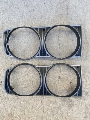

I reconditioned mine a few years ago. I used Mother’s Back to Black and then used a silver paint pen from Hobby Lobby. Here they are side by side. One before and one after.

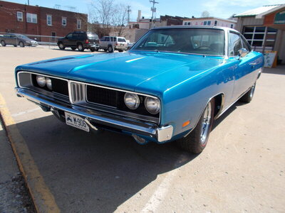

Headlight bezels or no headlight bezels is probably a touchy subject - I think this handsome devil looks just fine without them:
Well the back was painted black, then like factory, I painted the whole front silver, then masked off the silver to paint the black. I used good painters tape, took a long time to get the curves and still had problems. They must have used a production mask, I'd bet money on it.
View attachment 1116273 View attachment 1116274
That handsome devil is painted the wrong Silver. Charger Grilles were a dark silver. Trim blends in with this Silver, a big resto no no.
That was researched and changed from the dark silver.
I just went downstairs and looked at two untouched, unrestored 69 Charger front grills. One is dark and the other is light. I remember an "expert" telling me a 69 Charger couldn't have a pearl vinyl top...ooops, wrong, they can.
Another expert told me that the tail panels are supposed to be painted with organisol. I've talked to people who do restoration paint and they have seen a lot of original 69 Chargers and have never seen it. I've looked at all of mine and none of them have that paint there either.
I prefer the lighter silver because it helps reflect light in to the grill space. The trim contrasts by texture more than color. This car also has the light silver, back to original and looks great with B5 Blue.
But I'm no expert.

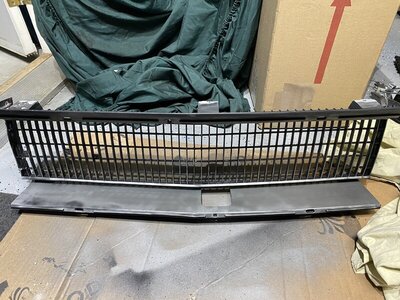

I just did mine used Sem trim black
& Sem titanium silver ,with Sem adhesion
Promoter & heat gun , going to touch up a bit , did the grill as well.used a soda blaster
to etch out the old paint

Hi I used SEM Trim Black 39143 & SEM Titanium Silver & SEM Adhesion Promoter for prep I used a soda media blaster I got off Amazon, built a card board box on top of 4’ table with a plexiglass 3’x2’ see through window for blasting soda works best
as it’s water soluble just rinse off the parts , dried them completely, any flaws or chips in the plastic I used jb weld for plastics waited 24 hrs and sanded with 400 & 800 grit wet sand paper each piece was then heated up with a heat gun ,then applied the Sem adhesion promoter follow directions on the spray can , heating between Sprays , then blacked out parts that require black, taped off the silver areas using different widths of masking tape , let dry 24 hrs , then taped off black areas , then more adhesion promoter & heat gun then sprayed Sem Silver titanium go lightly with sprays then get heavy then heat again between sprays , it stops running if you spray to much, let dry 24hrs, to get the silver stripes back to original I used a square piece of foam , pinched it off with a paper spring clip so just about an 1/8” of it was protruding at the end
You can see the pictures in this chat ,borrowed from the Mrs 2 pie plates with tinfoil protection, I sprayed adhesion promoter in one plate , the other silver paint
and gently brushed on promoter down each grill slat , then heat , then silver down each slat and more heat , go lightly don’t worry if you don’t get the paint on immediately, I gave mine 3 coats take your time have a beer and think how beautiful it will turn out , Good luck , I hope I helped you out Cheers !!!
