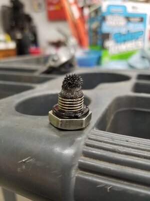

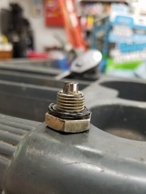

Here is my last experience. Bought 3 "suposedly" nos rods. Bought from a guy who only sells old stuff, so I really have no reason to doubt him. This is with about 1200 miles of use.

Thanks. That's another thing to think about...they might be designed and treated for "strength" but not necessarily for the grinding-type of wear they get subjected to.

Does this get down to what the cams are made of these days if even NOS rods are being eaten?
Possibly...if not from the material then just the the not-so-good QC we've seen, maybe they're not paying as much attention and grinding the eccentric lobe put-of-spec.
It's quite disturbing to me (on this subject at least) that even NOS isn't a "safe haven"...
because there's plenty of anecdotal evidence that the originals lasted a very long time.
That tells me the cams aren't what they used to be and apparently are quite a bit more abrasive, for whatever
reason.
reason.
Yes...since that pushrod end is riding on a lobe, like a lifter does, it could be ground into oblivion if that eccentric lobe wasn't finished properly....I'd say the odds aren't terrible that that's the cause of at least some of the failures.
