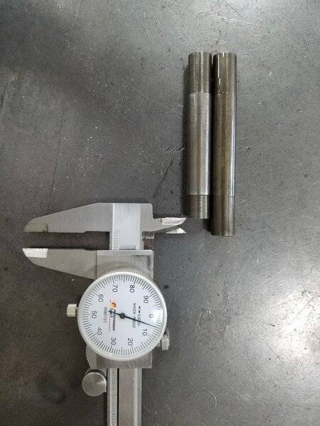

Here is my last experience. Bought 3 "suposedly" nos rods. Bought from a guy who only sells old stuff, so I really have no reason to doubt him. This is with about 1200 miles of use.
View attachment 1171526 View attachment 1171527 View attachment 1171528
Yeah, I know that story unfortunately:(...hopefully that OEM rod will live to a ripe old age for you!
What's curious to me is, with that much material ground off, was there still enough preload/contact to keep the pump 'pumping'?

I was at the end stages of tuning my new motor/carb. I was starting to get a bit more valve train noise and on my last couple of wot's, I noticed it didn't have as much power as it used to. Ran fine everywhere else though. That's when I pulled the pump and found the worn rod. Put in the one you sent me and ran it just a few miles before the valve train noise started getting worse. Pulled the valve covers and found issues that I posted another thread about. Still waiting on new lifters from Johnson, so unfortunately the motor is still sitting apart.
On another note, I still have the other 2 "nos" rods. If anyone has a way to test their hardness, I will drop them in the mail. I'm curious as to what they really are.
