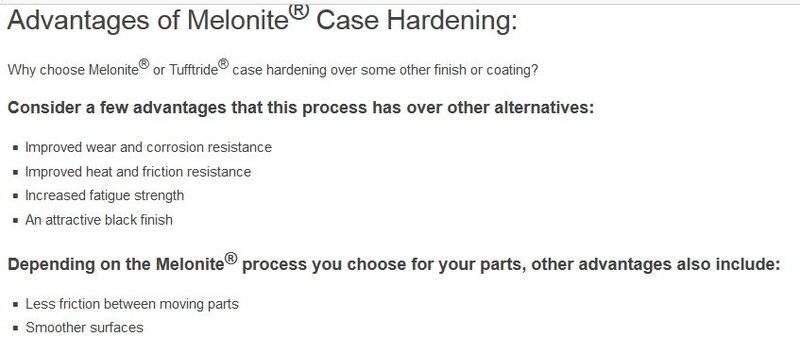

Think if you did Melonite treatment to then they'd last, Cost to much for one part but a dozen or so?
Wasn't nothing wrong with the factory pushrods. Some are lasting well over 100k. Has to be the aftermarket Chinese, recycled junk!
That or a surface nitride would have to help, you'd think?...But that assumes the pushrod manufacturing IS the problem (which it probably is...) I was just trying to look at it from a little different angle, to make sure we're treating the root cause and not just the symptom..

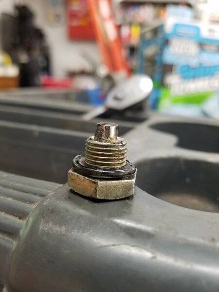

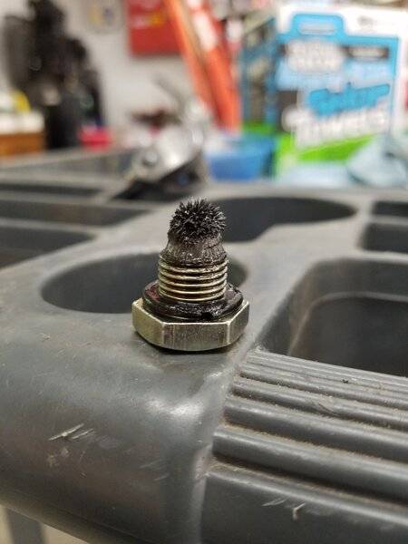

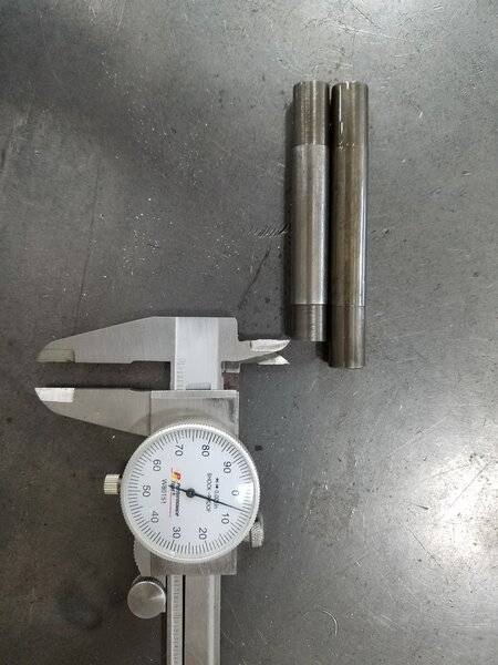

Here is my last experience. Bought 3 "suposedly" nos rods. Bought from a guy who only sells old stuff, so I really have no reason to doubt him. This is with about 1200 miles of use.
