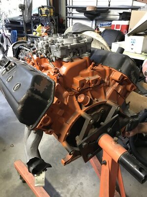

I know that the top tube runs from the choke to the top of the exhaust header.
I want to know how to connect the second line that runs from the bottom of the exhaust header up to the carburetor. I have a photo (green circle) showing the top of the second tube that has a black rubber hose showing. Where does that hose connect to? I have attached a photo of the back of my engine.
I found the attached photo online but I can't find anything in my service manual for the connection. Any help is appreciated.
There's a small nipple on the bottom of the air cleaner pan it connects to. Sort of a pain to deal with. It draws filtered air from air cleaner through tube in exhaust manifold and then up to the choke housing.
Thank you, I will take a look for that nipple.
By the way, I removed the plugs (see photo) you see on the rear of my intake manifold, which is the way the engine was when I purchased the car. Evidently the last owner plugged and removed the choke assembly. I guess with the hot weather in South Forida, he figured he didn't need it. I am restoring to original specs which is why I am buying the parts and re-attaching to my engine. Thanks for the two replys, very helpful and now I can complete the installtion.
