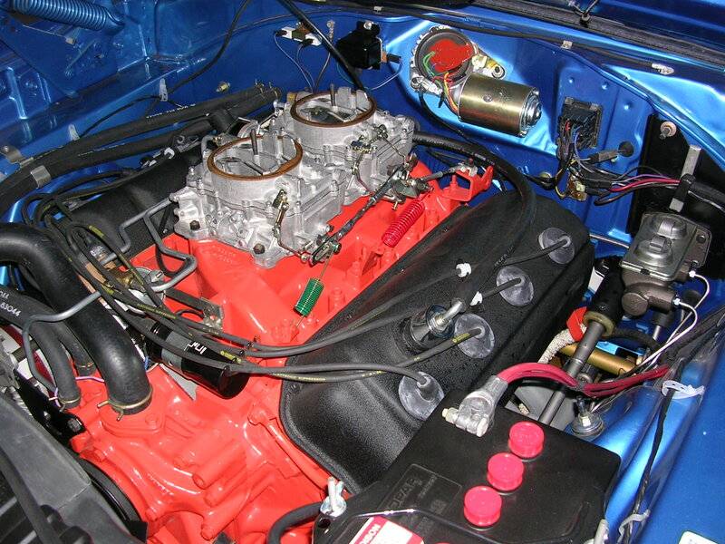

I thought all Hemi cars came with a 3-speed wiper motor, but your car has a 2-speed one, so what gives? Can you install the air cleaner?

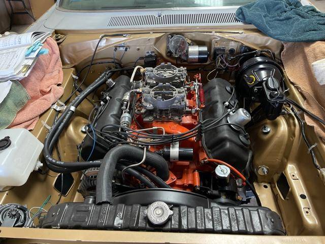

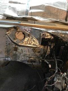

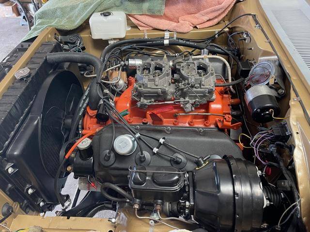

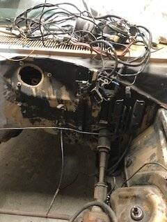

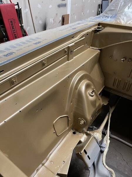

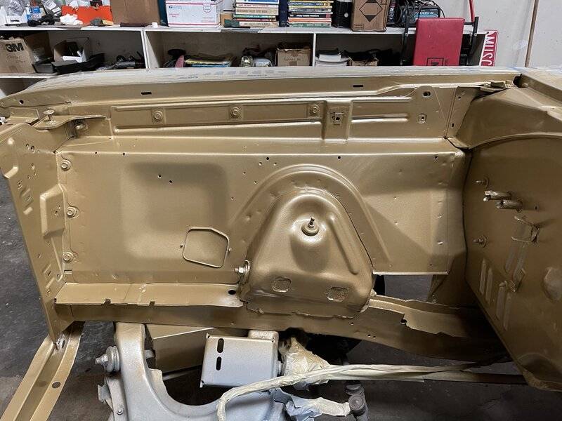

YyThat's interesting point on the heat tubes. I also removed my battery tray before we put the engine back in and I had my new starter on the engine. Prior to this, I had restored my engine bay by removing everything, removing all the grease and grime of 50 years, primed and painted it. Then I rewired, installed new brake booster, master, all the small components, restored the wiper motor. Hopefully, I will get it back on the road by the end of the year, thanks to All Forum members help.

Great work on your engine bay! One small thing: the small removable ports on the side of the shock towers are supposed to be black, not body acolor.That's interesting point on the heat tubes. I also removed my battery tray before we put the engine back in and I had my new starter on the engine. Prior to this, I had restored my engine bay by removing everything, removing all the grease and grime of 50 years, primed and painted it. Then I rewired, installed new brake booster, master, all the small components, restored the wiper motor. Hopefully, I will get it back on the road by the end of the year, thanks to All Forum members help.

I have removed and re-painted those black, just haven't posted any photos yet. Thanks.Yy
The 3 speed wiper for 1968 and older cars is different from the 69 and up motors. The wiper motor on this 66 car is correct.I thought all Hemi cars came with a 3-speed wiper motor, but your car has a 2-speed one, so what gives? Can you install the air cleaner?
