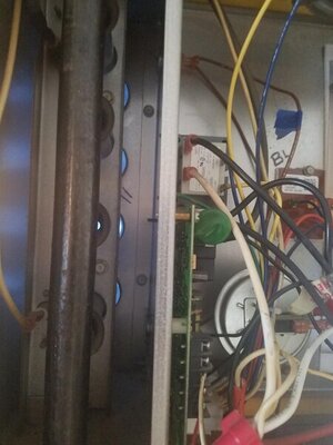

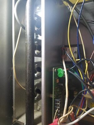

I have a Lennox garage heater ceiling mounted. Looking for any tips on removing the flame sensor rod on this lf24 unit. I've replaced the hi-limit and rollout switches, replaced the blower and motor. All rather easy as there's access to the screws and bolts, EXCEPT the sensor. For some reason, the screws for it are behind possibly requiring some heady work to get it out. Every time I stare at it, not sure what needs to be removed to get it out without disassembling a load of stuff. Like to avoid removing stuff that may not need removing. In the photo the sensor rod is far left, white wire, left of the gas pipe. I've searched the web for any chats on this, so far no luck. The light on the CB blinks 4 times and pauses indicating one of the switches; but after replacing them, could be the rod is carboned up needing cleaning or replacement. Thanks

Looks to me that vertical wall between the heat tubes on the left and the components to the right, the component bracket is screwed into the vertical wall. Looks like 2 screws, and it will come out??
You need to remove retainer strip above burners then remove burners
you can clean in place or remove strip that hold burners to get to screws
clean with 0000 steel wool or fine scotch brite GENTLY or if unavailable you can use clean inside of match book with no ink works as well

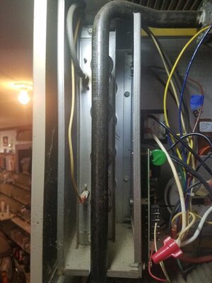

Thanks much for your tips. Here's a couple of better photos. The vertical bracketing has a screw top & bottom, this would seem to allow the 'start' of removal. Then there are two screws along (on the right) holding the bracket that connects with the burner ports, they are rings on this one-piece bracket that surround the ports coming off the gas pipe...they 'appear' to be able to slide off those ports, assuming they're a slight press-on fit. Suppose, could be once doing this, the works can be turned enough to remove it or just to access the screw heads to pull sensor out. Weird why da hey they put the screws in from behind considering what needs doing to take the sensor out! Ya know, a part that should be checked and cleaned every few years...in my case it's been there for 20.

Have worked with furnaces over the years; but know my limitations. Installed it making up the pipeline from the basement to garage wiring it in 20 years ago. On the CB there is little light indicating system functions based on how bulb is flashing. I found a 4-flash then pause; on the chart this says high-limit or rollout switch. Tap on the furnace it starts up and works fine for a while, until it happens again. Installed new limit switches (inexpensive and easy to do). Worked fine for a few months, then same chit again. Did the blower/motor while working on it as it sounded like a bearing was going…some play on spindle. Further pondering seemed to point to a more root cause, one being the flame sensor that can carbon up or deteriorate causing this. Since its never been out figured a good thing to check. But, as posted this thing is a hassle to remove. So after some web surfing finding nothing and the manual saying nada, thought well there might be a member or two who has one having done the job, or maybe a furnace tech to share advice.

From your description, there may be an issue with that flame sensor. If the fan is running, it is unlikely a high limit As a licensed HVAC guy, I can tell you that we rarely find 2 units the same and usually it becomes a small project to replace parts on some units. You can test the flame switch with an ohm meter to test for continuity (power off). After that, as others have suggested you'll need to methodically pull things apart until you can remove those screws. You can try cleaning the sensor with some very fine sandpaper, but I'd replace it at this point.

Did you replace the fan inducer? There should be a proving switch somewhere near that inducer blower. Some call it a sail switch. That switch proves that fan is running and allows the gas valve/ rollout to start. I’ve seen debris/ nests/ leaves, etc. get in there and prevent that switch from opening and closing.
Yours looks to at the other end of the vacuum hose coming off the blower motor.
