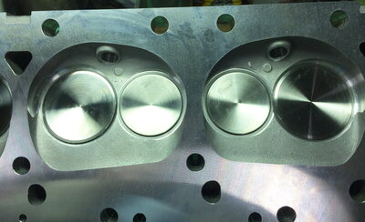

I think he has to understand this is not a race head! More of a stock replacement. I would agree the seats do need attention. I spent $450 to have the seats and chambers corrected. This picture was taken just before the chamber was cc'd. Top cut overlapped exhaust seat and chamber unshrouded behind the valves.
Eric is a race head porter, the intent was to review it as such. The review was spot on and nothing we haven’t heard a thousand times on this site. He isn’t a Chevy guy, he’s a head porter and can’t control what comes through his shop.
