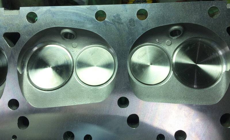

I think he has to understand this is not a race head! More of a stock replacement. I would agree the seats do need attention. I spent $450 to have the seats and chambers corrected. This picture was taken just before the chamber was cc'd. Top cut overlapped exhaust seat and chamber unshrouded behind the valves.

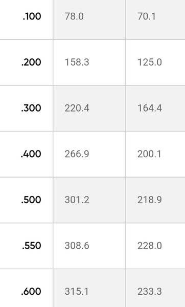

Here is my 440 Source Stealth heads, ported by Muscle Motors. 1st column is lift, 2nd is intake and 3rd is exhaust. They only measured to 0.600 lift.

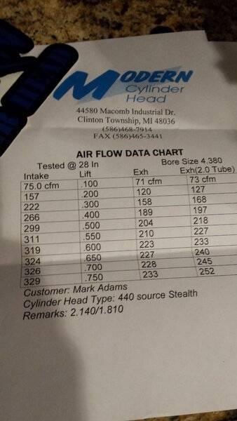

My Stealth CNC heads done by Modern

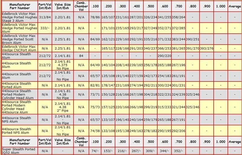

The current Stealth cnc offering are no longer done at MCH....... so it stands to reason they may not flow the same as the ones that were done there.
That being said, Eric’s numbers seem uncharacteristicly low.
Any of the CNC’d Ede RPM BBM heads...... and all the copies....... should be a solid 300cfm + to justify running them through the machine.
I’ve had some std port cnc’d Stealths done by MCH on my bench...... they flowed 315, with very good low/mid-lift flow as well.
With the valve seats redone and a bowl blend the unported ones flow right about 280 on my bench....... which is 15-20 better than ootb.

Do they still do this service? I would like to send my OTTB Stealth heads to them instead of buying the CNC version from 440 Source
There number is on the flow sheet in my post. I would give them a call.
