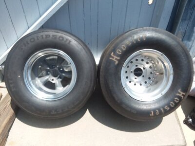

I've got a pair of the 315 pro's, but I haven't tried them yet, the car isn't ready. I also have some giant Hoosier bias QTP's, but I don't know which works better. Both have dot, but the mickeys say in big letters, not for highway use. The qtp are street legal.

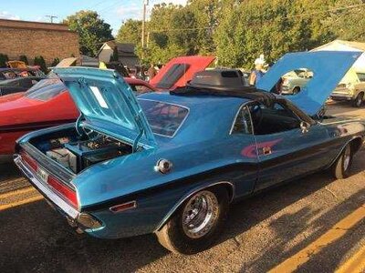

I run M/T Drag Radial Pro's on the street and strip. No issues at all and don't even wear out as fast as you would think. To say they are sticky and hook is an understatement. My brother was following behind me to a cruise night one night and when I change lanes in front of him he said I peeled the white line right up off the road when getting over a lane. Partial of the line was still on the tire when we got to the cruise night.
