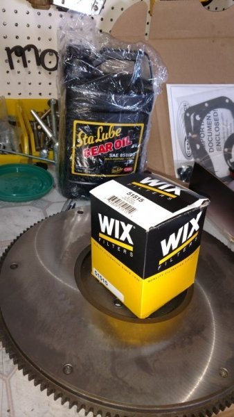

Fred has a 440 with a factory heavy as hell 11" flywheel, as provided by Brewers a few years ago:

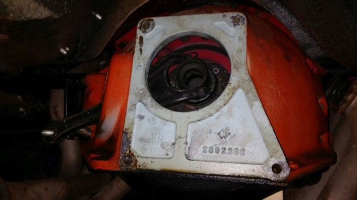

The bellhousing is a factory cast iron hoarker as well:
2892262 part number....
