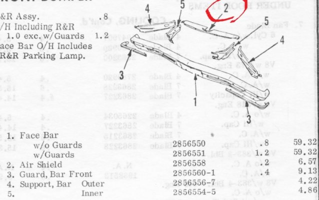

Turns out, it's the cars' front radiator air shield....which apparently was part of the repaint of Fred
before the drunken wall bonking episode. PO just took it off, mangled as it was and tossed it in
the trunk....
1968-1969 2856558 Plymouth b-body "air shield" is shown in the factory parts manual as: air shield.jpg
My question is what else is in that immediate area?
I see where it bolts to the backside of the bumper, but I have no other clues and
it seems to me like there should be something between it and the bottom radiator support?
Does anyone/can anyone post some pics "straight down" behind the grille and in front of
the radiator in their '68-'69 Plymouth B-body please?
THANKS!
Ed
Note the holes in the front edge for the back of the bumper, but a lipped smooth edge towards the radiator
side.... is there something that goes between this and the radiator support?
It doesn't touch, it's close but it doesn't touch... And no seal of any sort... It prevents most of the air that enters the grill cavity from escaping & going under the radiator... Honestly, an air dam from the lower radiator support extending down 2-3" would be more effective, it would allow air to enter below the grill but limit it's ability to pass below the radiator, plus create a low pressure area behind & below the radiator....
Might be serving as a stone shield of some sort also?

No problem. Good luck, if you need any more pictures just let me know. My 68 dropped right in but my 70 was a little tougher for some reason. May have been bumped in the front before I bought it.
I think they refer to that piece as a "gravel guard". Meant to save your radiator more than an air seal.
