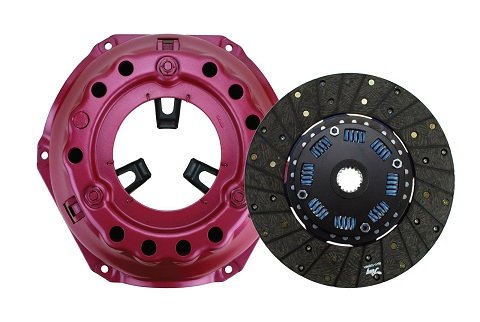

I believe it is… not too sure how to differentiate between the different types but here’s what it looks like. I had a good friend recommend this clutch so that’s how I ended up with it.
That's a "Borg and Beck" pressure plate, requires the over center spring to be on your clutch pedal.
That's a Borg & Beck (3 finger) style, not diaphragm.
You've got the same clutch as I do - and mine does the same thing.
I just stick my toes under the pedal and lift it back up when it does.
I can't believe it's a product of a weak over-center spring - I think it's inherent
to that particular pressure plate.
In fact, I dislike that clutch so much I had Dan Brewer send me another B&B setup to
swap this one out, even though it's only got a couple thousand miles on it.

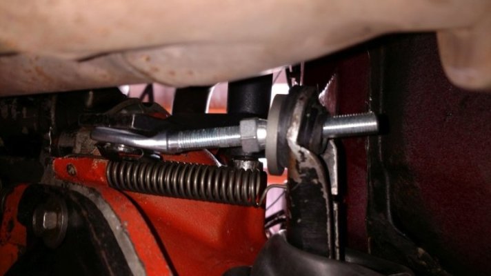

Something is wrong with the OP's set up with that throw out rod threaded out to max length and the pedal still won't come up. Here's the 383 Barracuda with clutch set correctly... showing the thread left out the back. I know the A body uses a different length rod but there should be some threads out the rear to keep the push rod from falling out of the fork.
Here's my Bee set up.. that's using an A body push rod that migrated to the car in '78. Lock clip not yet dedicated to the job.

Check what's under Fred for comparison:
That's a new clutch rod and they come bent like that. Makes for goofy engagement at the fork for sure.
I'm tempted to do some heatin' and bendin' when I redo this clutch to make it all straight and purty
like yours though.
Oh, the clutch in Fred is identical to the OP's:
It's supposed to be their "performance" line...

Post a WTB for an A body throw out rod.. they are longer as show in both the pictures I posted above..
