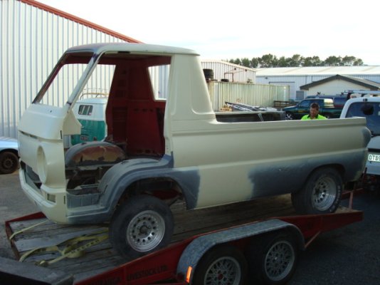

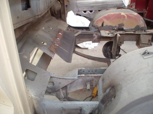

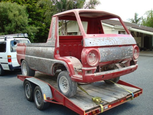

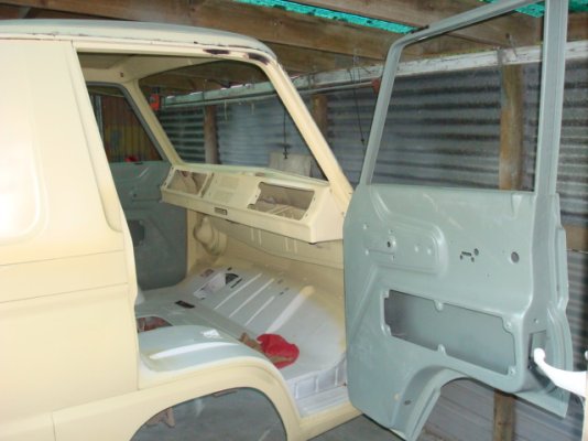

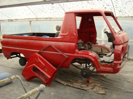

I had my A100 sand-blasted - but not the bigger flat panelwork. Used traditional elbow grease to get that paint off. Sand-blasting is fine when the operator knows what he is doing, and cleaning is not that bad to do when the veehickle is all parted down to a bare shell.
I had the removable panels all dipped - doors, doghouse, lids & battery box, plus radiator shroud etc. Worked out really well....the doors were absolutely mint - almost like NOS panels when I got them back.

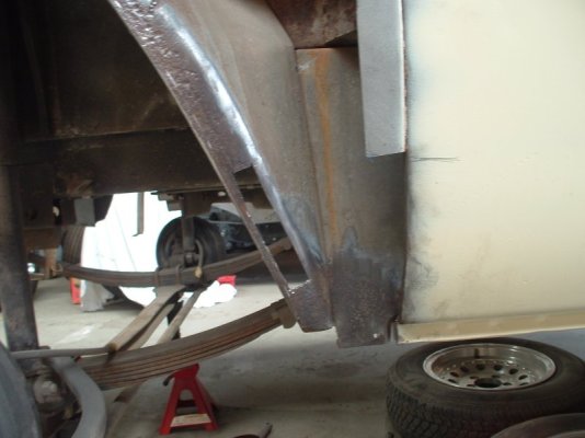

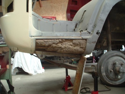

Check out all that Arkansas mud built-up over the decades.....hidden inside the outer panels....
ugh, that cavity is scary. Makes me wonder what my van looks like in there
That front floor was very perforated....all new sheet metal now. Panel guy is a real whizz and made it all look factory with correct swages and edges.
