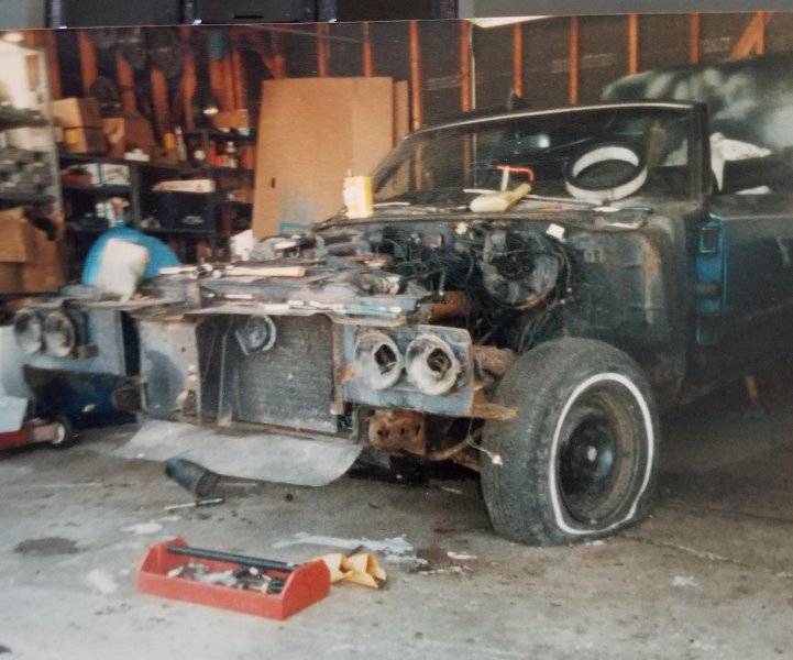

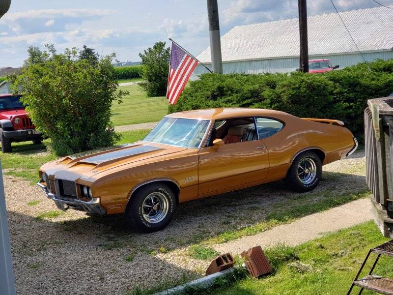

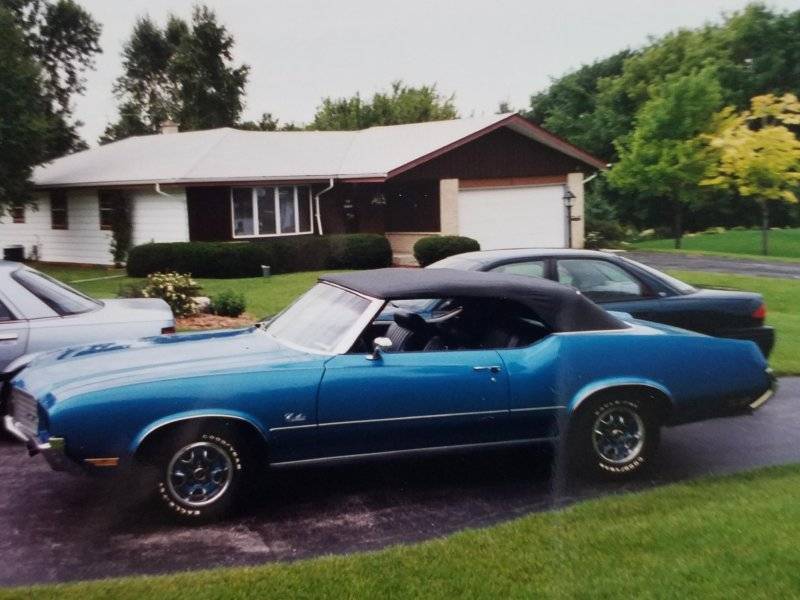

es, nice work. Cutlass is also one of my favorites.
Have my regrets letting it go after ALL the work my departed-talented-dad and I did bringing it back. Dang, it drove so sweet with all new suspension, rebuilt, slightly beefed 350, and some 442 cloning I never finished, well, finding a mopar I just couldn’t pass up. NO way I would have made it w/o my father given what we ran into. The 1st go-around was golden giving me enough to do it another two-times, sadly w/o my dad around any longer, but him giving me enough to continue on, despite some hassles I sure wish I could have called him to chat on.
When I see posts of guys doing a resto with their dads, dang near brings tears to my eyes remembering my dad helping me some 40-years ago. An experience - memories to cherish!
I restored this 68 GS with my Dad, it took us 6 years and was a LOT of work. Having that experience together is very important to me and I will cherish it forever.

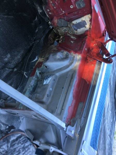

That front floor was very perforated....all new sheet metal now. Panel guy is a real whizz and made it all look factory with correct swages and edges.
Hi Kiwi, can i ask who did panel work?
