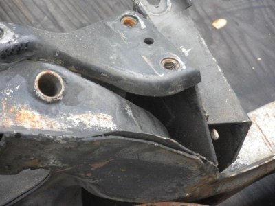

Looking at a bare K member, you can see the unsupported areas that allow that flex to occur:
Looking again at the above photo, you can see the tube that the lower control arm shaft slides through. Often times after years of wear and stress, this area weakens and cracks out.
I welded washers over these holes but made sure that the washers were no thicker than the lip of the tube. This made sure that the LCA didn't get moved rearward at all, preserving caster.
THIS photo shows another area to consider: The strut rod mount. Many A body K members had gussets here, but my '70 K member did not. I used a 1/8" thick washer here. Also notice the welding of the seams. I doubt that seam welding helps much, since mine had the spotwelds pretty close together.
