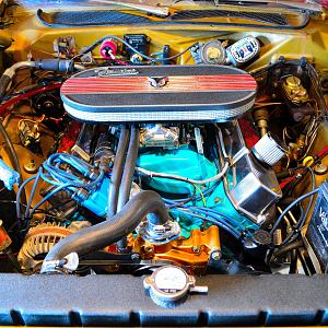

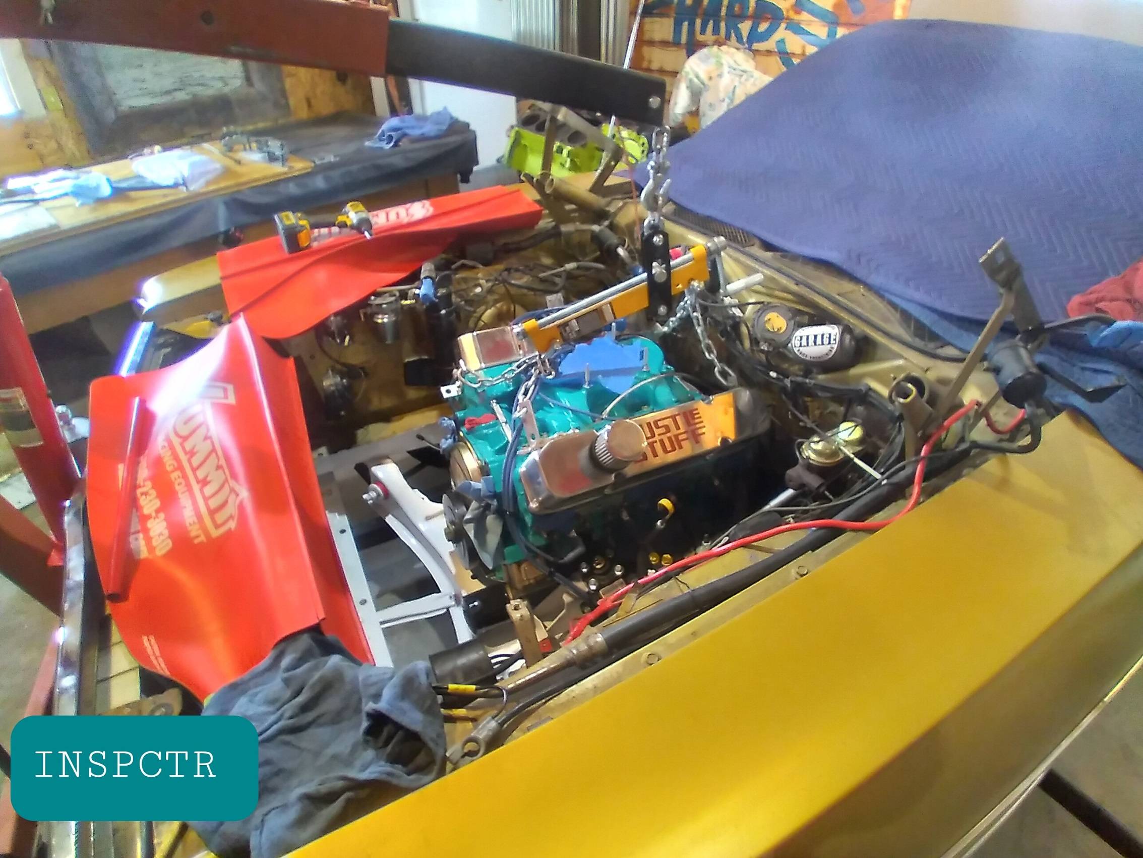

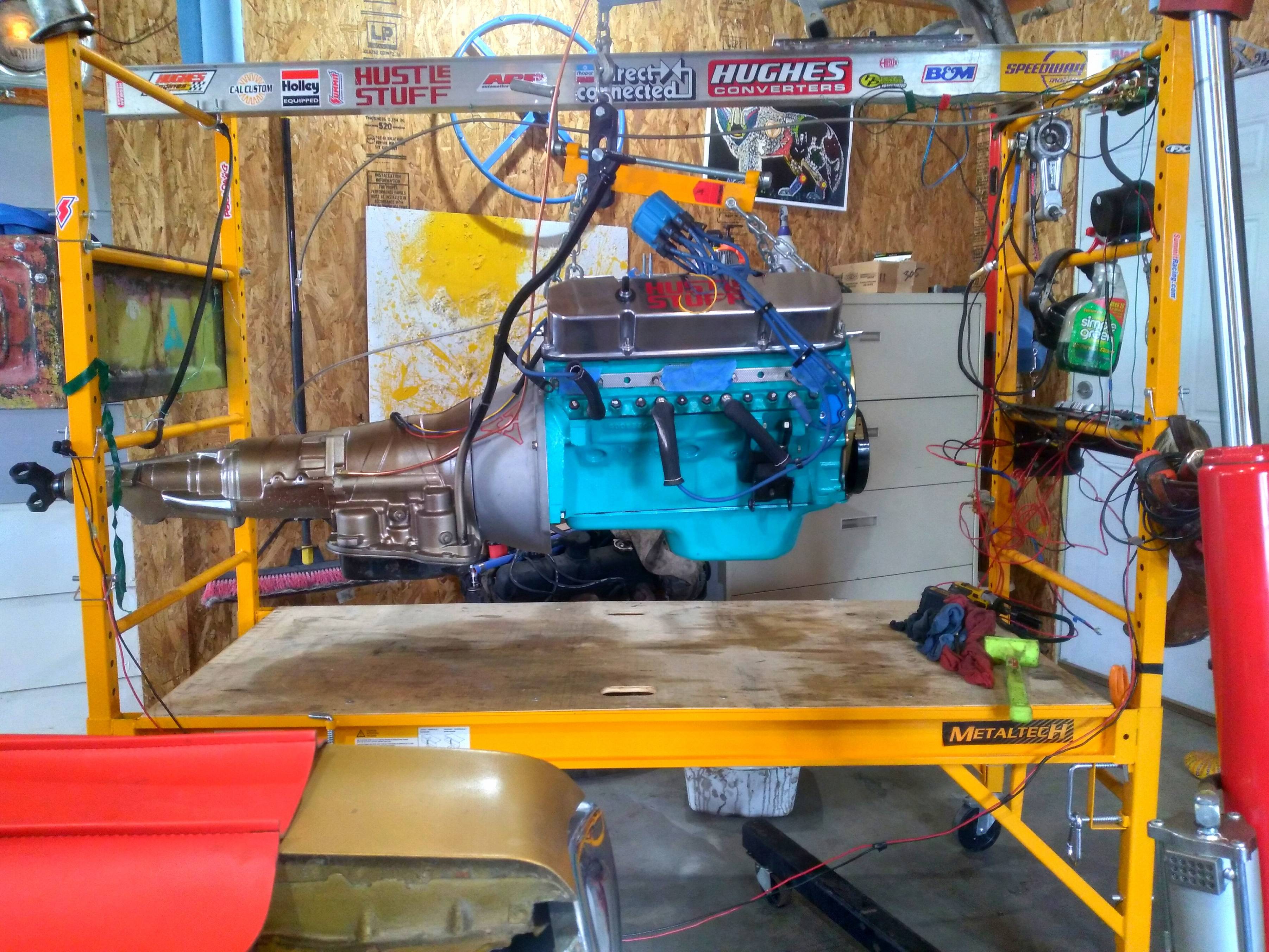

318/904 to 400/518.
About this Mopar:
Fender Edition Coronet BB 400 with a 518 OD Transmission.

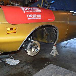

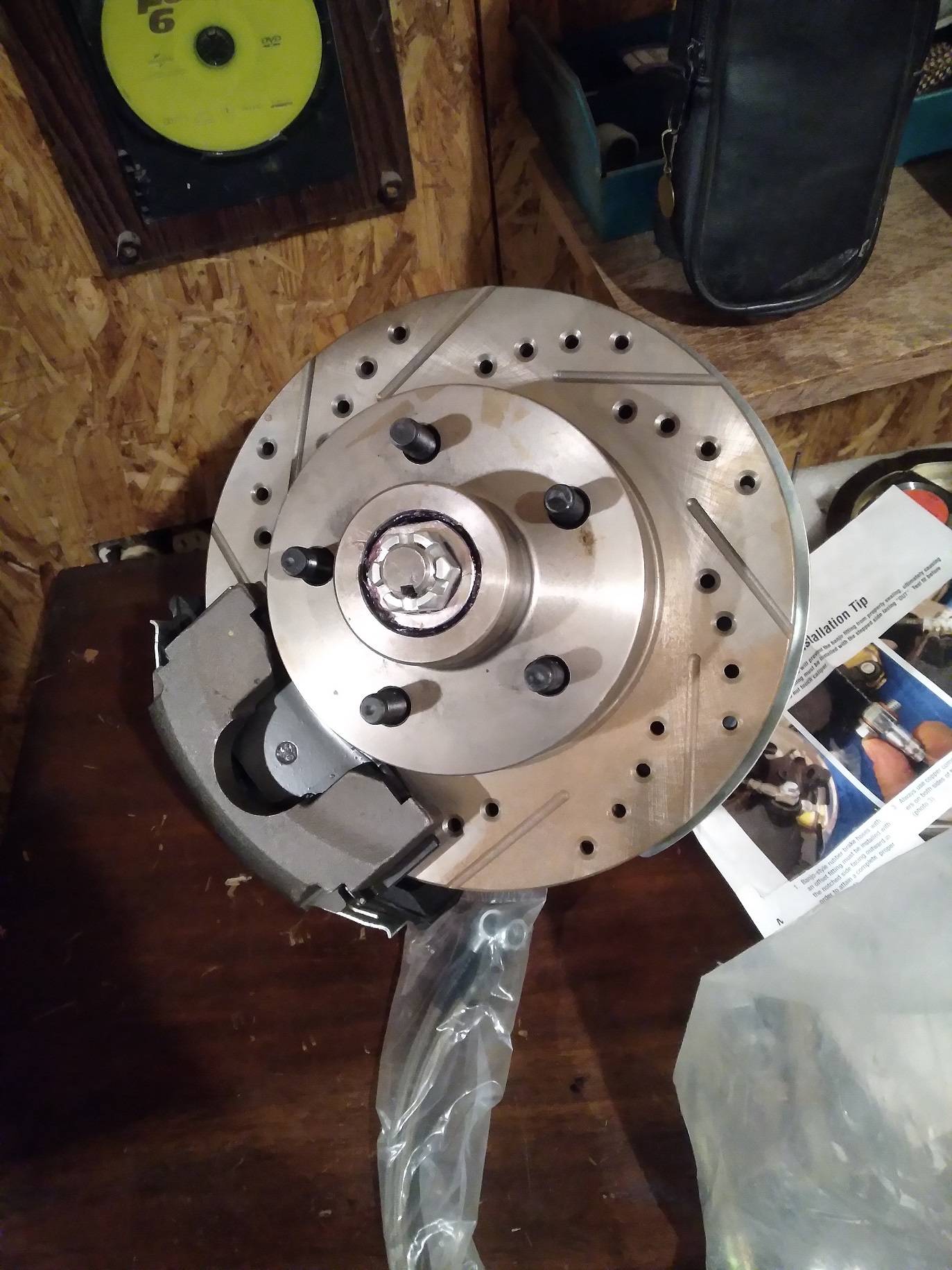

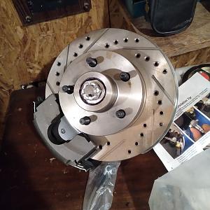

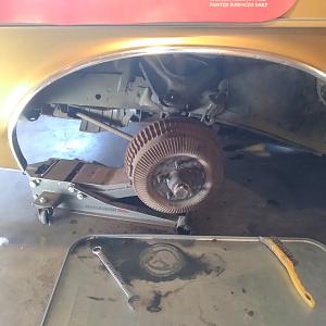

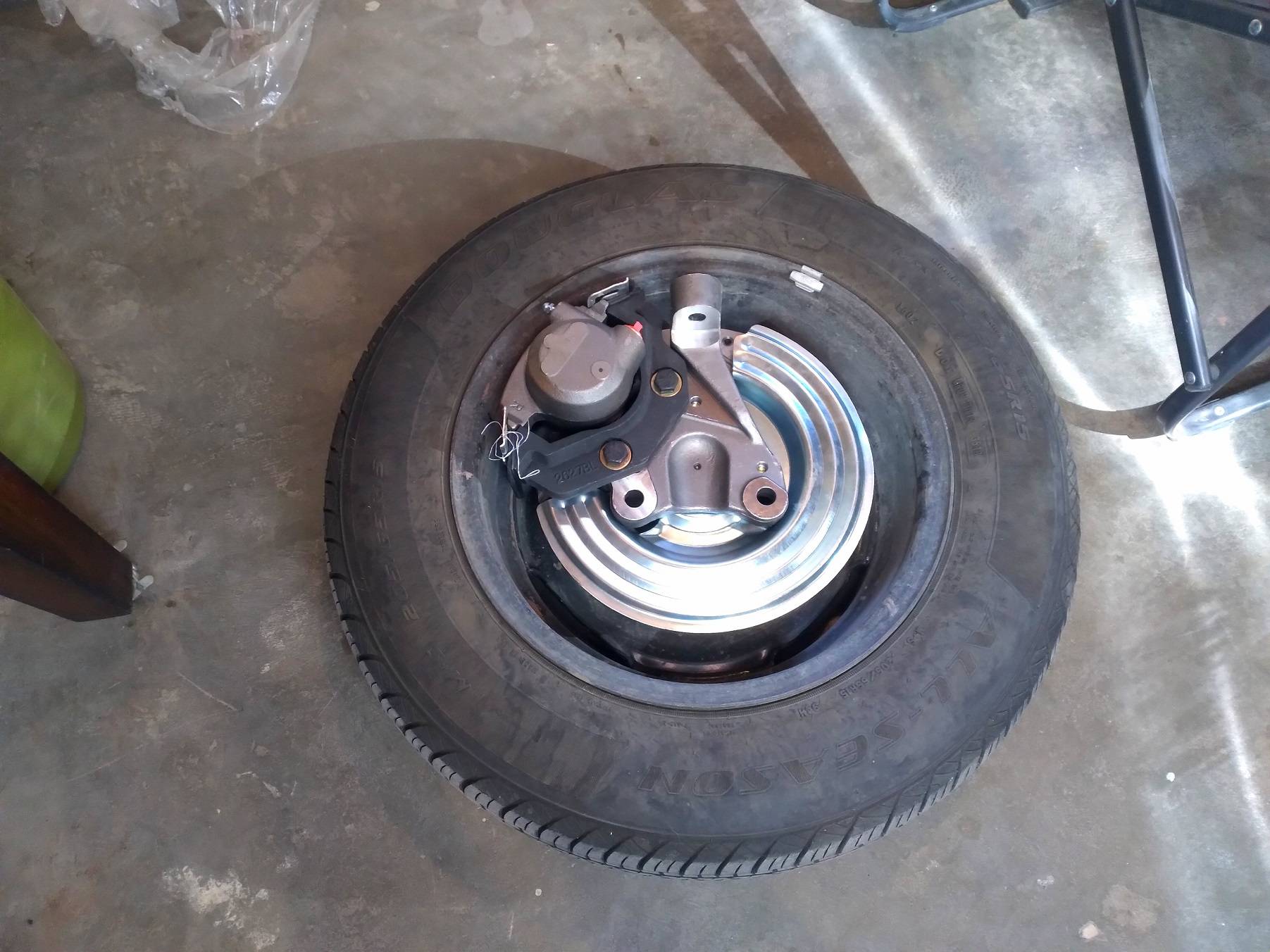

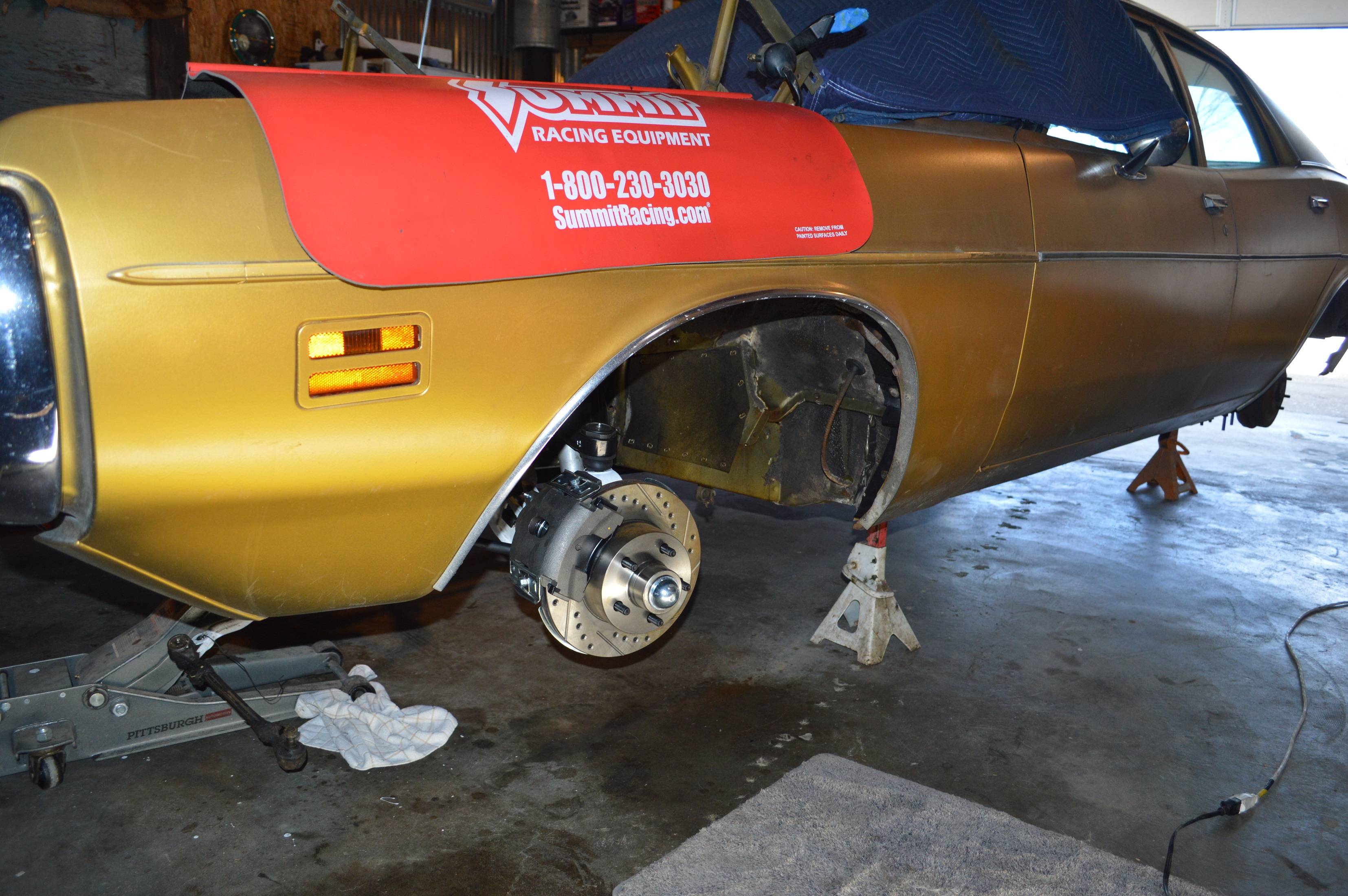

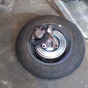

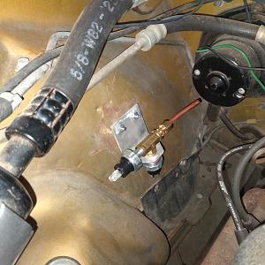

BRAKES

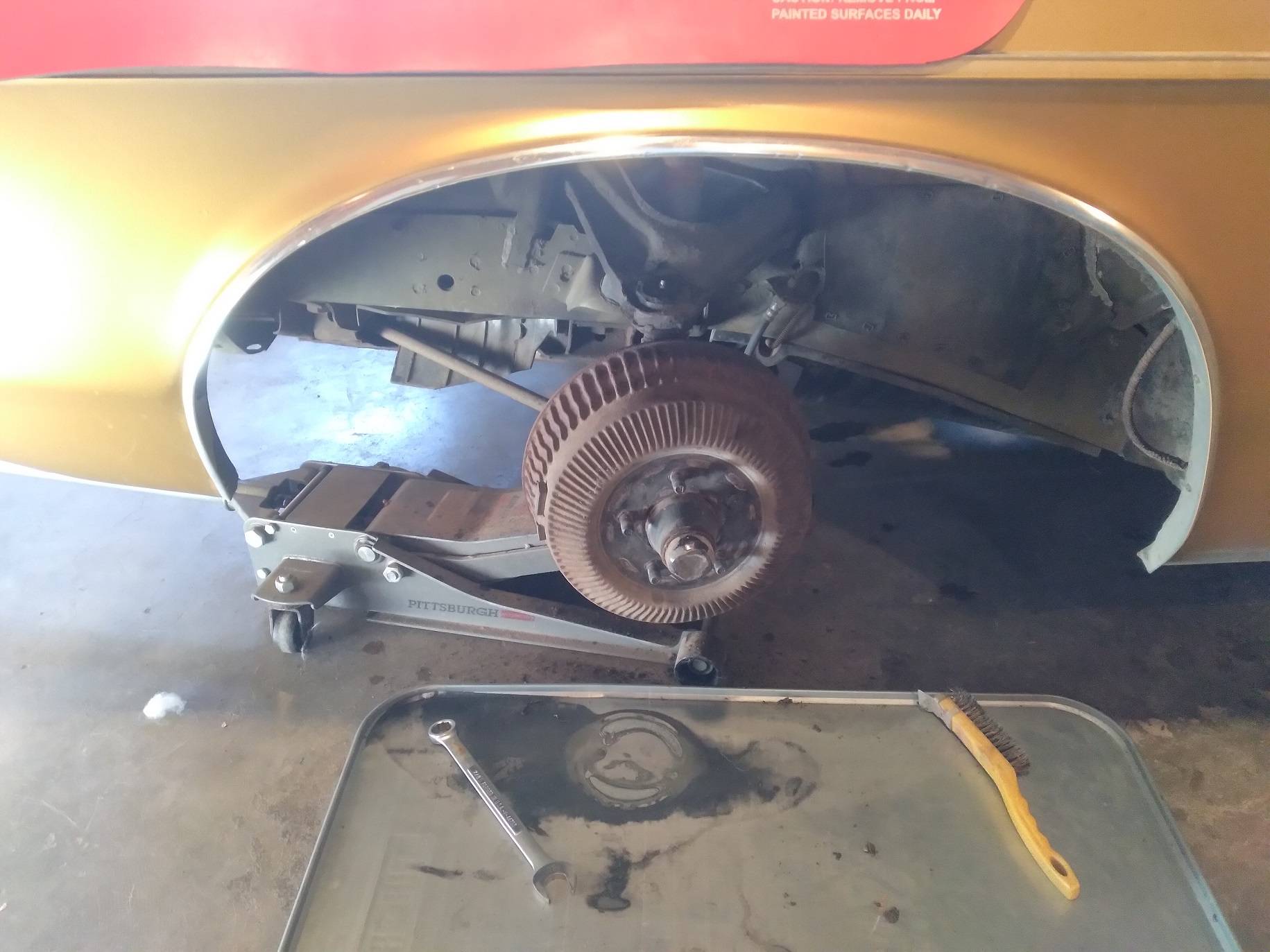

Disc brakes with factory upper a-arm weighted in at 54lbs Purchased from C.C.P.
The Drum Brake and original a arm 56lbs

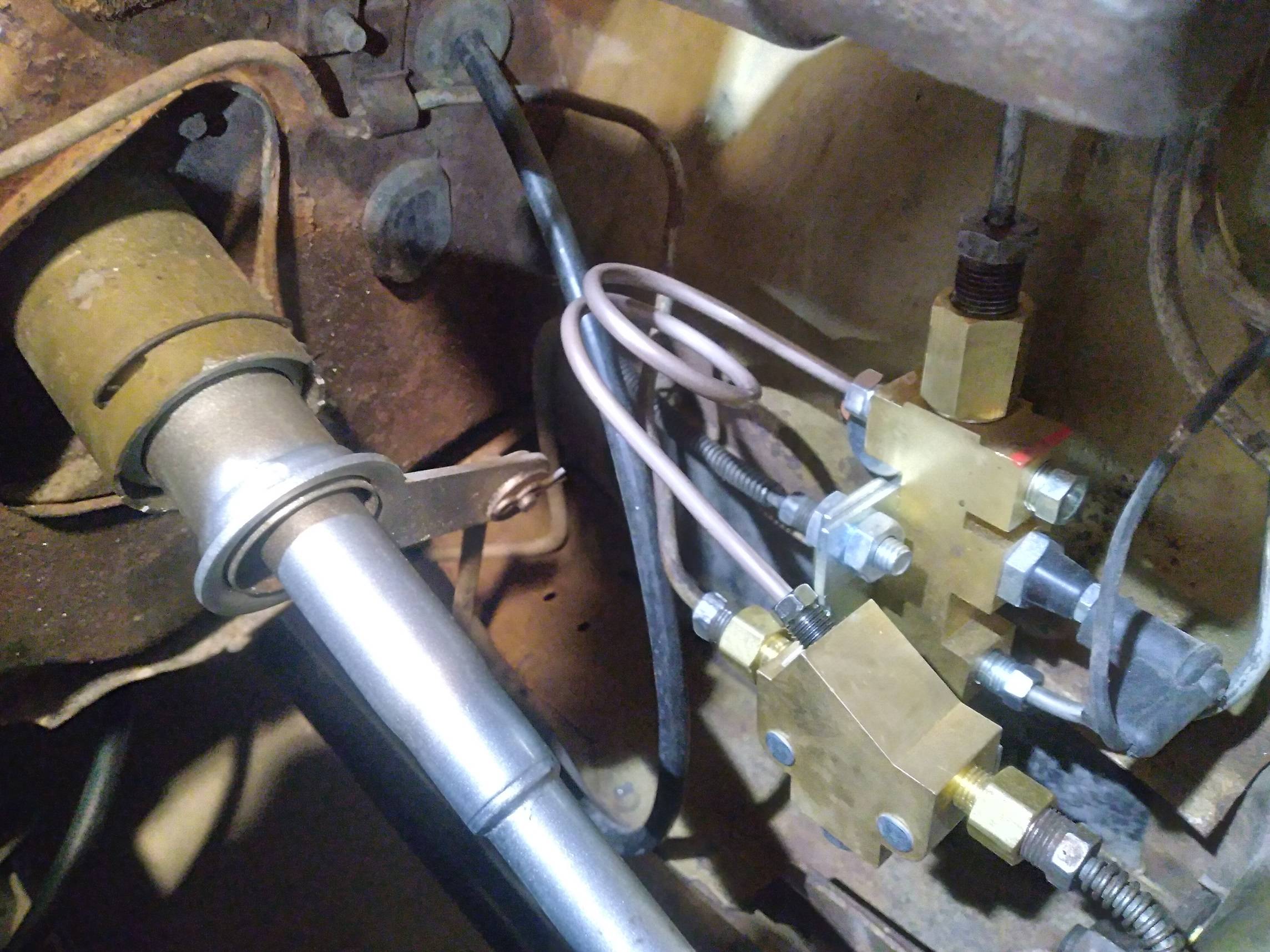

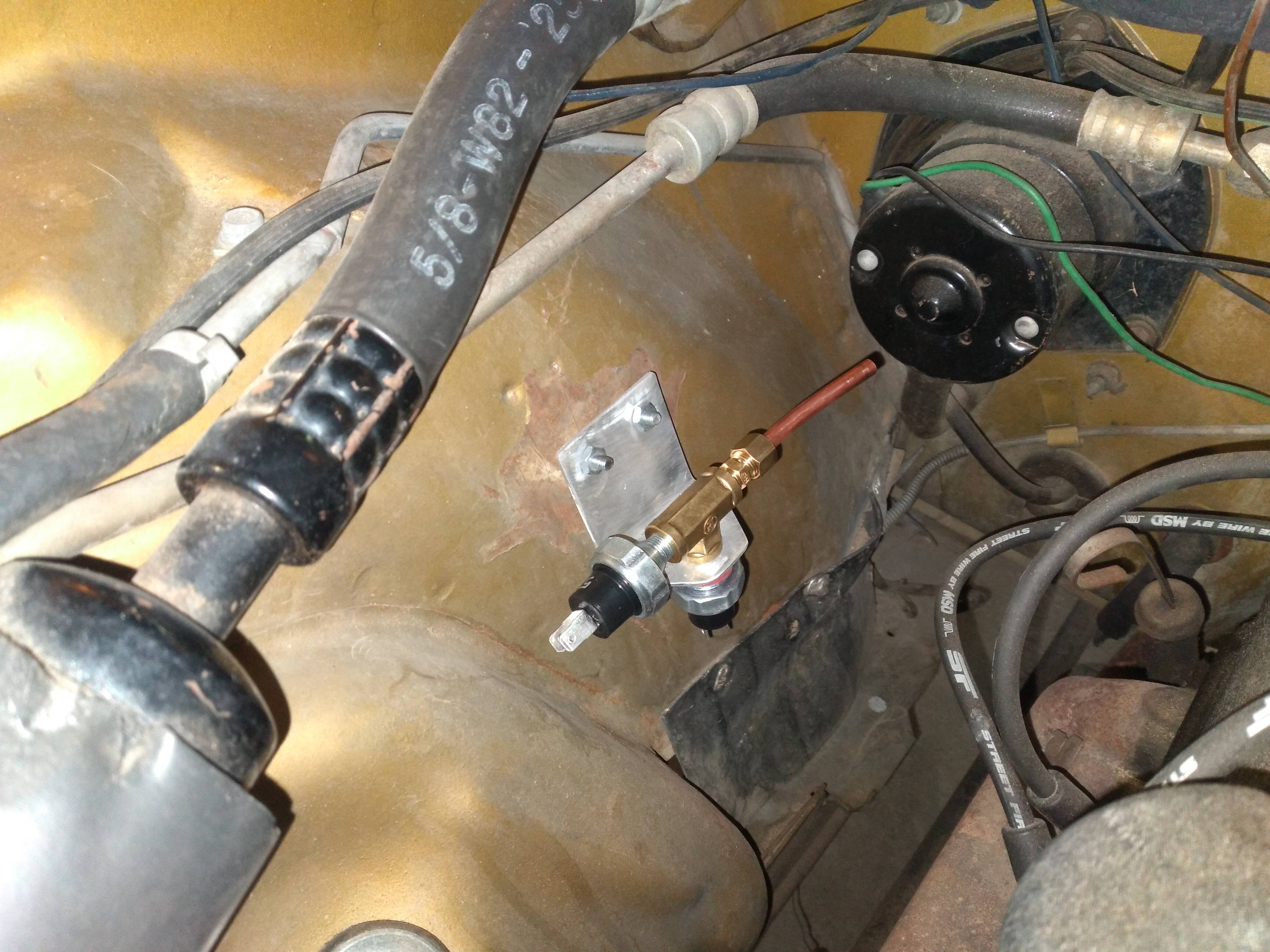

Going to use a factory style distribution valve.
![11 b discs vented slotted.jpg 11 b discs vented slotted.jpg](https://www.forbbodiesonly.com/moparforum/data/attachments/1009/1009187-26bb228455737ecfc16fc01b86c36a33.jpg)
![11 Discs inside 15 inch wheel.jpg 11 Discs inside 15 inch wheel.jpg](https://www.forbbodiesonly.com/moparforum/data/attachments/1009/1009188-08381102530f09d47a630fa0026cbfc2.jpg)

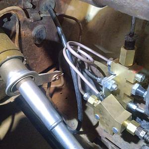

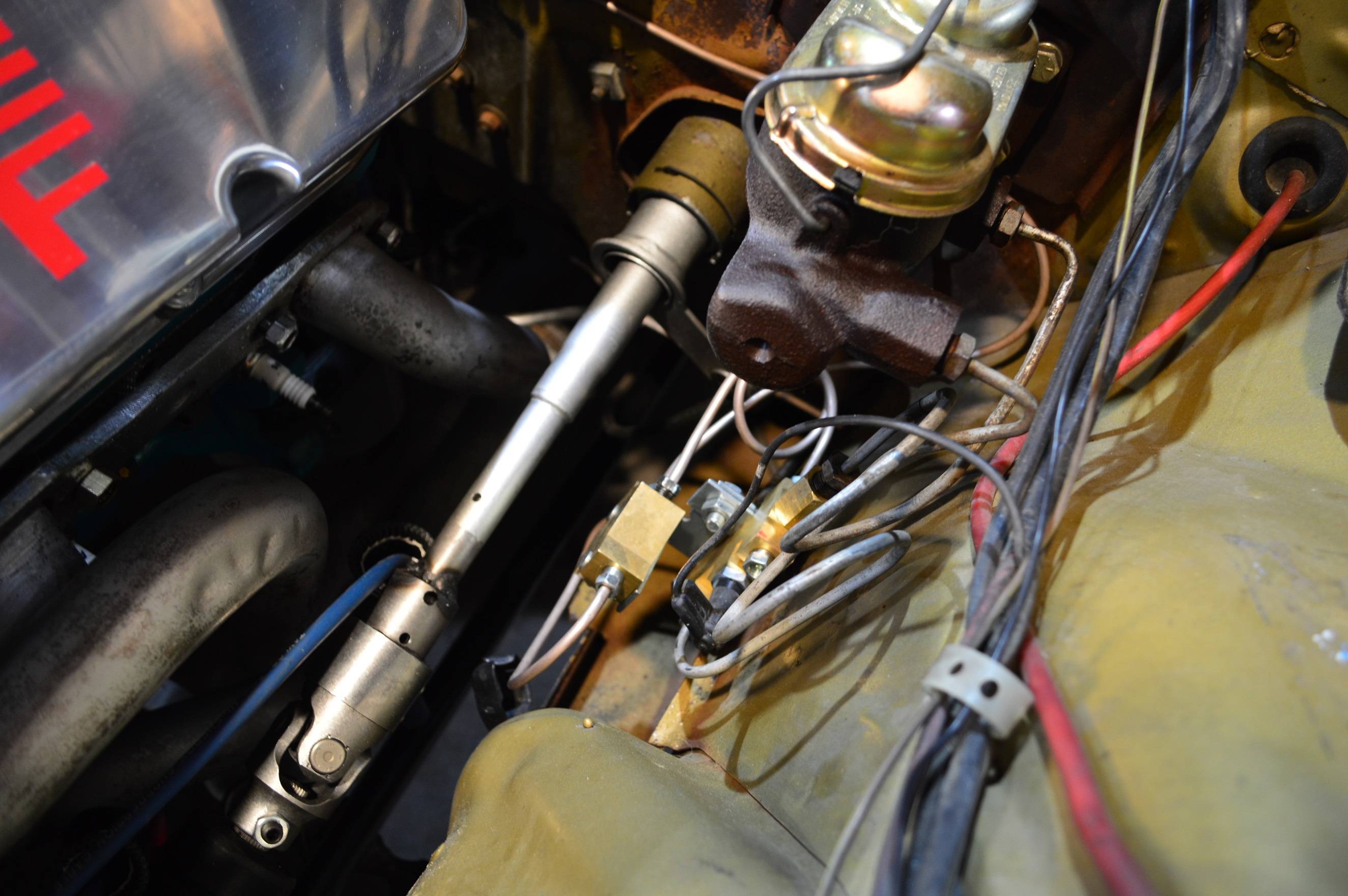

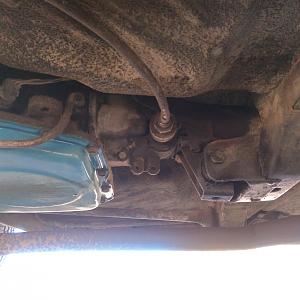

![21 brake dist lines DSC_5906.JPG 21 brake dist lines DSC_5906.JPG](https://www.forbbodiesonly.com/moparforum/data/attachments/1020/1020608-dbefd94b939c736800342cf09db1703f.jpg)
New 3/16" Copper Nickel lines installed up front.
SUSPENSION
Ordered up a new set of Torsion's from PST. Installed
Used the boiling water trick to slide the bar seals on.
Trick is to boil them in water in the microwave together until the water is a rolling boil.

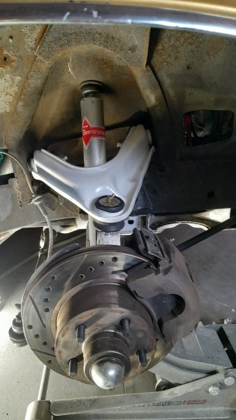

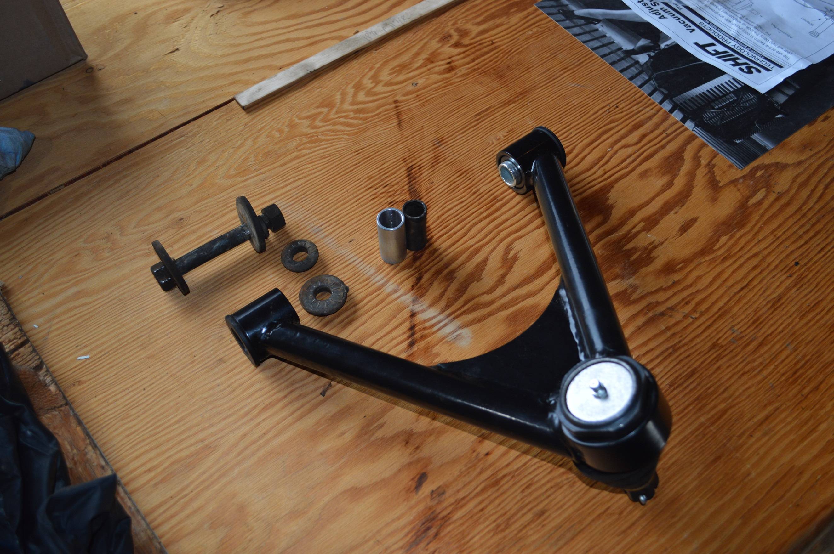

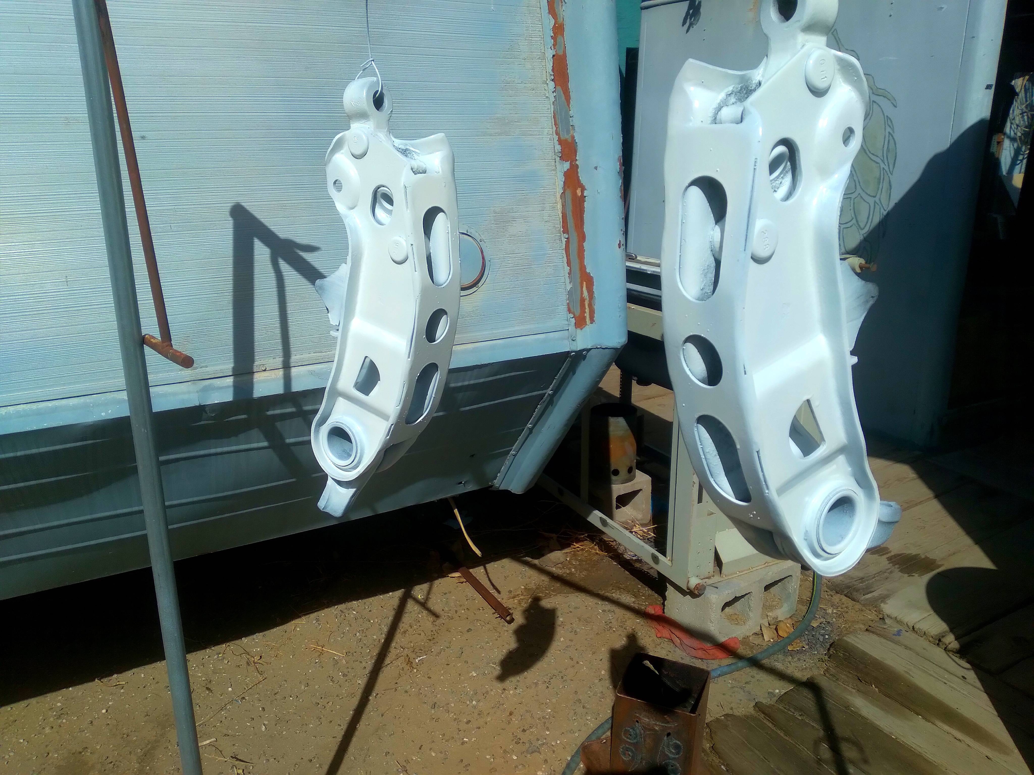

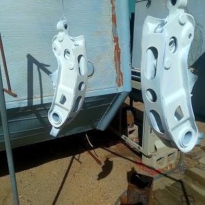

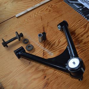

A-Arms from partsgeek for 99bucks. Very nice...But I do need to sleeve the camber bolts to fit the bushings.
The bushings are 5/8" i.d. so prepare to grind down the
originals to slide inside them or buy 13/16 o.d. - 1/2" i.d. - 1 3/4" long bushings.
![11 discs upper a arms.JPG 11 discs upper a arms.JPG](https://www.forbbodiesonly.com/moparforum/data/attachments/1009/1009189-72b0296691fd45c0d20dbe2f8c2ab319.jpg)
THESE A-ARMS ARE ......REALLY HARD TO GET IN SPEC FOR CASTER,,,CAMBER AND THEY RUB ON THE CAMBER BOLT MOUNTS.
PLUS LIKE I SAID THE INSIDE DIAMETERS ARE NOT 1/2. I drove the car anyway for a 1000 miles or so. They are going to bet cut up or tossed.
![20221109_125913.jpg 20221109_125913.jpg](https://www.forbbodiesonly.com/moparforum/data/attachments/1299/1299028-3559606b7ebd2d0696a2cf37cd5a2989.jpg)
I ended up rebuilding the stock components.
![a arms back to stock.jpg a arms back to stock.jpg](https://www.forbbodiesonly.com/moparforum/data/attachments/1299/1299017-d98855596cf5455815a23b6b74342927.jpg)

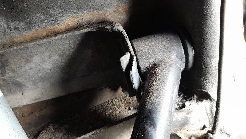

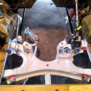

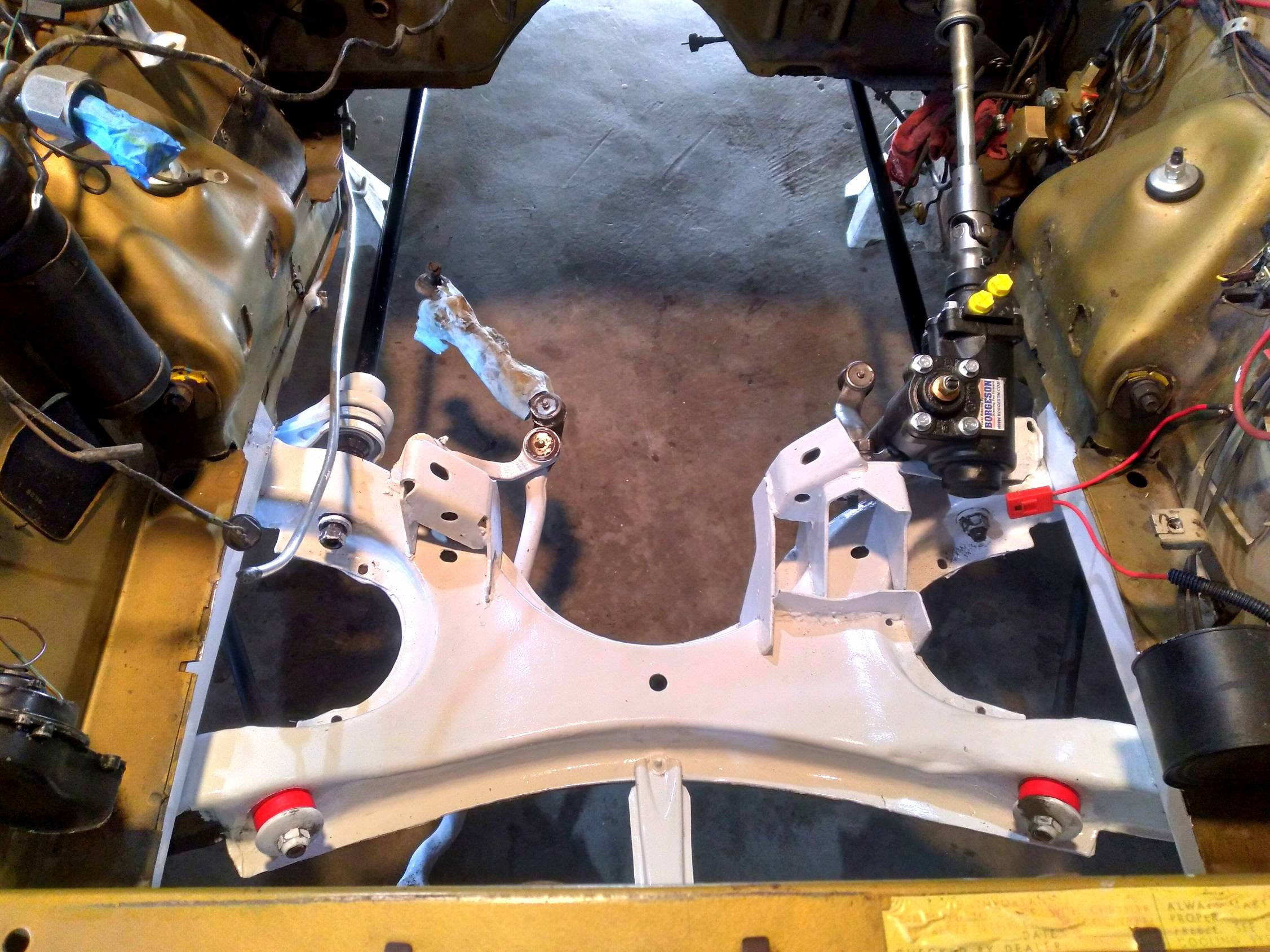

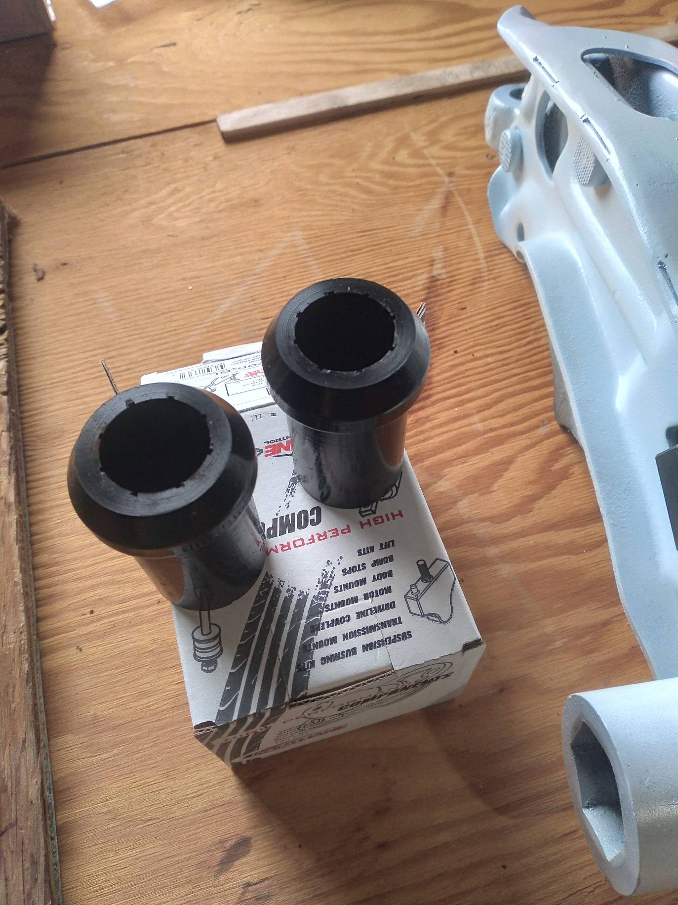

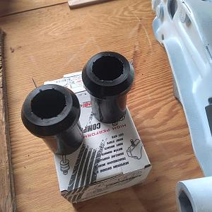

Lower Control arms welded up and getting Poly Bushings.
The steel sleeves in the control arms needed a lot of sanding to get the poly to fit.
![12 sz lower control arms.jpg 12 sz lower control arms.jpg](https://www.forbbodiesonly.com/moparforum/data/attachments/1011/1011158-0baac8a56a09135ab2fc242cc084d1f4.jpg)
![12 lower poly 20210314_111950.jpg 12 lower poly 20210314_111950.jpg](https://www.forbbodiesonly.com/moparforum/data/attachments/1012/1012472-90e995f1cccc25b3fff79cf916158ac6.jpg)

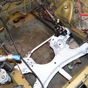

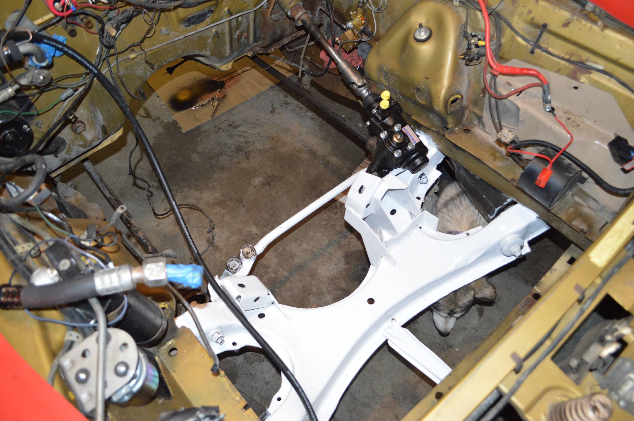

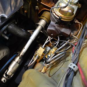

STEERING
Upgrading to the Borgeson Box
Stock Strut Rods with Poly Bushings, Used red so they popped.
![12 u bushings and big bars.jpg 12 u bushings and big bars.jpg](https://www.forbbodiesonly.com/moparforum/data/attachments/1012/1012464-1f4844d521d4c08cf9583ea69e76610e.jpg)

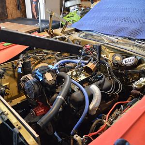

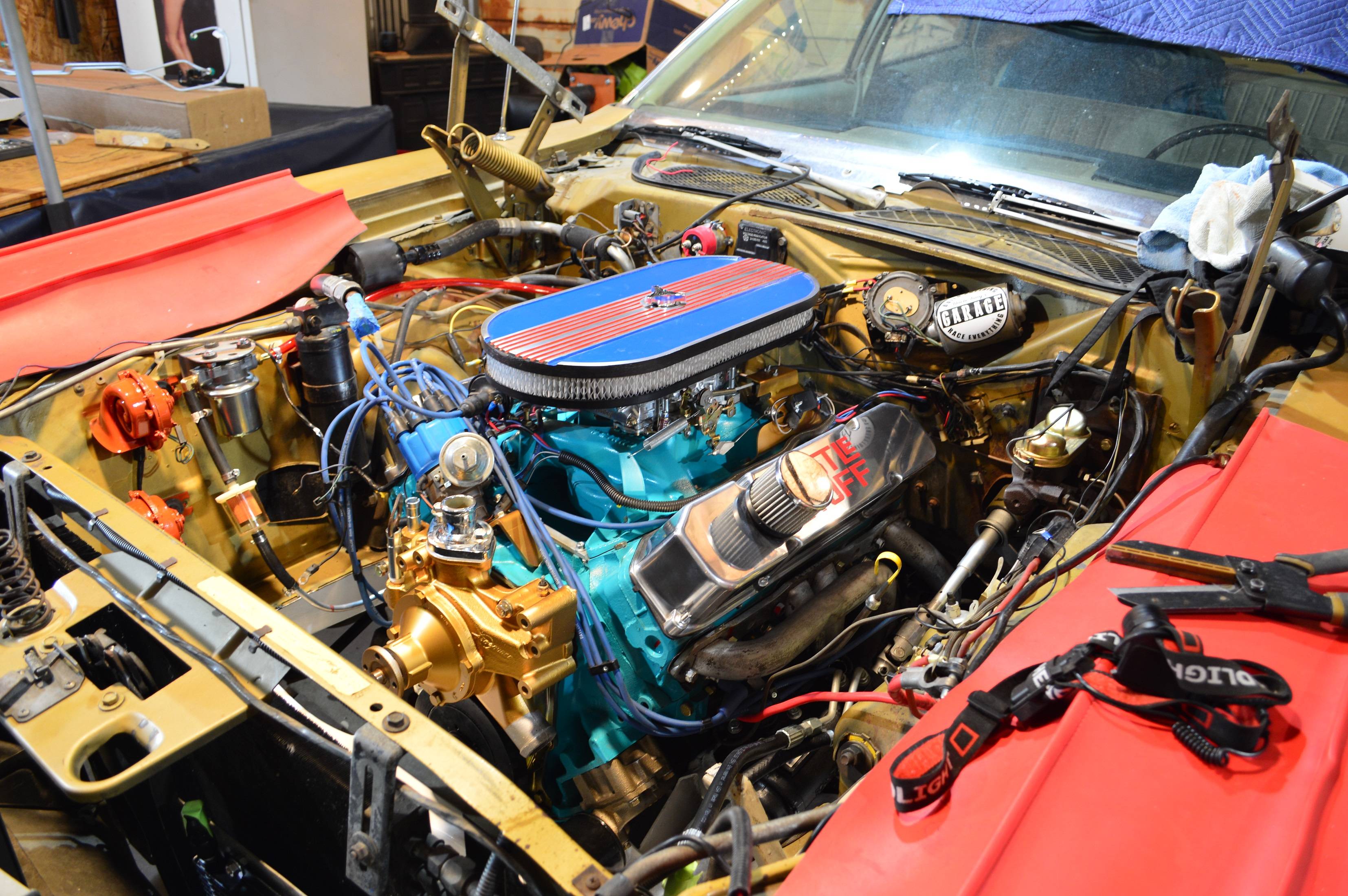

CONTROLS/WIRING

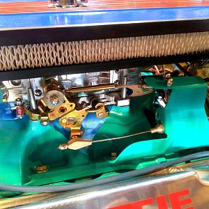

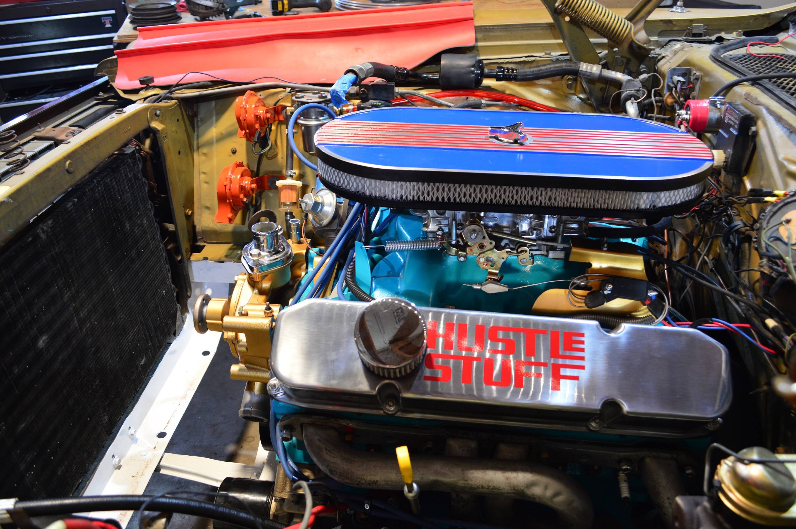

Coil mounted

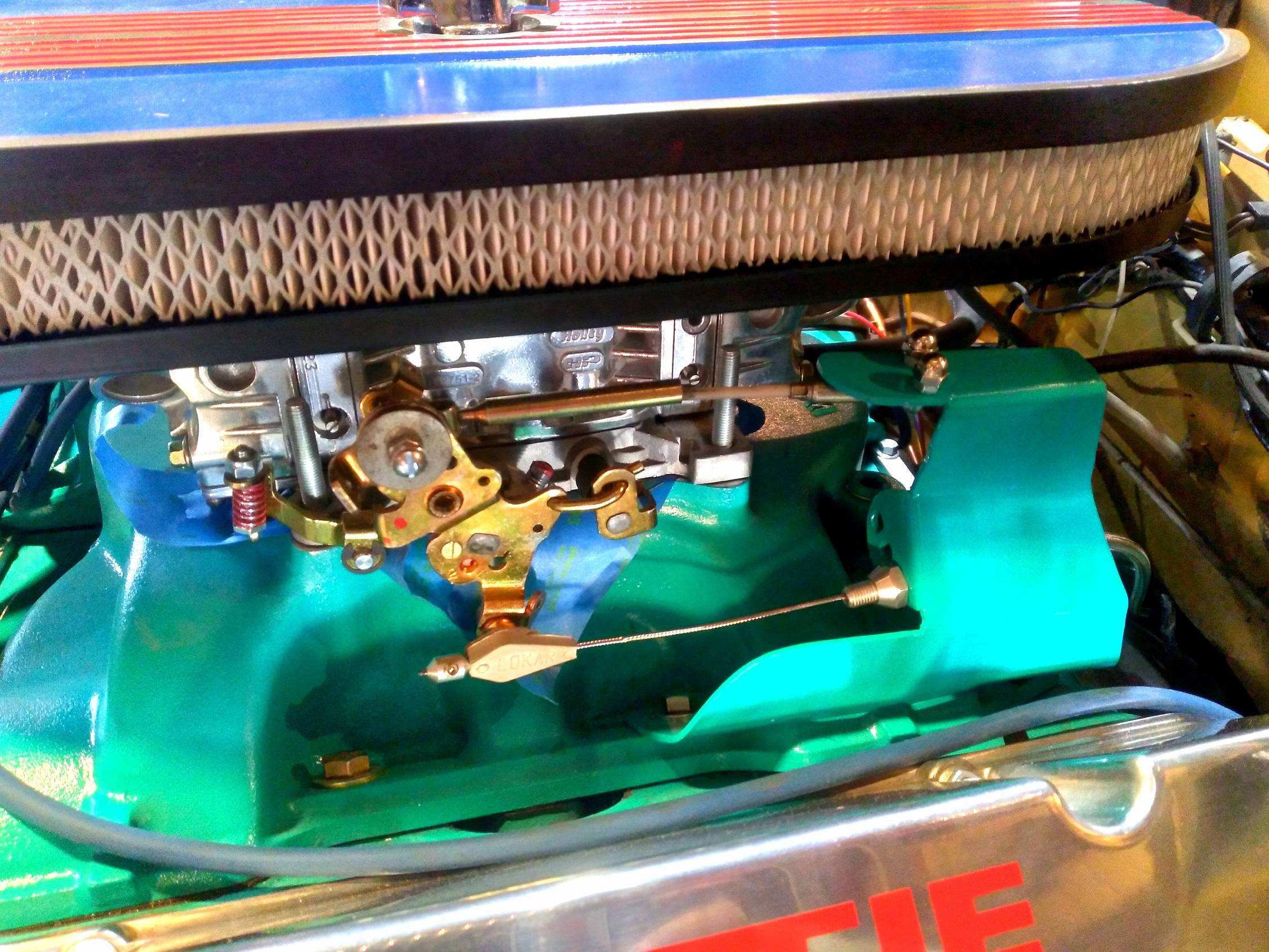

Throttle cable and Kick down bracket made.
Settled on the 3rd one I made.
Throttle return spring bracket made.

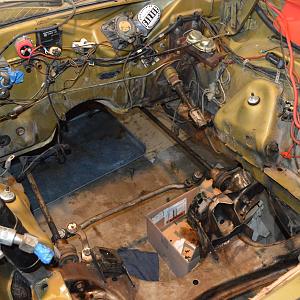

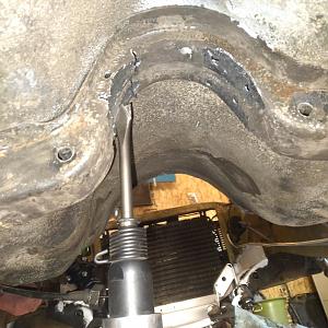

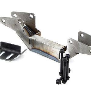

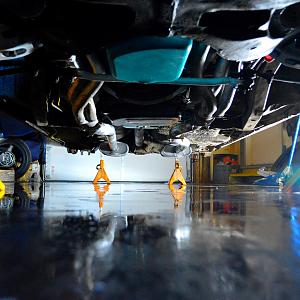

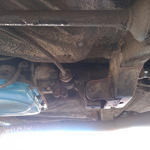

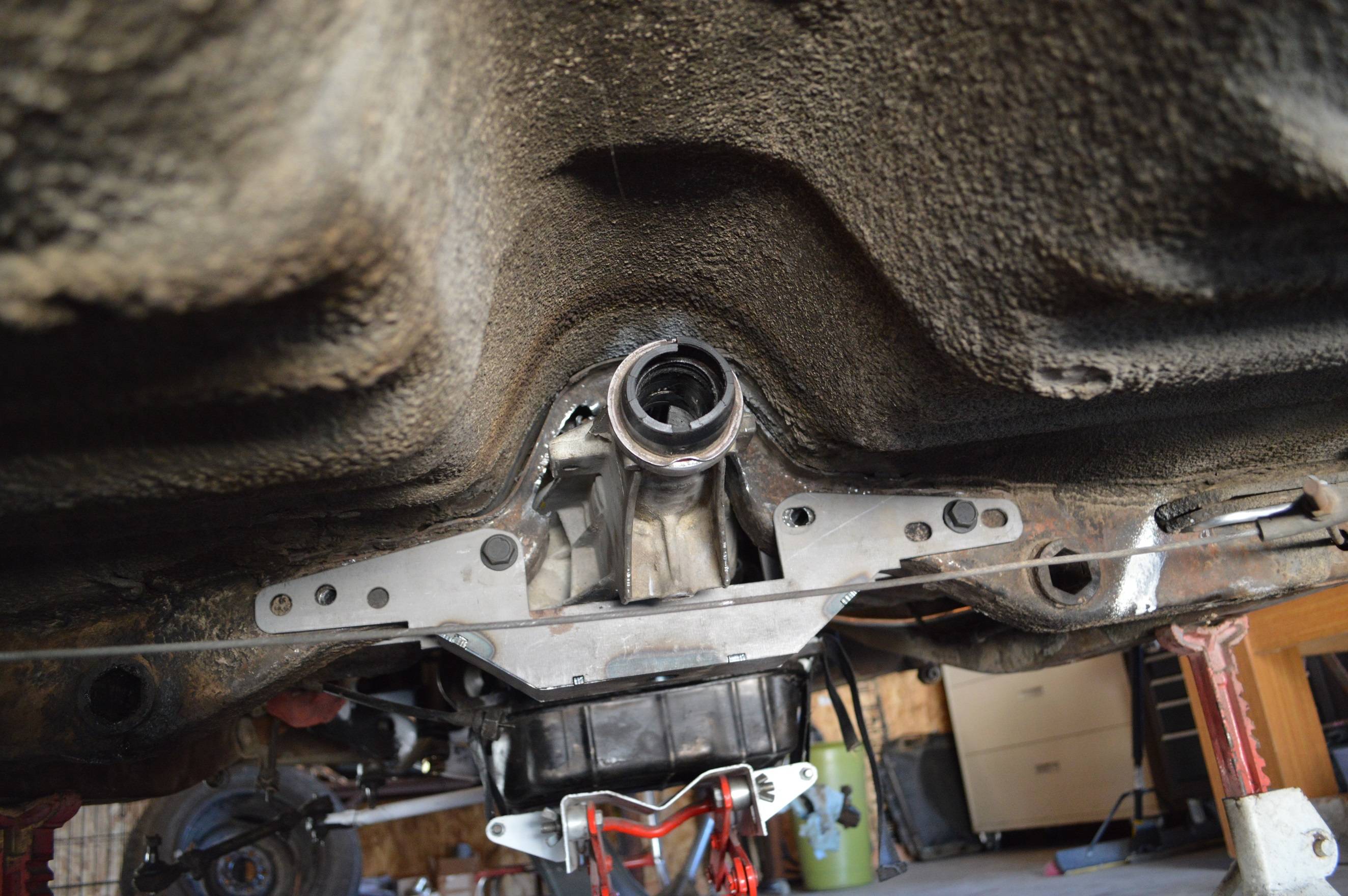

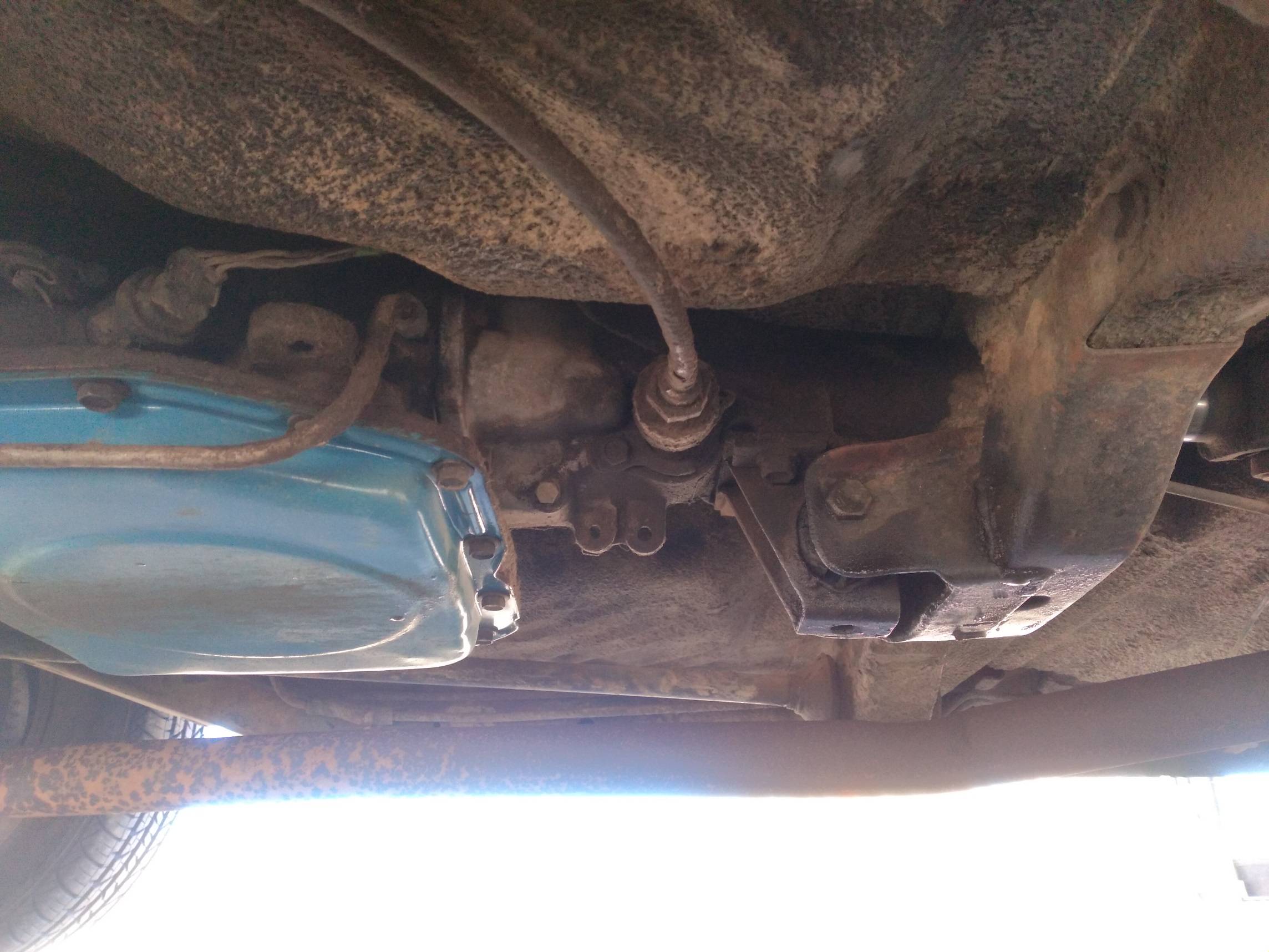

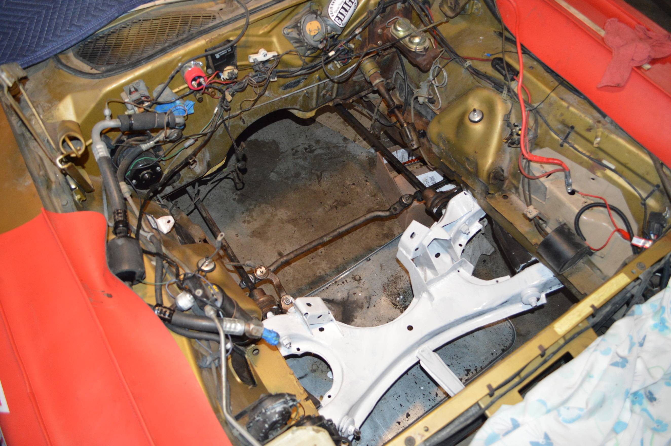

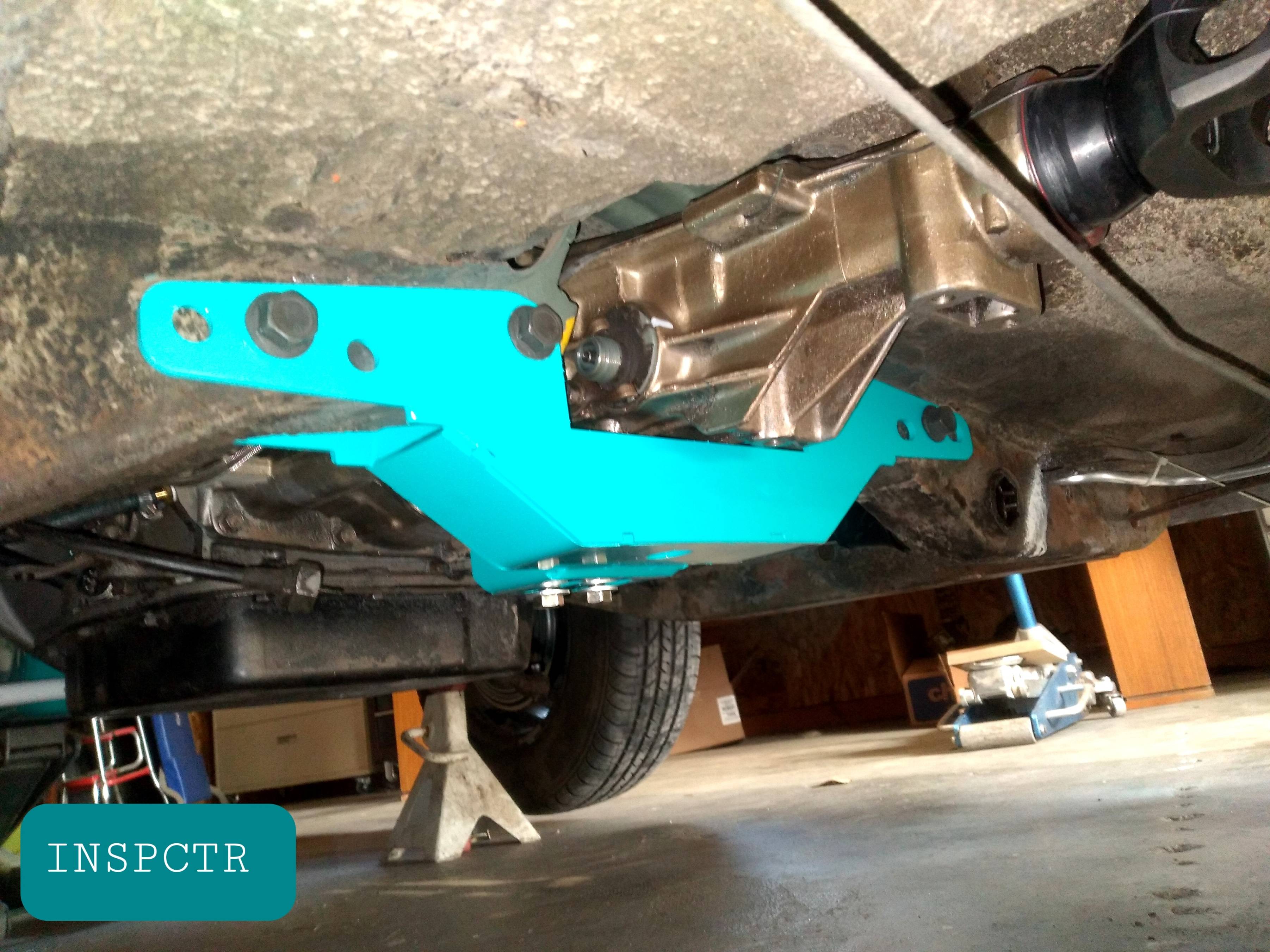

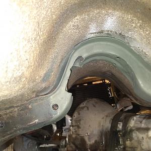

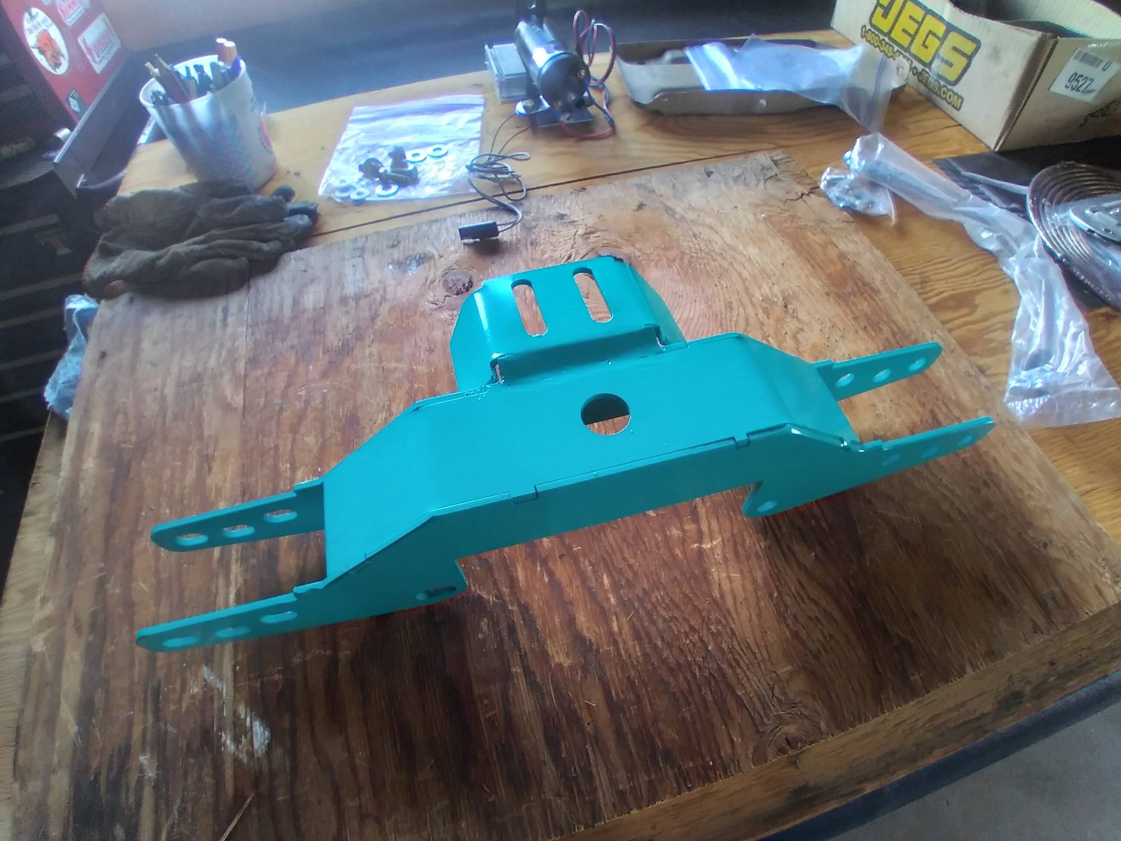

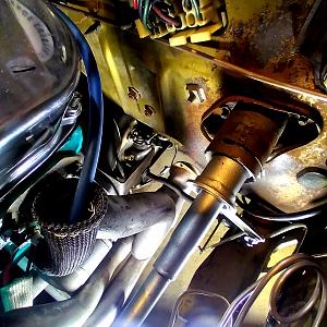

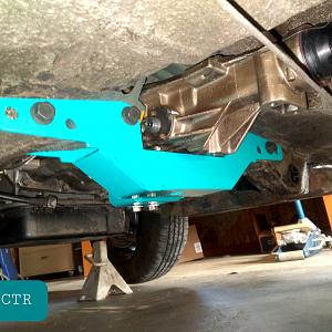

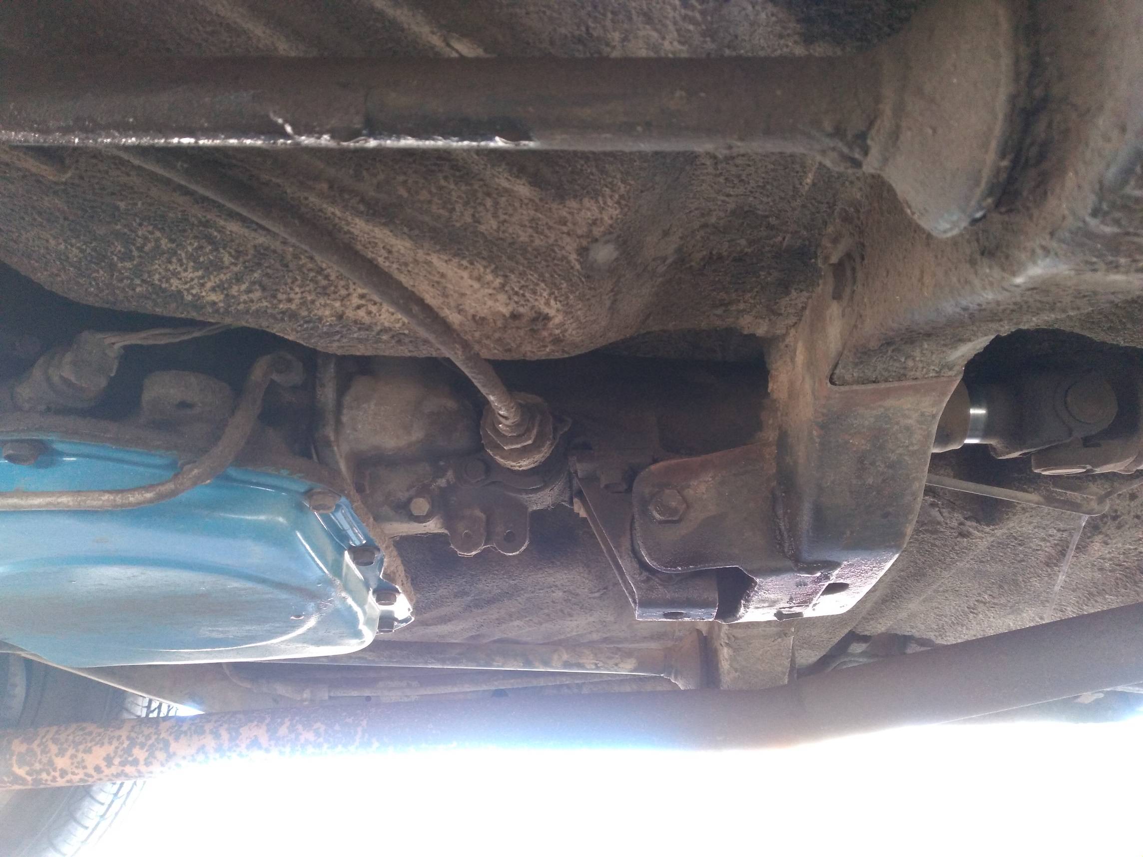

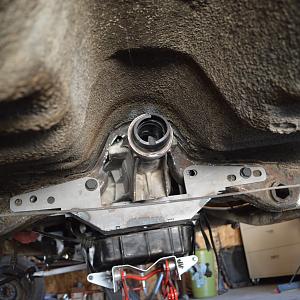

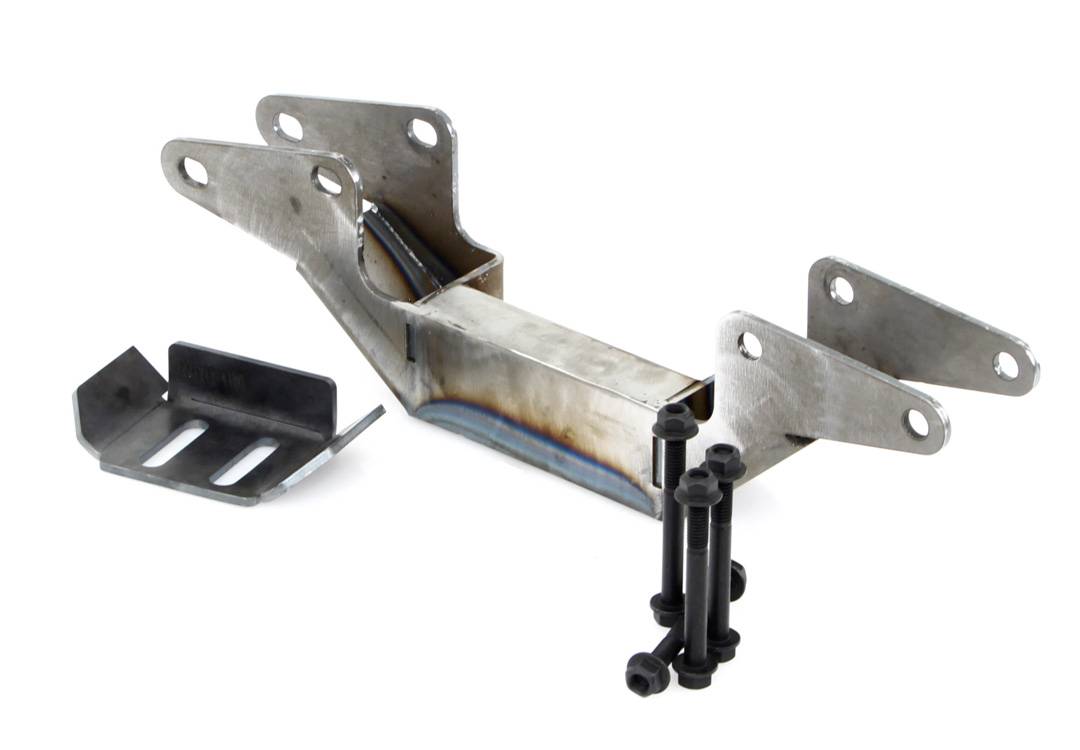

TRANSMISSION MOUNT

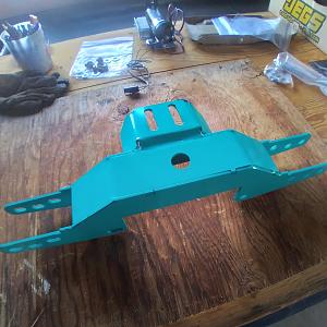

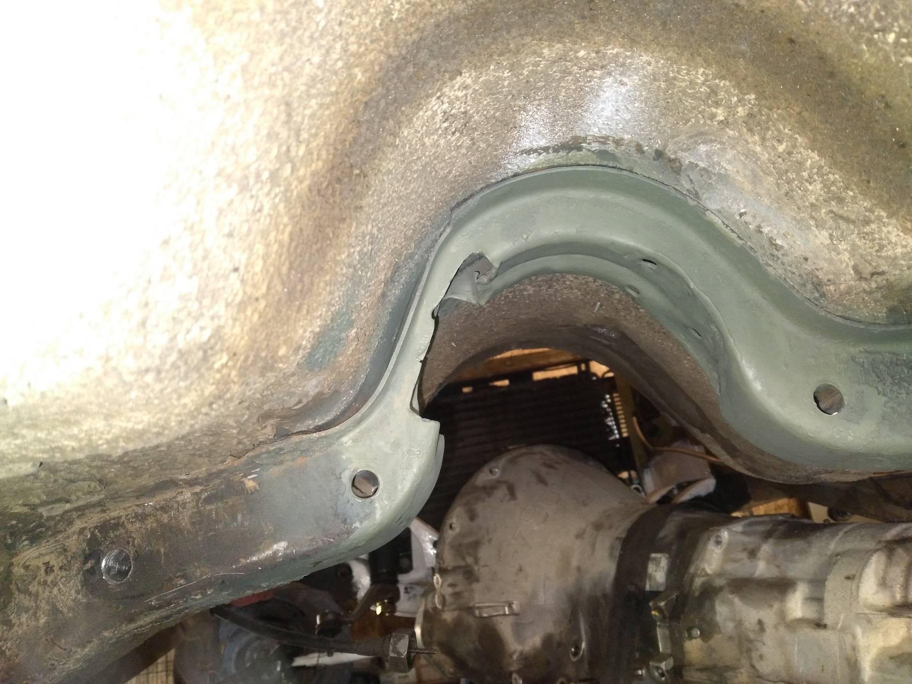

Had to do more clearancing then expected to get the 518 tail shaft to fit.
Also point of note. They require much more cooling capacity then a 904 or 727 so new
3/8 lines are needed and an extra cooler up front.
![16 tnt cross memeber 20210319_144223.jpg 16 tnt cross memeber 20210319_144223.jpg](https://www.forbbodiesonly.com/moparforum/data/attachments/1014/1014401-633d298eea6f104de0562248db425eac.jpg)
![16 tnt trans crossmember 20210319_151333.jpg 16 tnt trans crossmember 20210319_151333.jpg](https://www.forbbodiesonly.com/moparforum/data/attachments/1014/1014403-66bbe0682812a8385d2c169fa4c695ee.jpg)
Made new brackets and one linkage rod to shift the transmission.
All day affair...I need an assistant.

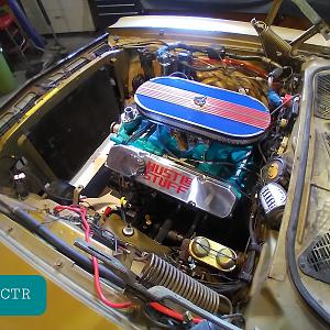

COOLING

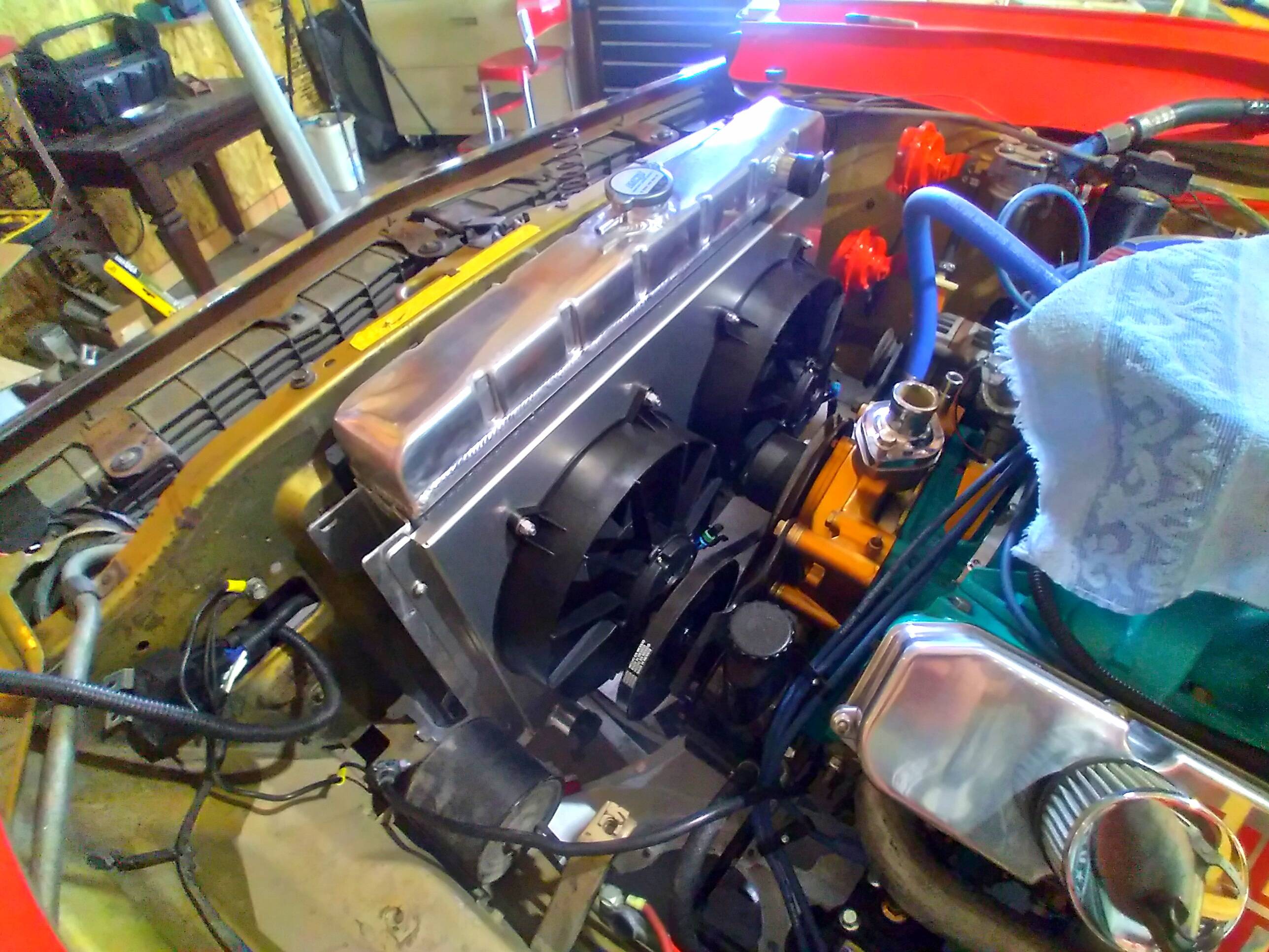

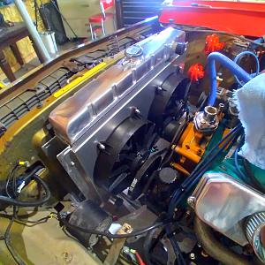

I have decided to bite the bullet and spring for a new radiator from Speed Cooling/Entropy.
I just had to do a little grinding on the bolt holes to get them wide enough to bolt up.
Really nice setup. I bought their harness as well.
The buzz kill was the heater core giving up on my first heat cycle....ug.
![22 entropy radiator.jpg 22 entropy radiator.jpg](https://www.forbbodiesonly.com/moparforum/data/attachments/1028/1028227-fcedb833a3b9e4b57654a541ef7dffe9.jpg)

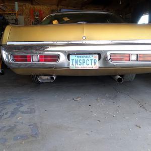

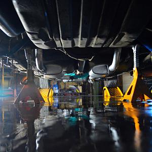

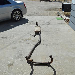

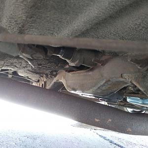

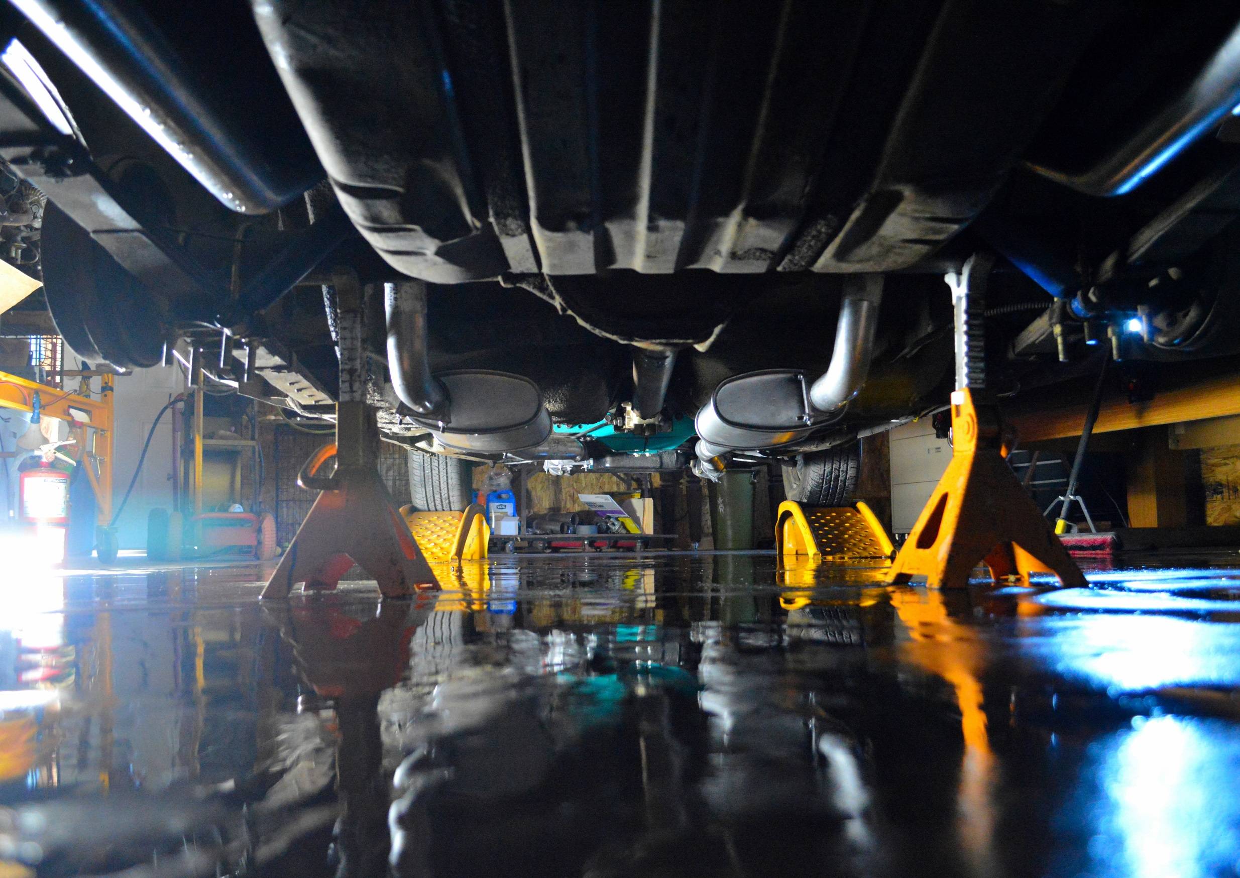

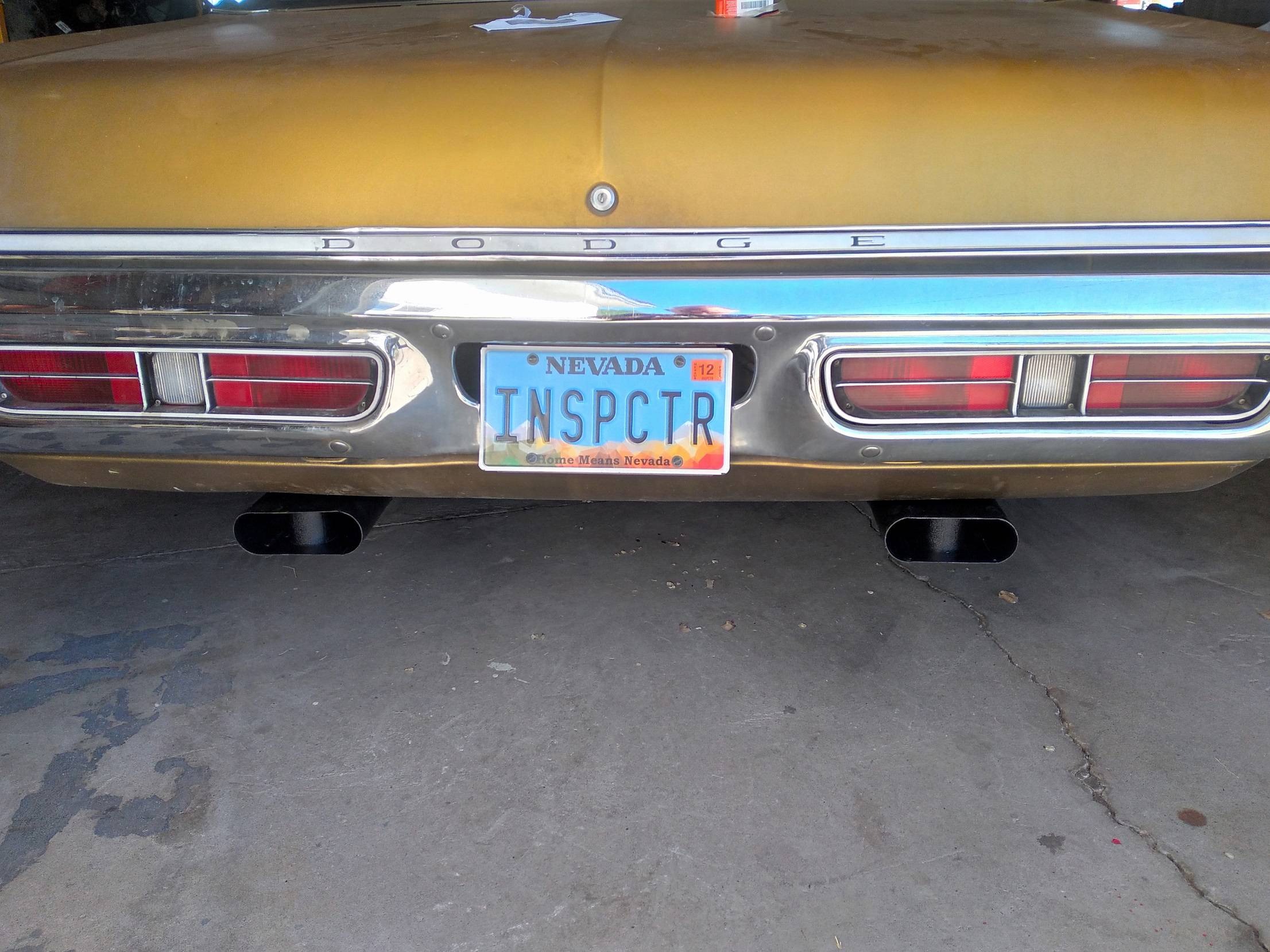

EXHAUST

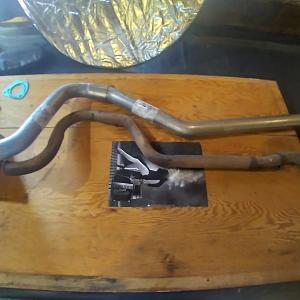

![exhaust 318 to 400.jpg exhaust 318 to 400.jpg](https://www.forbbodiesonly.com/moparforum/data/attachments/1029/1029012-491df0f31e191988aad7db3fed8a0d86.jpg)

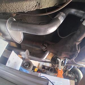

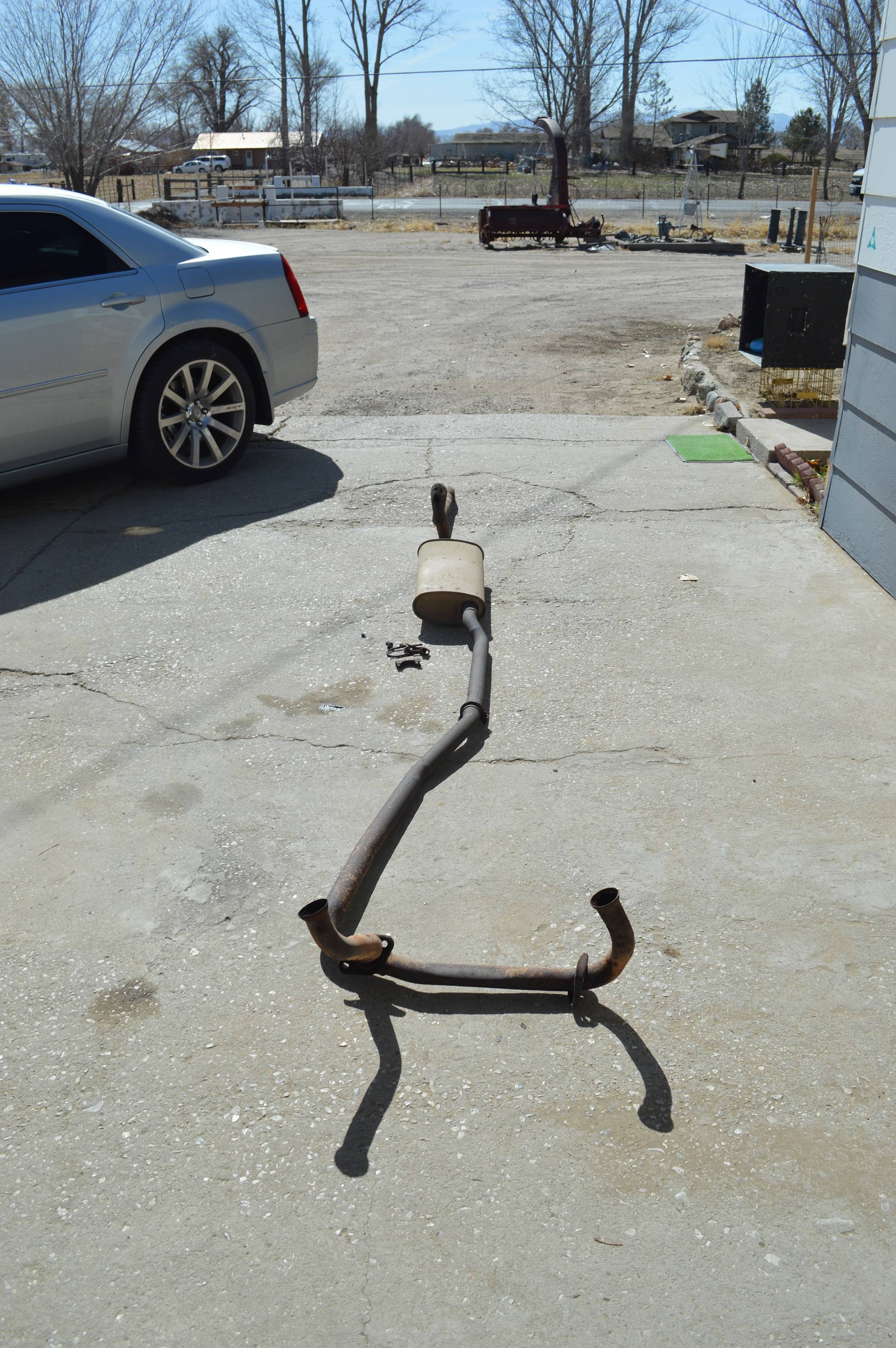

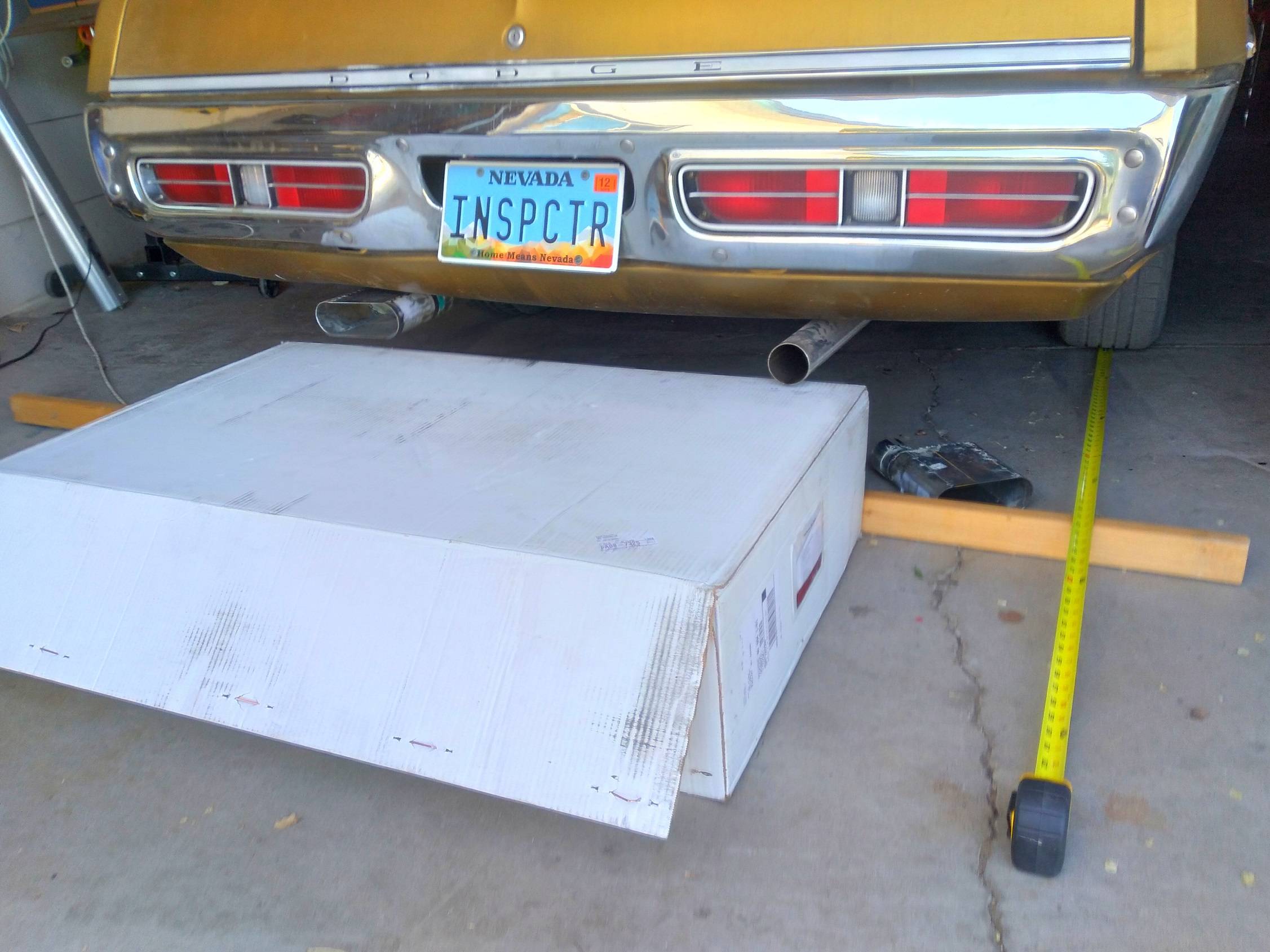

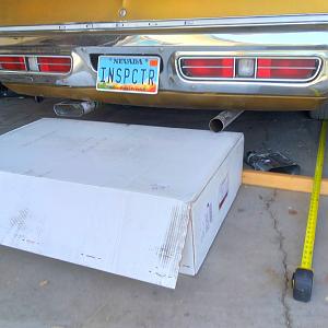

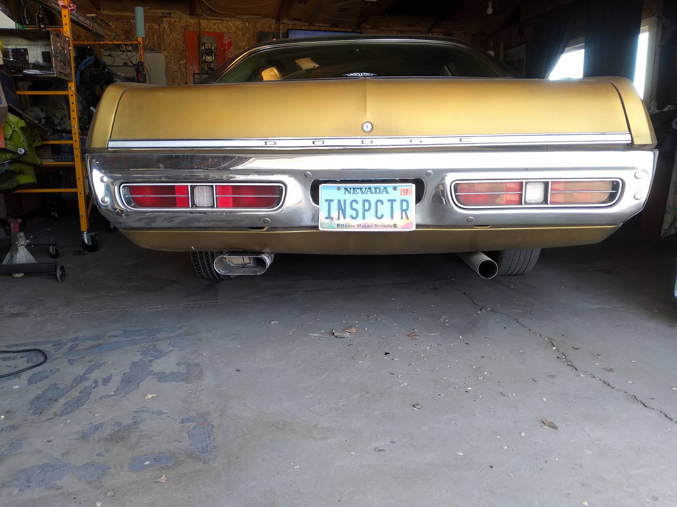

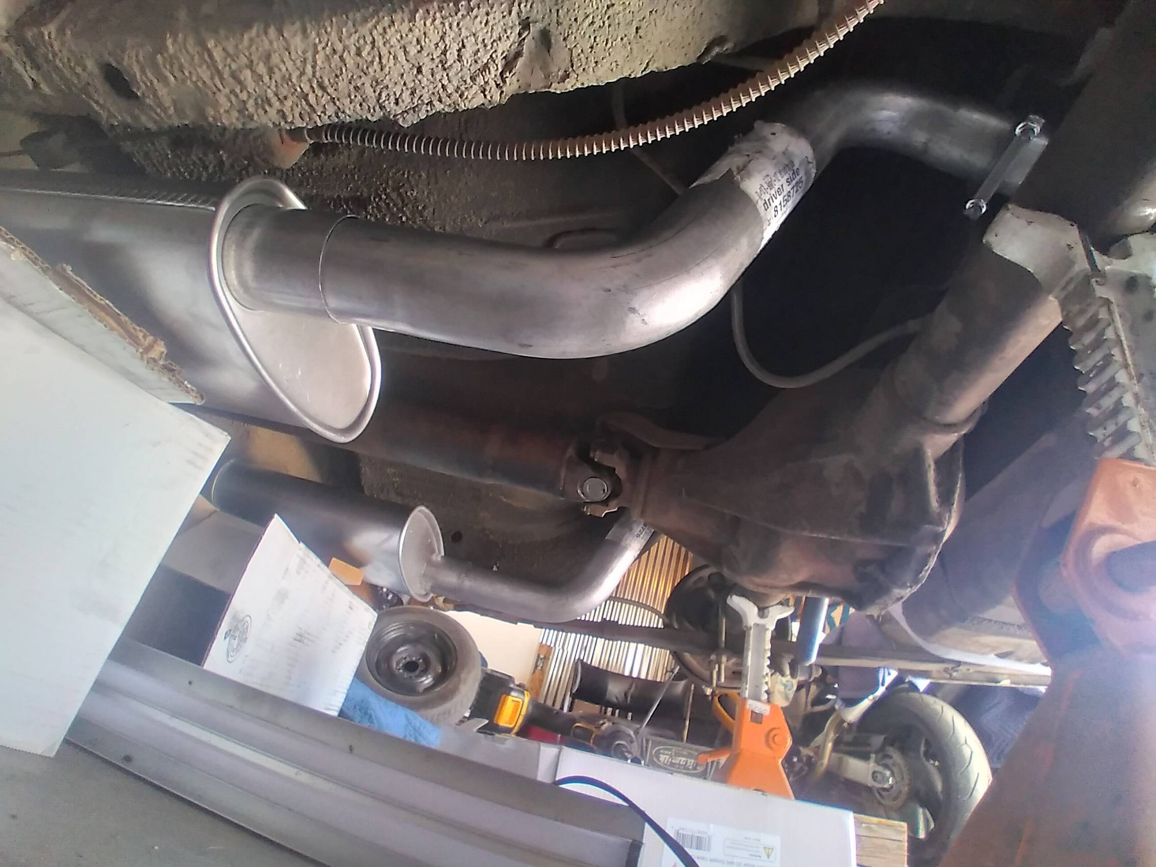

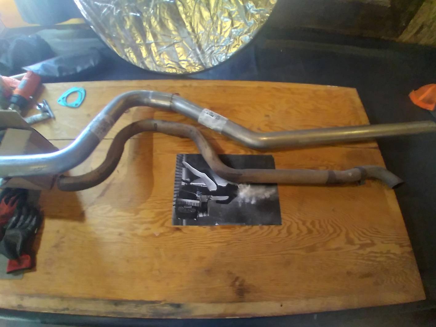

318 Had a single 1.75 exhaust
Now we have dual 2.5
![exhaust over axle.jpg exhaust over axle.jpg](https://www.forbbodiesonly.com/moparforum/data/attachments/1029/1029013-4dc4db317c17874988332a566887ff7e.jpg)
This is a prefab kit from Summit Racing.
It actually fit pretty nice however I did modify a few pieces.

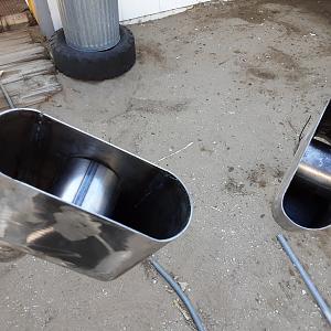

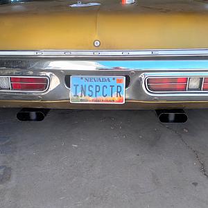

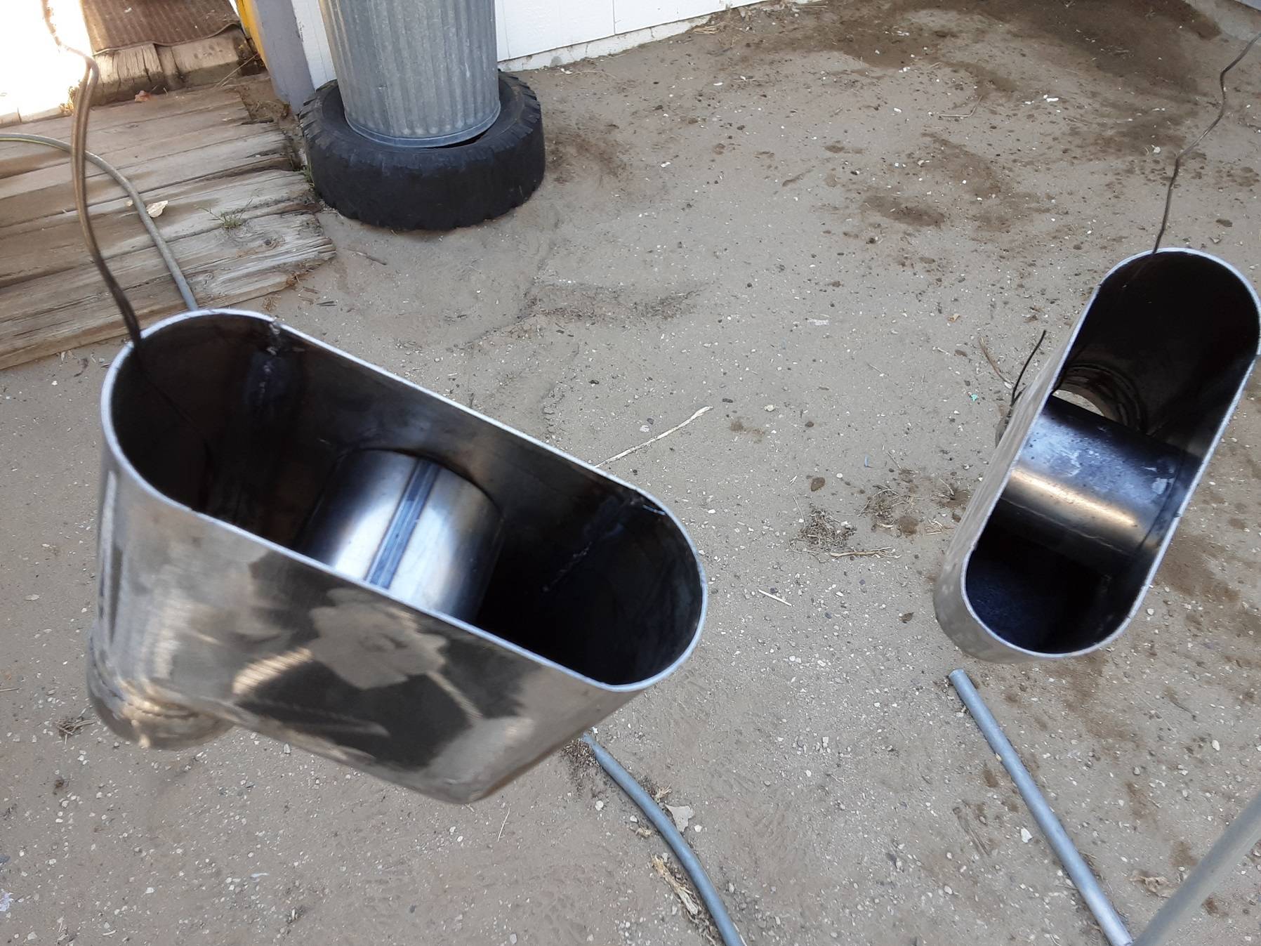

Made the custom tips from 2 1/2 tubing.
![tips 20210503_165352.jpg tips 20210503_165352.jpg](https://www.forbbodiesonly.com/moparforum/data/attachments/1034/1034195-15404eb4a03af7ecfab82ba960d582fa.jpg)
![tips compare.jpg tips compare.jpg](https://www.forbbodiesonly.com/moparforum/data/attachments/1034/1034197-6b790ee7c6a0b08e1f890576e1061024.jpg)
![tip fab 202.jpg tip fab 202.jpg](https://www.forbbodiesonly.com/moparforum/data/attachments/1034/1034198-15c8904bf0f872d5025d22575bc9085b.jpg)
