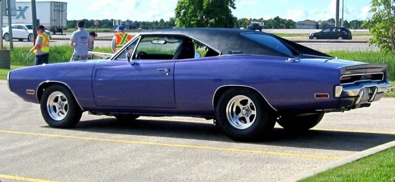

493 (440 stroker) 3500 stall - Dana 60 w/3:54's - Currently runs 11:93 - Question: how much would my ET be with 4:11's? thnx guys

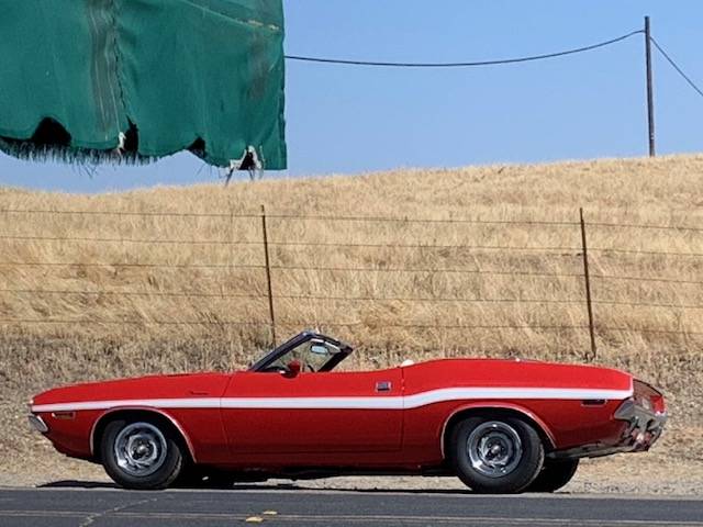

I'm sure John is spot on... But you'd also lose the ability to jump on the freeway for a longer cruise....... Well, not really, depends on how much listening to your engine spinning along at 3800+ rpm's you can tolerate.... Back in the 70's & 80's I did a few 500+ mile drives in a Challenger with a 440+6 & 4.10 gears.... These days I doubt I could do it again.... Though I must admit I still like having 4.30's in one of my Challengers... But it has O/D so it's fine on the freeway...

It all depends on a few things. Tire size, Trans type (Manual or Auto) convertor stall, trans cooler and how much you'll tolerate. That tire in the image looks rather tall and wide, so 410's would not give anymore stress.
With a 28.5 tire and 410's, it keeps the plugs clean at 2900-3000 RPM coasting at 55-60 mph which is nothing.

I'm sure John is spot on... But you'd also lose the ability to jump on the freeway for a longer cruise....... Well, not really, depends on how much listening to your engine spinning along at 3800+ rpm's you can tolerate.... Back in the 70's & 80's I did a few 500+ mile drives in a Challenger with a 440+6 & 4.10 gears.... These days I doubt I could do it again.... Though I must admit I still like having 4.30's in one of my Challengers... But it has O/D so it's fine on the freeway...View attachment 1472332

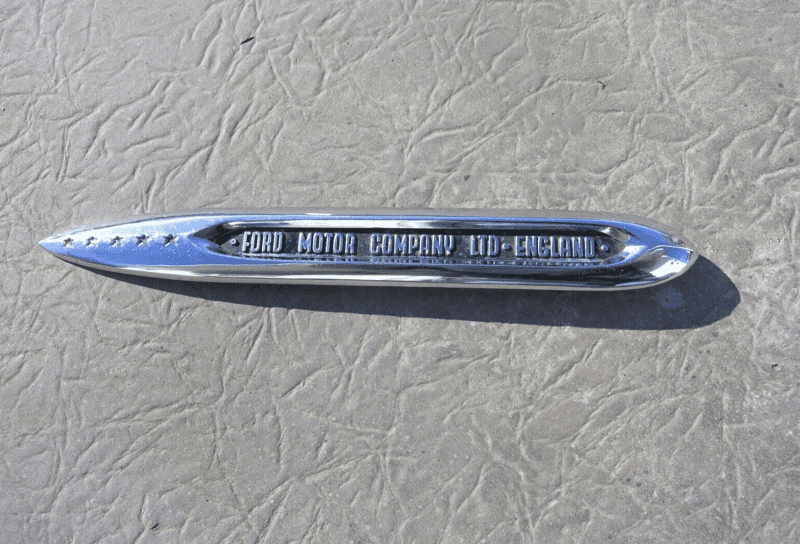

4.57 64 English ford.
