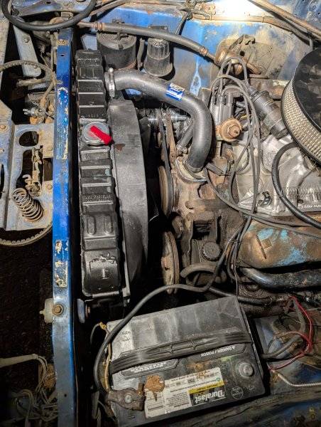

Did a 440 swap on my 73 satellite.
Have factory big block k frame with proper spool mounts
78 motorhome 440
Factory 78 motorhome pump (bigger pump blades when compared to gates replacement so I left it)
7 blade fan on unknown clutch, might be factory motorhome unit.

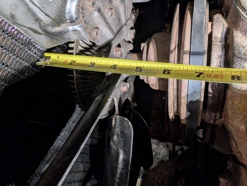

Mopar factory shroud. Had to drill new mount holes to fit my 3673054 radiator but it fits tight to fan, less than 1/2 space to blade
Face of clutch is 1.5in from radiator.
Engine will heat up to the top of the temp range at idle. Doesn't seem like clutch is slipping less as the temps heat up. Not sure if it's a bad clutch or I'm too far away from the radiator before I try to replace it. Perhaps I need a 1/2 in spacer?

PIX PLEASE.... to get a better look at what you're describing. Is your water pump turning in the correct rotation??; likewise the fan clutch...did/does the vehicle have A/C ? radiator size?? Just asking a few specifics....

I'm leaning towards bad fan clutch but wanted to confirm that a clutch 1.5in from the radiator is acceptable.

Radiator support to hood seal as well. Stops air from traveling up and over radiator instead of through it. As was said, location of fan blades in shroud looks about right. Google the test for checking the operation of the fan clutch. I don't think the distance from it to the radiator makes much difference as long as it's working correctly. Blade to shroud opening location is definitely important. Also, foam sealing shroud to radiator is a good idea...
Will check out the hood seal. I just got the car running in the last 24 hours, no throttle cable mounting solution yet so I don't know how it behaves while driving yet, but extended idling caused temps to creep up to upper range so I wanted to address that before getting it on the road

Spacing looks fine. Don't get fan too close to radiator, the motor/transmission mounts can flex under hard breaking and the engine can move forward slightly.
It is not so much the distance there but the distance the fan is located in the shroud. The fan blades should be about half in and half out of the shroud for the correct setup.
