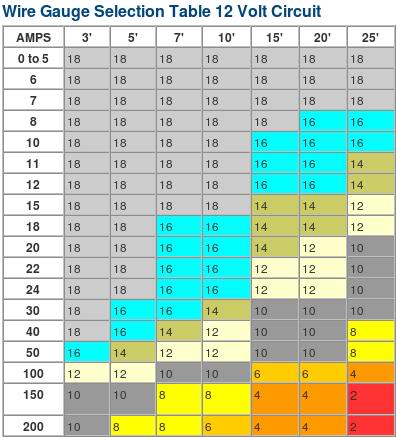

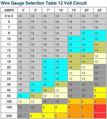

Increased lamp load is only one consideration for installing headlamp relays. Removing the voltage drop across the stock 40+ year old small wiring, switches & connections will bring marked improvement in performance even with factory type sealed beams.
That is spot on. The changes people report when using the kit I build are substantial, even with the old sealed bulb. Halogens are a step up.
Larger wire sizing creates less voltage drop along the runs. Multiple connection in a run creates resistance, thus voltage drop. Headlight performance degrades exponentially with voltage loss. A 10% loss of voltage may create a 15-20% loss in light output.
