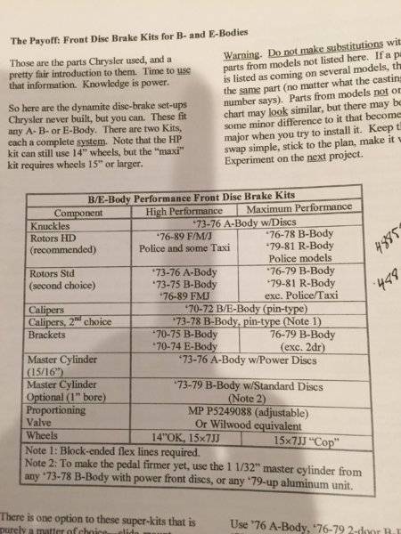

As for the books: I'd like to see exactly what Condran states in the book to see if there's a "gotcha" in there that hasn't been noted, or if his claim is clearly an error. I haven't read the book myself, but out of curiosity, I Googled it and happened across this page:
This isn't conclusive by any means, but note that neither of the caliper choices or knuckles are FMJ. The FMJ 11.75" rotors are also omitted as an option.
What's more, Condran specifically recommends, on this page, 15/16" masters for power disc setups, and 1" for "standard" (I assume this means "manual") discs, going so far as to recommend increasing the bore size to 1-1/32" "to make the pedal firmer." (He also recommends the "'79-up aluminum unit" I'm running now, but doesn't specify what the aluminum 1.031" master has over the 1" that makes it that much firmer - unless it's simply a poor choice of words; perhaps the goal was to point out that the aluminum units perform the same as a 1" bore steel master?).
According to this chart, all of these recommendations assume the user has B/E pin-type calipers and no other. Neither FMJ or A-body calipers are investigated, and - as per those warnings above - he was obviously not open to any other alternate combinations when he wrote the book. (Side note: I wonder if this bias originates from the same source where Ehrenberg's (hotly contested) argument over FMJ spindle geometry comes from, but that's a whole 'nother can of worms).
If he claims somewhere else in the book that 15/16" is appropriate for non-power disc applications, he's contradicting his own table in the same book. But before I assume this as the case, I'd love to see a copy of the page (or the wording) that you read, @69charger440. Obviously, we can't really assume anything without comparing his exact words from one page to another.

Excellent discussion, Kurt. Without reading his whole book, one can easily misunderstand what that chart is saying. So it’s very understandable why you have many questions about it. I can try to explain more later tonight when I get more time.
And thanks for correcting me about the 5/16” vs 15/16” bore lol. Is there a way for me to edit it, so as not to confuse everyone?
I will be back later to address other issues from the book.
