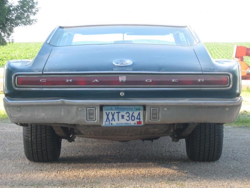

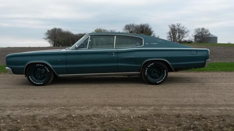

I'm running 15X10 with 5" B.S. on the rear of my '66.
