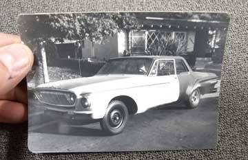

Early 60s b bodies ran 16" in the front and 15" in the rear. 16" steelies were off studabakers I believe. Here is a pic from bob Mosher. 17" may be a little much but honestly if you think it looks cool then who cares what we think.

Yea he was going for weight trandfer. Personally it looks stupid!
