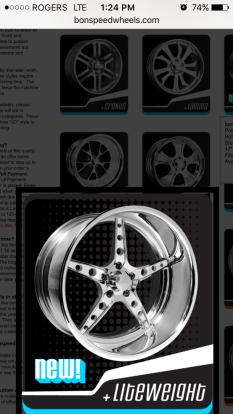

I'm running a 255/45r18 on an 18x9" wheel. Has around 1/2" of clearance at full lock, with 6.3" backspacing. Stock torsion bars and control arms. Need to have a really nice brake package to take advantage of that 5-spoke design.
Yes bonspeed

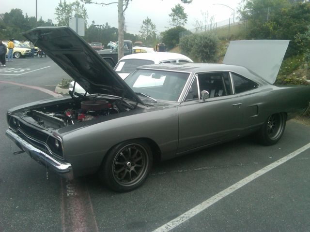

Bonspeed 18x8" w 255/45/18 on Magnum force dropped spindles and Firm Feel "goodies". To me, on my car, there's almost TOO MUCH room in there. I may lower the front end a bit more to get more of the look of the back wheels.
It does rub on the inside at full lock when squeezing my car into the garage and trying to get as far from my wife's car as possible, but that's the only time I'm ever near full lock.

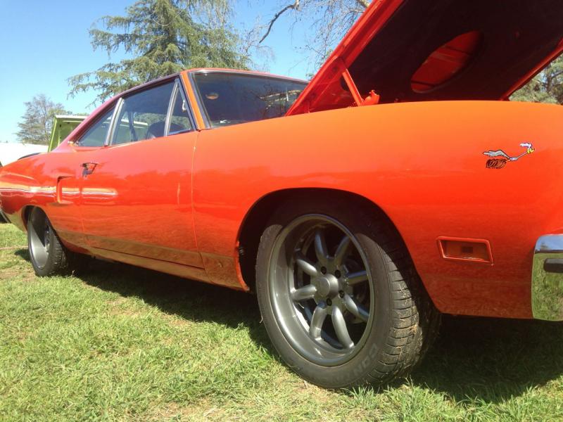

image.jpg. 18 X 8.5 245/45 up front. No rubbing, can't recall the BS. 20 X 10 on rear. image.jpg

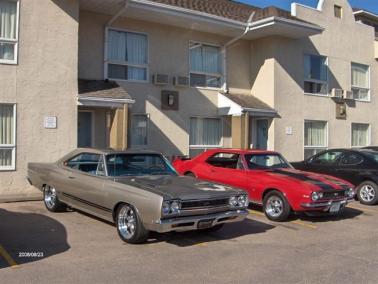

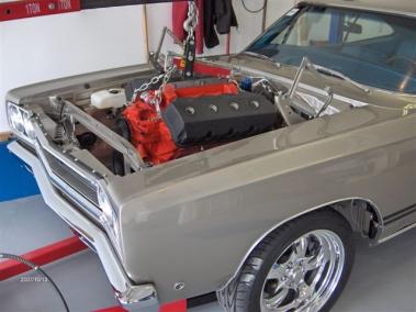

That's a pretty car Malex!
Both of your cars a nice! Love the hemi Max.
