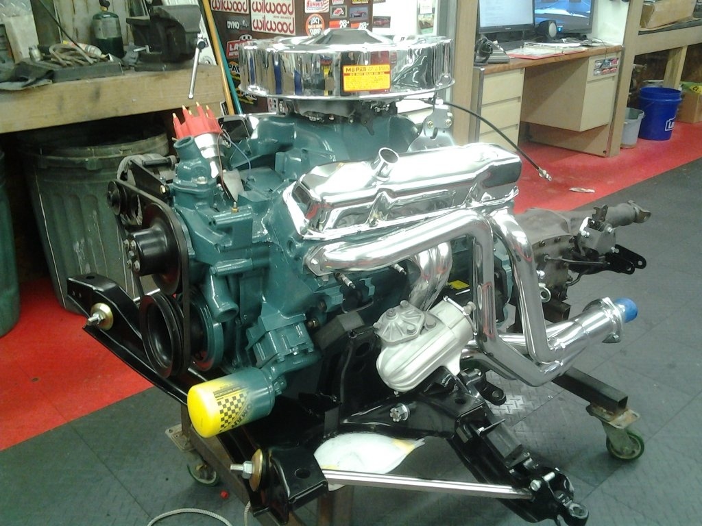

I was looking at the design of this starter to see if it could be clocked at a different position. Doesn't look like it can. I've always thought about the terminal position and I'm liking the location on this one but I guess you can't have your cake!
Go buy a cheap mopar mini starter off ebay for $59.00,that starter's barrel is too wide. Problem solved.
I was thinking the same thing about the width of this starter. I have a Advance Auto right down the street. Might get one and try it out. If not, they will take it back.

I bought that Jegs starter from a member on here for the right price and it's the higher gear ratio one. Thought I'd give it a try. After bolting it up, it appears to be as wide as the big ole factory one. I'll give one like you posted a try before useing the BFH and report back.

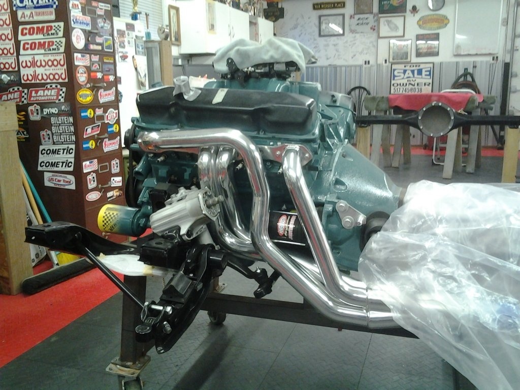

I have the exact same starter and with Headman's #78030 headers you DO have to dimple them. Two tubes need to be clearanced to fit around that starter. Both the #3 an #5 pipes have to be dimpled in order for them not to touch. I massaged mine so I have a minimum 1/2" clearance which should be good.
