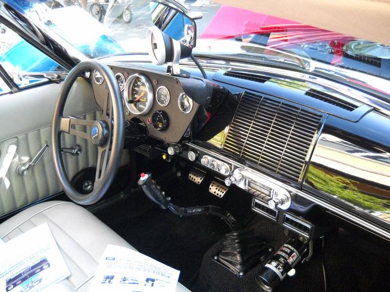

I'm still just thinking about converting my 63 max clone to 4 speed. Question; I have read that 62-65 B body pedals interchange, true? Also how hard is it to find bell housing, flywheel
Yes, the pedals interchange 1962-1965. Best place to find them is basic slant 6, 3-on-the-tree car. If you keep the unique ball and trunion u-joint driveshaft, you will need a 1964 or 1965 4-speed. 1966 and up 4-speed used a slip joint. Transmission crossmember and mount is different for 4-speed. I don't know if you are trying to do a conversion that is "correct" with 1963 parts, or whether you are doing a conversion that is serviceable with other year parts. Although 1963 Plymouths were available with a 4-speed, it was a BW T-10, that Chrysler did not figure was sturdy enough for a Maxie. The A-833 Chrysler 4-speed became available in 1964 Maxie cars. A slip joint drive shaft from an automatic 1965 Belvedere will be needed with newer transmission. I think these cars came with a steel bellhousing and flywheel meant for use with a 11" clutch. These could be hard to source. An alternative could be the 10 1/2" pieces from newer big blocks. As weird as it sounds, a 10.95" clutch can be bolted to the 10 1/2" flywheel. Brewers in Ohio can supply knowledge and parts for this conversion. Wayne and Dan know their $hit and are good to deal with.

Post a WTB ad on here. Some one could be parting out a car that has the pedals you need. A friend of mine bought a 1962 Dart Maxie clone that had a slip joint A833 in it with a Dana 60 in it, so it has been done.
Norms has great parts, and you can find the pedals cheaper, you just need to gather the rest of the parts.
I sourced everything separately and saved a few hundred dollars, but I also restored mine myself.
His steering columns are perfect as well and worth the $.
I recently bought a '64 with a manual and it has the extra bracket, the one I did not need for my '62.
'64 requires the extra bracket, as well as the pedal assembly with the top piece that turns down, so the bracket can be mounted on it.
'62-63 do not need the extra bracket, so it does not matter whether the pedal assembly has the top piece that turns down or turns up.
So, you could buy any pedal assembly from a '62-63 or a '64-65.
