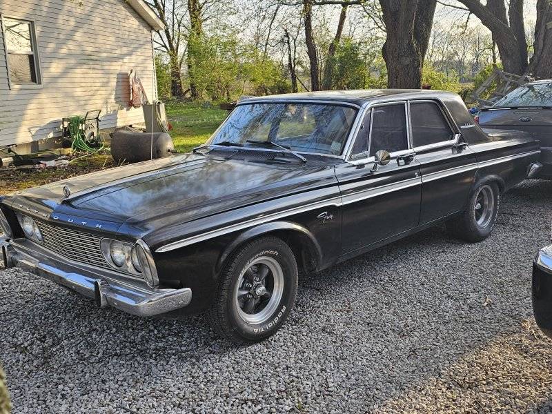

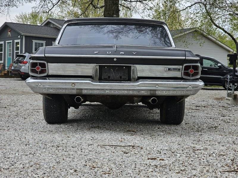

Pics please.
It's not a trailer queen, not trophy worthy, but drives me where I want to go. Soon will get me there faster.
