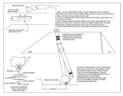

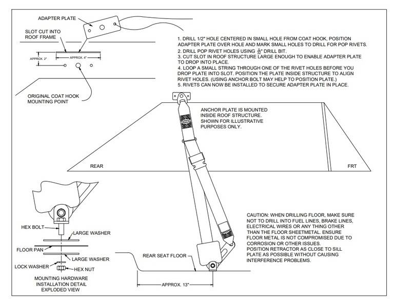

I believe you mount them in the roof, since its a hardtop car. Couple months ago i got the opportunity to buy a 67 Barracuda, and i looked at three point belt conversions for that as well. On that car you had to remove the roof lining and rivet an attachment plate in the roof.
Im going to look into this further, i feel like i really want three point belts not just for my daughters safety but my own as well. Maybe im getting old.
Edit: I just noticed that they had instructions on the website lol. They are riveted to the roof, i think i will order a set and see how they work.

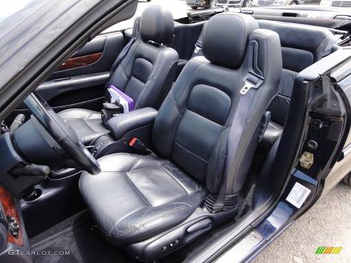

Sebring convertibles used a bucket seat with an integral 3 pt belt. Not very pretty but maybe it will give you a few ideas.
