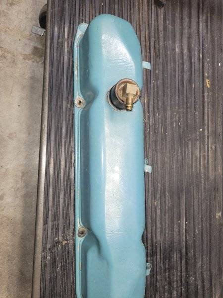

I forgot the valve cover have four bolts and they look much nicer/cleaner than the rest of the engine

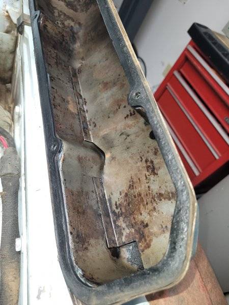

I forgot the valve cover have four bolts and they look much nicer/cleaner than the rest of the engineView attachment 1391002
I notice the gaskets are only 4 bolt, but the corners of the covers look like they extend past the covers to fit the 6 bolt heads. Are these corners punched for a stud, or are they plain. Could you post a picture of the top of the valve cover showing the corners?

So, I've had fairly productive day. I'm attaching several pics that I hope will help solve this mystery engine. The valve covers are four bolt with raised "Dimples" in the corners. I do see the extra holes in the heads for more bolts. The passenger side valve train looks as nice as the drivers side. It appears that someone may have cleaned up the valve covers (See scrape makers inside of valve cover) and painted them. The picture with the numbers/letters is on the front drivers side of the block. I was able to get my hoist hooked up and got the exhaust manifolds off. I think I'll only need one for the drivers side with a back outlet. The one that was on there had a center outlet. I took all the plugs out and they looked good, maybe a little rich. I would like to think that someone wouldn't go to all this trouble to put this engine in if it was weak and or bad. The one picture is of a cannister coming off the automatic transmission. I have no idea what that is. And lastly,what is that opening in the center of the intake? There's one on both sides.
