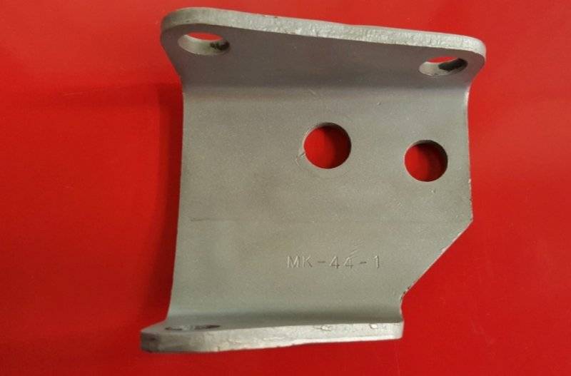

Engine Support Brackets 62-65B-440 Source
I have to watch what I recommend here as most of my parts/pictures are from the '62 year. Most are the same. This looks like the passenger side bracket that I had blasted. I don't have a pic of the other bracket for some reason. Notice the part number.
I'll try to check my mounts later as I'm going out of town for a few days. So, If my passenger bracket has the same number as yours, and I swap isolators, it may work? Forgive my confusion but I saw you had the link for the BB motor mounts.
