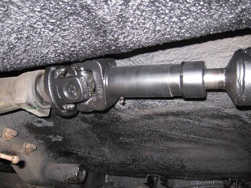

I have a 1964 Plymouth Sport Fury that i am redoing. I have done a lot of work to the car and just finished a doing a disc brake conversion and replaced the third member. I was going to buy a new driveshaft, but it is so different, and I cannot find anything available for this car. is there a way to get rid of the CV type joint at the transmission and do a normal slip yoke or is there somewhere I can buy a new driveshaft for the car. I have a police interceptor 440 in the car but it is still the original 727 trans. Any help with this would be wonderful. I am new to the group and look forward to getting to know yall.

In case the OP decides to keep the B&T setup.. here is a good rebuild video.. pretty simple stuffs

So.. Brewers sells just the boot (hoping that's all mine needs) it's pricey but at least it exists :) A full rebuild kit is $137... still cheaper and easier than redoing the trans just for the u-joint.

Use a 1965 Big Block 727. Although the '65's no longer used push buttons, they were still cable shifted. The bonus is that they changed the tail shaft and housing for a modern slip joint. They are a straight bolt in conversion, if you use your existing push button cables. Since these are a one-year-only transmission, they are getting hard to find. 1965 Chrysler is a good donor, because they always have Big Block 727. Even if you can only find a Small Block 727, found on 318 Poly's in '65 Dodge and '65 Plymouth, you can swap all the rear slip joint stuff for the trunion joint parts on your '64 trans. The transmission has to come all apart for this, so it would be a good opportunity for a rebuild, or upgrades. A 1965 Belvedere drive shaft would be a straight swap for your '64 piece. I have done this conversion myself, and I know it works.
