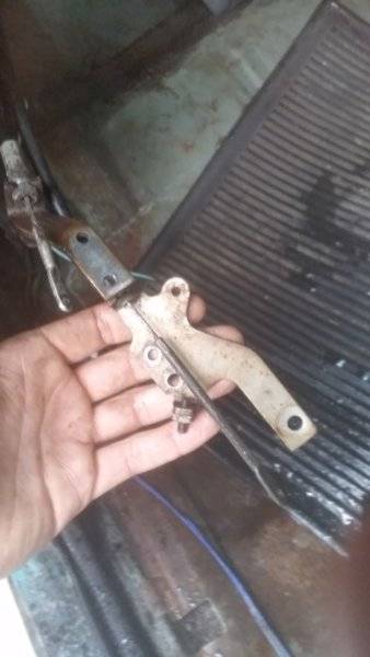

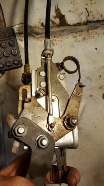

I just got back home and was able to get the shifter out of the car so I have it with me. I immediately noticed the large spring that connects the park lever to rest of the shifter assembly was broken in half. now I'm wondering two things
A) is that the source of all the issues
B) where will I ever get a replacement spring
The part that makes me think it might be the shifter assembly (and not be the cable adjustment into the transmission) is the fact that all the gears and kickdown were working fine until this happened.
That spring holds the park leaver in and also out. If the park leaver isn't released it wont let you select a gear. If the spring is broke, it wont hold the leaver and park cable out when driving and could allow the park to disengage when in park.

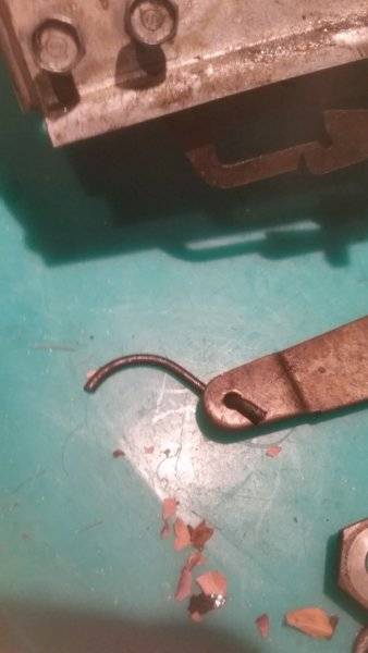

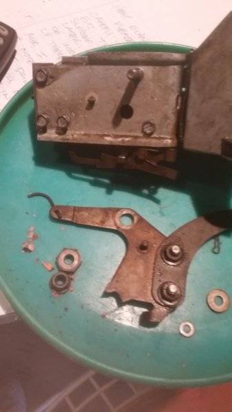

This shows the broken spring, most of it is gone. Couldnt find the other broken part...
The spring connects the parking lever to the part that cable attaches too (that part is crimped around the cable so I left it attached. and that part is bolted onto the shifter assembly.

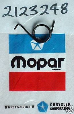

I have a spare shifter but the leaver and spring are missing. Heres a pic of what it looks like. Might have to get one from Joe Suchy.
Buy it screwing around looking for a cheaper price is it worth your time?

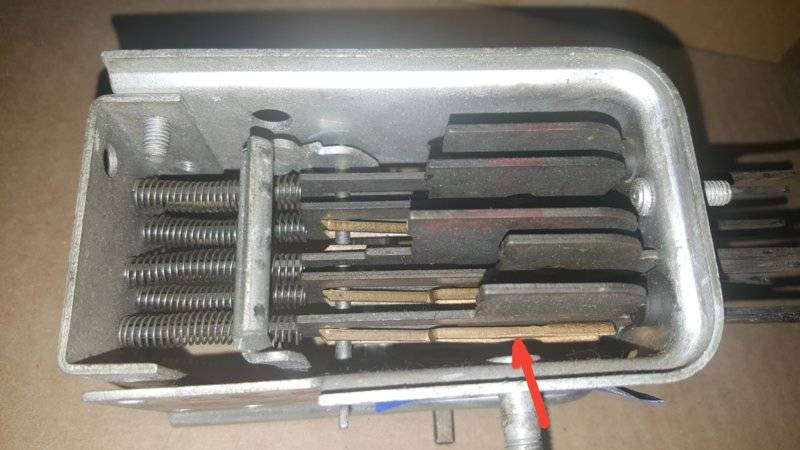

The part that is broken on mine (in addition to spring) are 2 out of the 5 total clips that "grip" onto that bar, keeping each button depressed after they get pushed in. Those 5 "clips" I'm talking about are riveted onto each of the parts that slide back and forth (the parts that plastic shifter buttons grip onto) 1 for each gear selection.
When the clip is broken, The button will push in and release the other buttons, but won't stay pushed in.
You're talking about these...
Yessir
Thanks for the pic! My neutral button is halfway broken (1 "arm" of that clip is broken off, suprisingsly it still hold the button in, just not quite fully) and another button (don't remember which one) is fully busted and doesn't hold the button in at all--- maybe it's my reverse button and it broke the other night? Hopefully...
