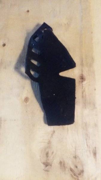

          I don't know the part number but I think this is what you are looking for. 20190406_154007.jpg

          I have a piece of foam in there with carefully cut out holes for the buttons, I think my problem lies elsewhere but I'll open it up when I get home and get a closer look to see what's binding.
