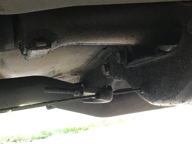

OK I want to be sure I'm looking at the right thing here.
Is this what you're referring to?
Thats the parking brake but it has nothing to do with the park lever, it's connected to the parking brake pedal... Park in the transmission is a lever that pushes a pawl into notches in the governor support...

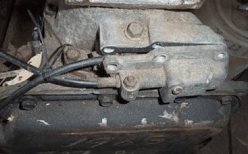

This is the park mechanism...
Info here..... https://1962to1965mopar.ornocar.com/transtech.html
To adjust the cable, you must loosen that 3/8 nut and drive locking pin back. To remove the cable, you must remove small plug with 3/16 Allen key, and reach up in there with a small screwdriver to unlock retaining spring. Then, pull cable out. Then, you can remove small housing to see if park shift mechanism has come apart. I have known cable receiver to come unhooked.
Ah yes I got confused from the other post. If the transmission doesn't go into park the cable is not seated properly or adjusted in that housing pictured above. Ignore that threaded thing and fork under the car, that is to adjust your emergency/park brake.
I tightened it up a but. The emergency brake pedal is definitely tighter and that's a good thing since I don't want the car rolling away...
So I need to disassemble the housing and check the cable end inside.

I couldn't find anything wrong with the cable on the transmission end of things and was trying to decide what my next step should be. I decided it wouldn't hurt to have a professional look at it, so I took it to AAMCO. They got it up in the air, pulled the pan and checked everything out. They said it was all good on that end. They followed it up to the controls and said the cable is broken right around the steering column.
So that explains why it won't work. Now I need to find a cable. I figured this would be as good a place as any to ask if anyone has a source for those.
Thanks for the info dmore. Going to pull the housing. After more discussion with some folks who know way more about these things than I do I think it's possible that the spring may be broken on the lever itself. At this point I'm still trying to figure out for sure what the issue is.

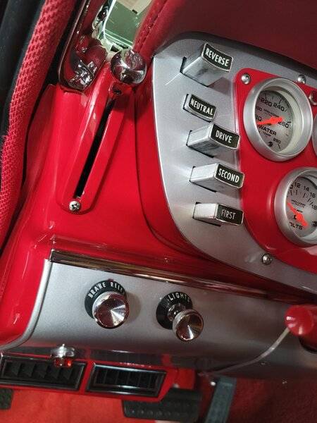

Just joined this forum. Looks to be a wealth of information. My spring on the push button shifter has also broken. Thanks to you guys i now know the part number. If anyone can tell me the best way to access this to replace the part I would be very grateful. Im including a picture of my shifter. I have looked under the dash and see no way to remove the mechanism.

Anyone?
You will need to pull your instrument cluster out of dash. Then you will see the mounting of the push button assembly and the shift mechanism. From there you can lossen it and either remove or replace the spring. Removing would be easier. A service manual would help!
Thanks, for the replies. I just received my replacement spring today. Will start tearing it apart
