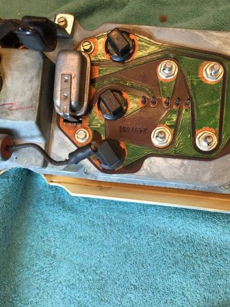

I am working on my 65 Belvedere and when I removed the instrument cluster the condenser that attaches to the voltage limiter was not connected. I have a service manual but it does not even show this condenser on the wiring diagram. I know one pin is the 12 volt feed, one is a 5 volt output and the 3rd one is a ground, but does anyone know where the condenser should be connected? I would "assume" that it should go on the 12 volt feed pin but I don't want to just be guessing. Does anyone know where the condenser should be hooked up? Thanks!

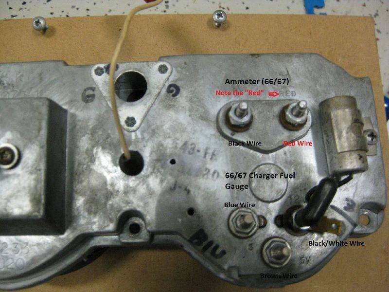

This is how it goes on my 66 Charger
It should be the same for yours
Photo from Mark Gibson The Gauge Doc
I smooths out the voltage pulses so the radio doesn't pick up any static, so: 12 volt connection.

Thanks for your reply because it does make sense to me but unfortunately
the wire doesn't seem to reach to the center terminal.
