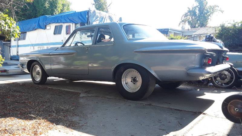

I 've got 10.00-28x16 hoosier slicks on a 16x8 torque thrust II, with 4.75 b's that fits well, stock spring location and tubs. I've also got 10.5x28x15 mickey thompson slicks on 15x8 1/2 centerline autodrags on 4 7/8 bs, but those need .300 spacers, and they are tight everywhere.

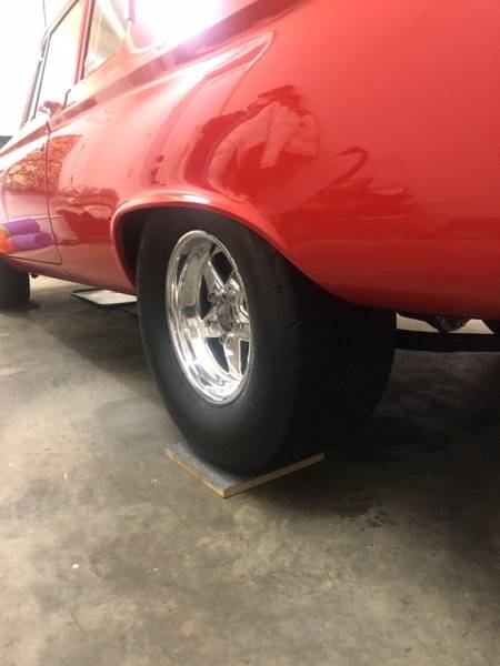

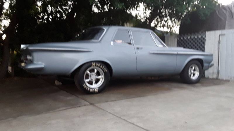

Thanks for your input Two Cents! Greatly appreciated. I also have a 64 Plymouth Belvedere with 28” Hoosiers on 15 x 8 Americans a with a 4.50” bs. I am running Cal tracks so the car sits low. The 28’s fit the wheel well perfectly and they look great! However, the Coronet has a rake due to super stock springs and spacers. I tried the 28’s as mentioned and they are lost in the wheel well. Just today I figured out I can run 29x10.50 -15 Hoosiers on 8’s with a 4.75 bs. They fill the wheel well really good and I like the look. It’s a slight rake so they sit nice. I will post on this thread.

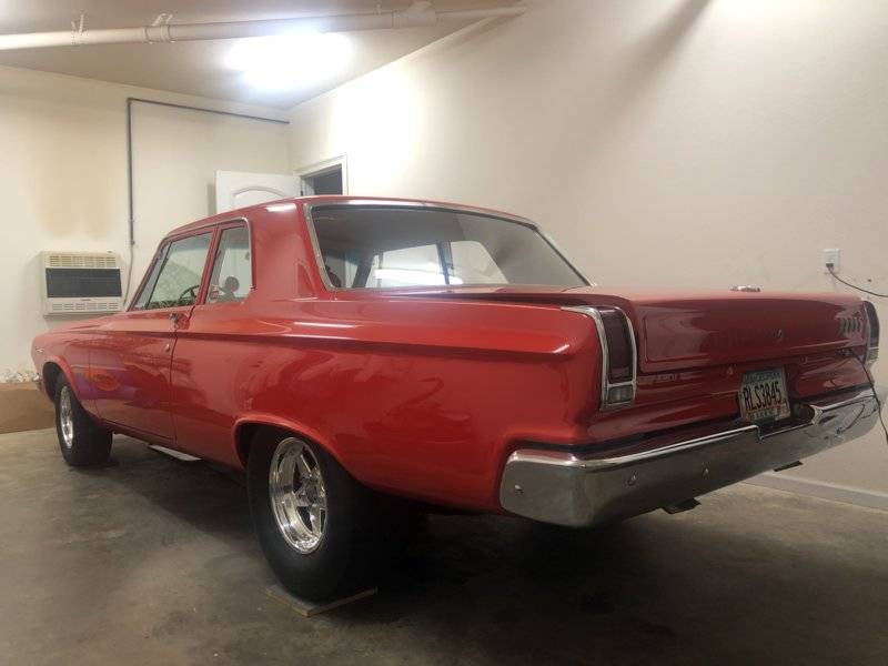

Two Cents! Just took a pic to show you how the car looks now with 295x65 15 BFGoodrich drag radials mounted on 9” Weld Dragstars. The BFG’s don’t hook well and rub on the inner wheelhouse. The 29 Hoosiers will fit on the 8’s with the 4.75 bs. Hoosiers will hook better and I prefer the Cragar look. It may be awhile before I get them I will post when done.
