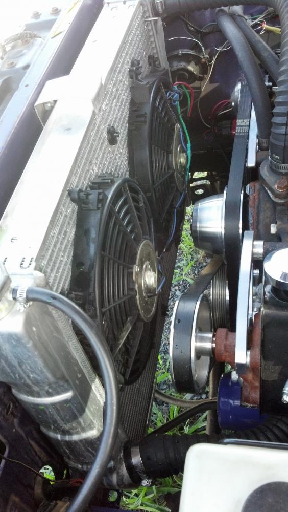

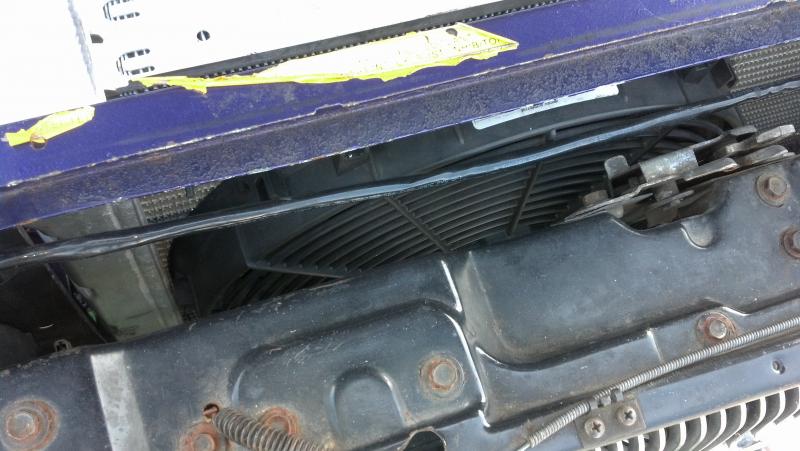

Finally got a chance to get some pics.

lmao..... every time i see that i have to laugh...DUDE....LOSE THE FANS...all they do is block air....you got both sides of the rad completely blocked and youre wondering why its overheating!!!!!!!!!!!!!!!!!!!!!!
put a stock fan or a flex fan on it and your probs are over....dont re-invent the wheel...its been done already!
I WANT YOU TO DO AN EXPERIMENT.....
get a house box fan
plug it in....TURN IT ON
hold it up to your face in the middle of the room with the air blowing on your face...can ya feel the air moving?...
NOW...............
walk over to a blank wall with the air STILL blowing on your face and put it up against the wall....HOW MUCH AIR DO YOU FEEL NOW
thats what youre doing with all those RIDICULOUS FANS UP AGAINST THE RADIATOR.....GET RID OF THE FANS
I had only the two fans on there originally. On the motor side. Added the third later to help the problem, and it actually did help a little. Stock fan wont fit with with the rad. I had the overheating problems with the stock set up which is what initiated this long struggle for cooler temperatures. No wheel being reinvented. Just a frustrating problem.
I'm on the fence with this "remove electric fans" opinion... I've read it in several posts now,,,, but I don't know if I buy it.... The manufactures "today" place them on plenty of cars by design..... Also, the fan can spin if the air flow pushing through the fan is greater than what the fan is producing on its own... Also keep in mind that the fan isn't blocking anything if the car isn't moving "sitting in traffic" it is only providing air flow that wouldn't normally be there.....

Thank you sir. That's what I'm saying. I've looked at this form every angle. Was hoping someone here would say "Oh, man, I had that same problem. Do this, that, and the other and you can fix it. Not be laughed at by a fellow mopar head when trying to resolve a problem.
nobody is laughing at you. i have had your problem and i am doing nothing but trying to help you. if i did not want to help you....i wouldnt have posted anything...but i have been in your shoes and the fans are the problem. if you dont want my help ,,,say so and i will bow out gracefully and let you spent a ton of money attempting to fix it and let you punch holes on your hood.
good day sir!
Heads are cast. And to reiterate the problem was occurring with the stock cooling set up, so i switched to aluminum rad and two slim fans. With two fans the car overheated after sitting at a red light for 3-4 minutes. With the third fan added this time has been greatly increased. Removing all the fans doesn't seem like a good idea. But i shouldn't need all of them on there, i do know that.
