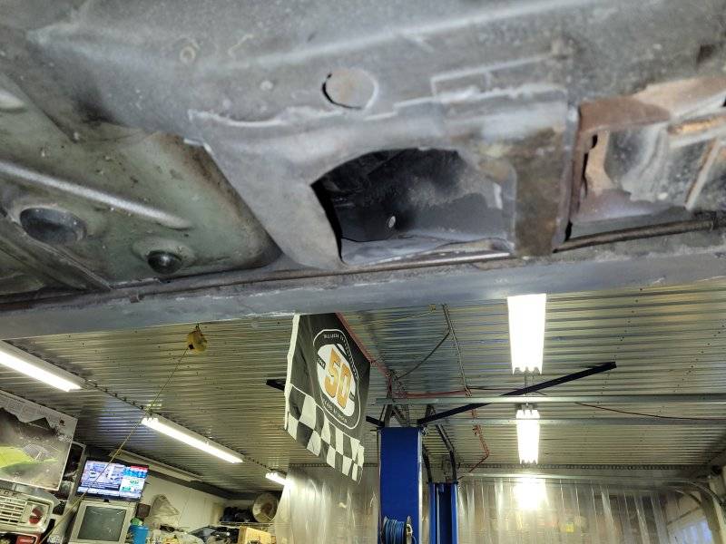

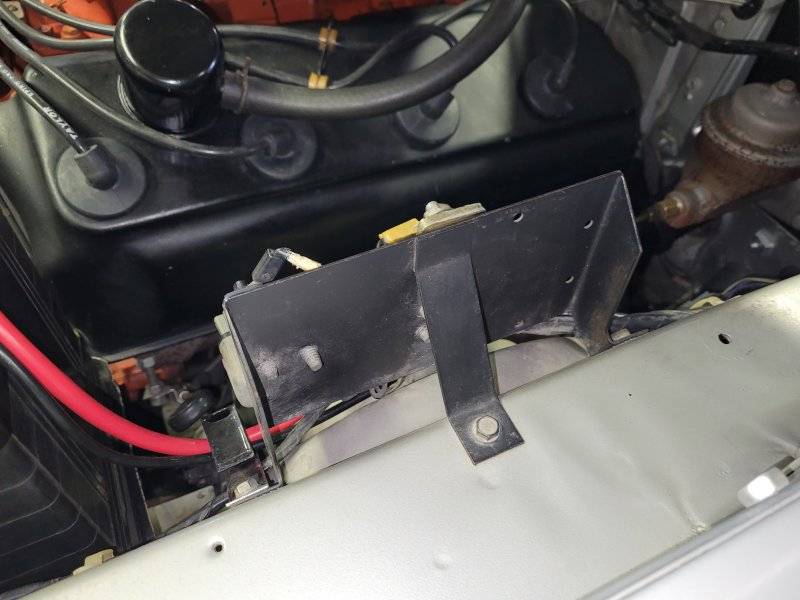

Did you notice the lack of torque boxes, starter relay and horn relay bolted directly to the inner fender and the round head pop rivets on the VIN plate?
did 66 have the torque boxes? Good eye :thumbsup:
It seemed like the torque boxes were hit and miss on the earlier cars. And the relay bracket delete may very well have been from the terrible generic motors brake conversion. The wiring still goes where it goes. And there's a factory bolt In the apron ..
The pop rivet vin tag isn't great, that's for sure.
At first with the 70s Dart hubcaps I thought of this car FOR SALE - 1966 Hemi Charger
Even the ones built in '65...

The car is a question mark to me. Not saying it is or it isn’t real. I would like to see the other areas of underbody reinforcements and the SO number on the radiator support. Maybe a paint shop removed the VIN plate for a repaint and put it back with incorrect rivets. It does appear to have a Hemi K frame. If a Hemi ever managed to get out of the plant w/o the underbody reinforcements, maybe this is it.
In spite of my earlier doubts, that the SO number on the fender tag does match the stamping on the radiator frame (recently added picture 104), and with the VIN tag showing a Hemi (even with incorrect rivets) this is pretty good documentation it probably is an original Hemi car. If it’s a re-body they must have transferred the radiator support in addition to the fender tag, VIN plate, k-member, etc, so they did a fairly good job, at least topside. And as pointed out above, the original starter relay fender panel is missing but the mounting hole for the top of plate mounting leg is visible in the correct location on the inner fender, and with a bolt in it.
This may be the elusive example of an early Hemi getting out of the factory sans the torque boxes and other Hemi chassis reinforcements that some have speculated about. I wonder if the original front sway bar is laying around in his garage somewhere?
