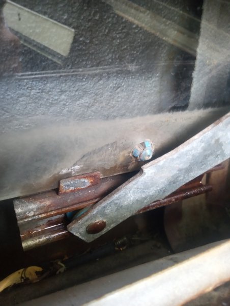

1966 charger trying to remove the driver side front window. I'm hoping to reuse this clip, is there any way to get this clip out of the window and still reuse it without damaging it? Thank you
If you use a c clamp.. a sleeve/socket on the outer side so the pin can press out and a 3/16" diameter pin you can probably get it out clean. That said I've removed 4 in the past few years and only had one that didn't break a tab off. And that said, the 5 dollar plastic rivet would be the least of my worries... it's the $$$ mylay slider material falling apart that's gonna set you back.
