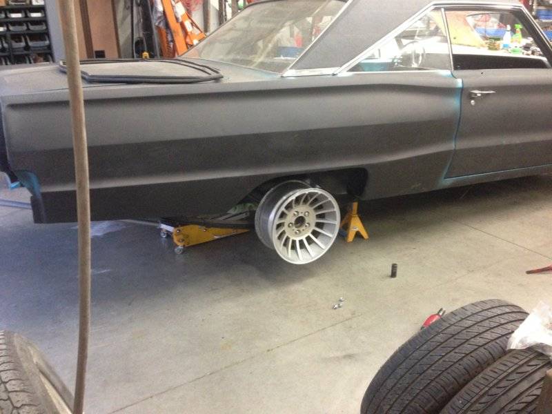

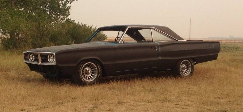

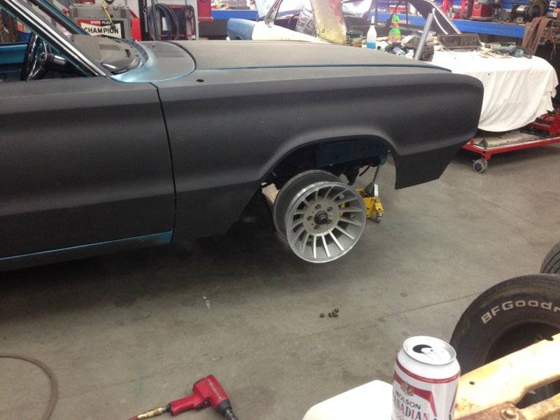

Revival! Ok. My goal was to inspect and drive this thing this summer. Pushing it now, but I'm days away from my windshield coming in and I have been wondering about rims / tires. So I'm lucky with scoring nice 14" wheels but with my big front brakes I need 15". I looked around and I found a set......in my mezzanine! These are 15X7-4" backspace 5x4-1/2" bolt pattern van wheels. I never though about using them. I thought they would be too wide bla bla bla. 66/67 thing. So I put one on. With a straight edge I have 3/4" clearance outside and over 2" to the spring. They'll do for now. Obviously with more offset I could get more tire. But I have a set of 225/70/15's that I will use for now. I still may drive it this year!
