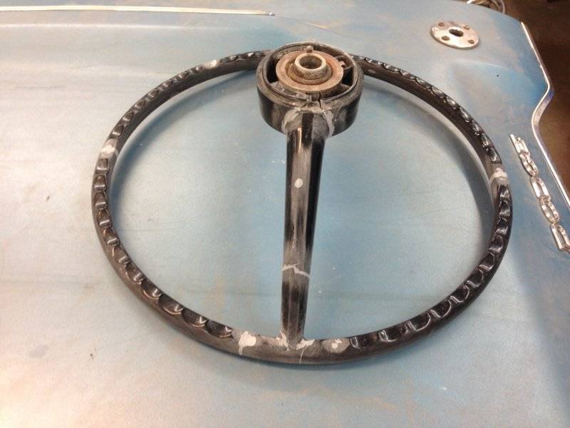

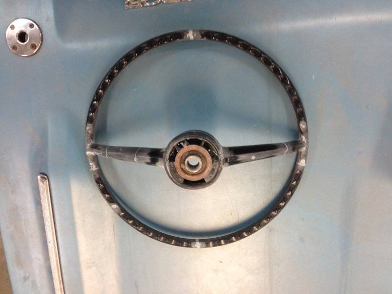

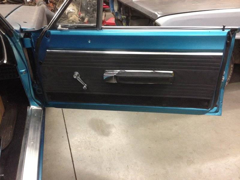

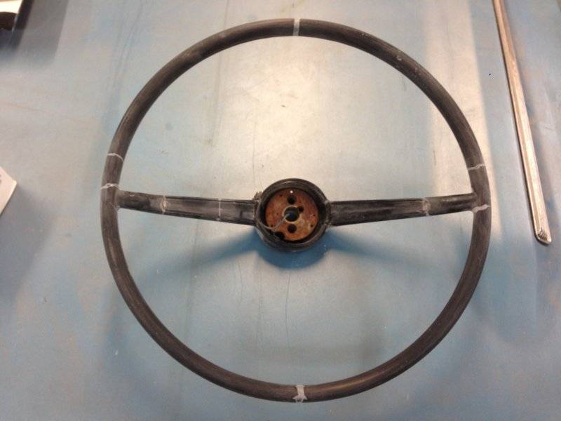

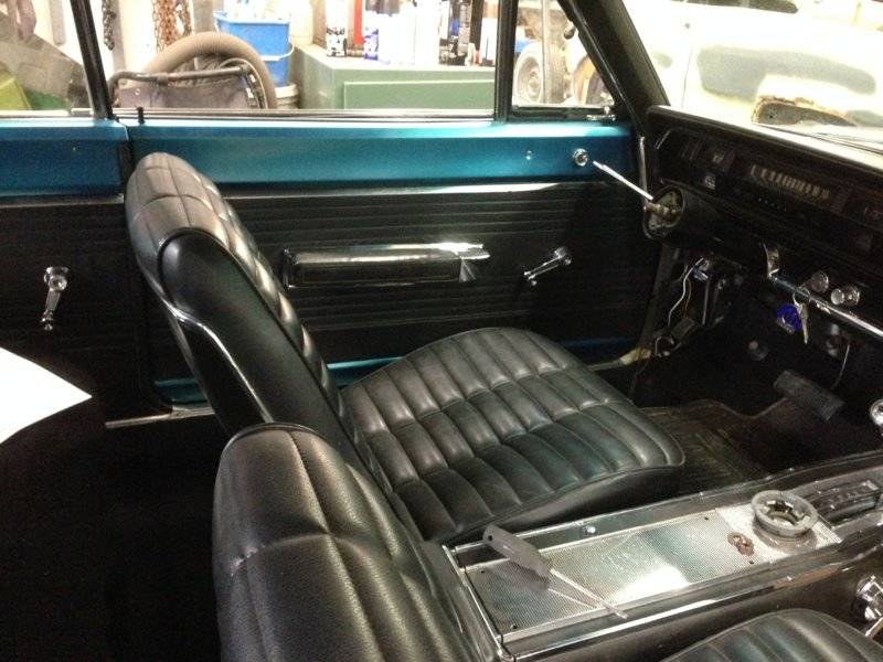

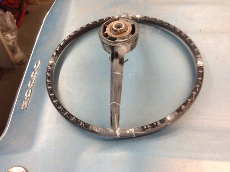

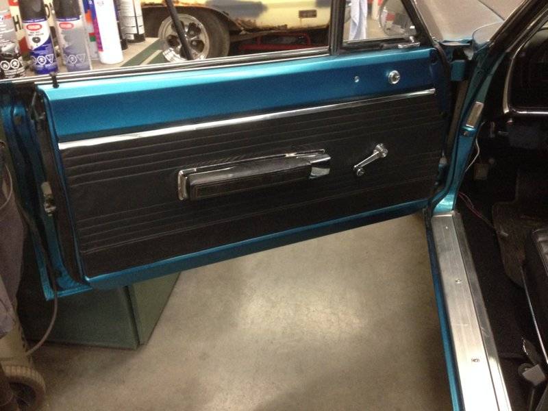

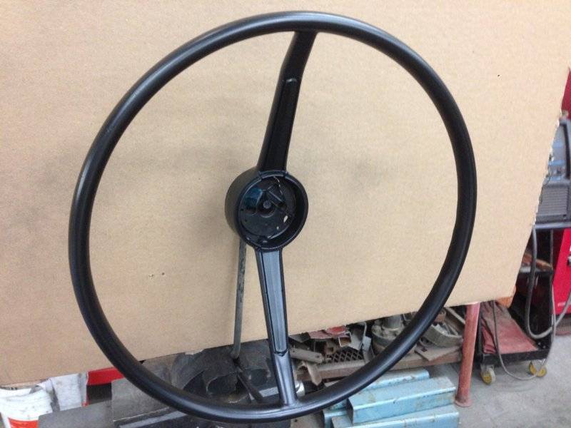

Getting down to the finishing touches. I think I am going to try and get it in for inspection this week. I installed the interior panels yesterday. Thanks to member @elephantengine for those. I got them quite a while back and finally put them to use. Then I filled the cracks in the steering wheel. There was a few!

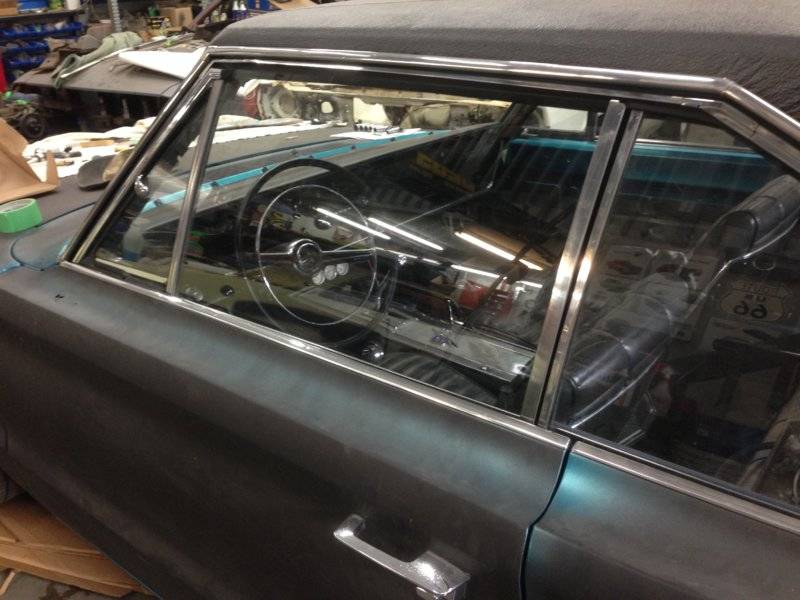

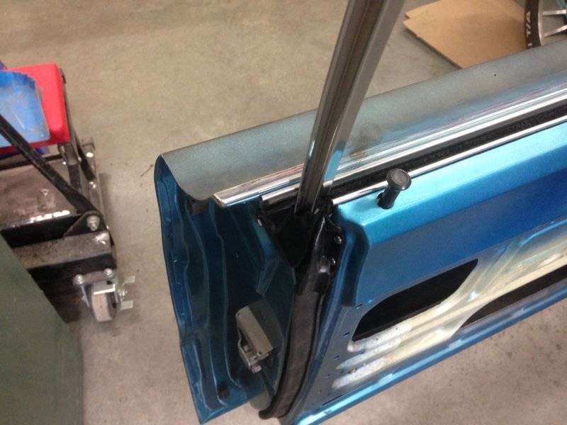

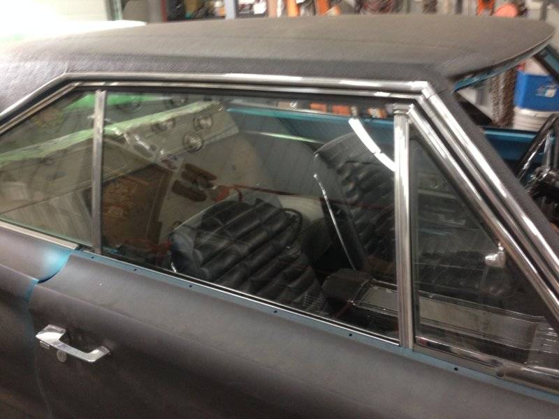

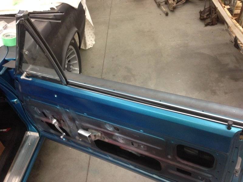

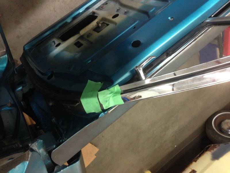

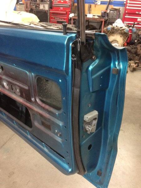

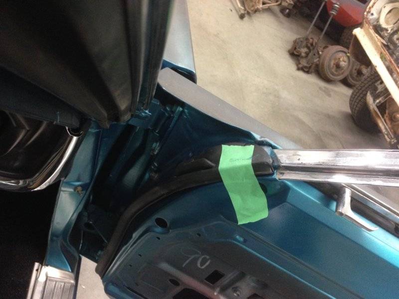

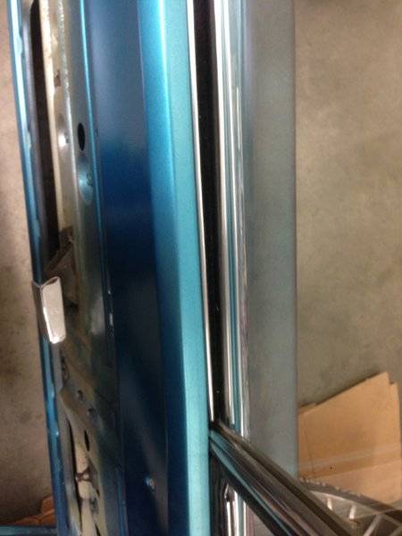

I got the bug again. So I installed the door glass. Yes, I was avoiding that as it's kind of a pain in the ***. But it's done. I'm very happy with the Softseal product, but slightly disappointed in the Cat Whiskers. The whiskers in the back were great, but these fronts left a little to be desired. I feel they are mistakenly clipped because they have a folded / finished edge at the front where you don't see it and the clips do not line up very well anyway. I actually had to trim a piece off the front of the drivers outside seal. I got it, but not impressed. Oh well, that's a job done and gone! The tape on the door seal is to help hold things in place while the windshield adhesive takes a grip. The doors definitely close harder now!

That's the thing with new rubber and cats whiskers. Replaced 'em all on my Coronet and I haven't been able to align the doors to my liking since. Maybe after the break in... Diggin' your car.
Thank you very much Sir. I agree the new rubber makes everything different. My windows even roll harder, that's probably a good thing though. The funny part is I got the pass door to close and line up very nicely. But the driver side is tougher. It is lined up perfectly but closes very hard. Maybe like you said, after time it will relax. I hope!

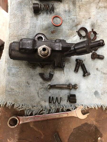

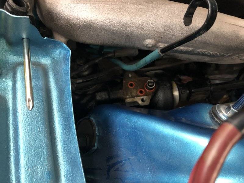

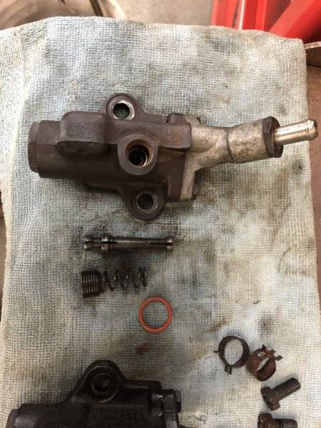

It's been a while. I figured I would start going over stuff to prepare for my inspection once the weather warms up. I figured I would tackle my power steering first. I searched this site but didn't really come up with any info, so I zipped over to FABO and dug up a very informative thread, albeit too late, and learned a little about power steering. I assembled my Coronet steering a while ago, but never hooked up the power steering. I wasn’t at a point to deal with it. Anyway, last night I put the belt on. I learned immediately that you don’t want your arm though the steering wheel! Yes, I reached in through the window and fired it up. :) instant right turn to lock! Fortunately my column is floor shift or it could have shifted into gear when it spun me around! Besides other possibilities. Anyway, I could not get the valve body to move enough to center. Something is wrong. Done for the night. Then I removed the valve body. Wouldn’t you know it. I screwed up long ago putting two units into one. I had to switch bodies for the return line. I never knew anything about any of it! Yup, should have done some research. Anyway today I installed a replacement valve body, lever and spring. Pics below should explain it all! First pic is the carnage! Damaged lever, broken spring and broken tab from not having the lever lined up! Did I mention it’s a big block? Rather tight, but at least it’s a B-body! I got really lucky and centered it upon install too!!!

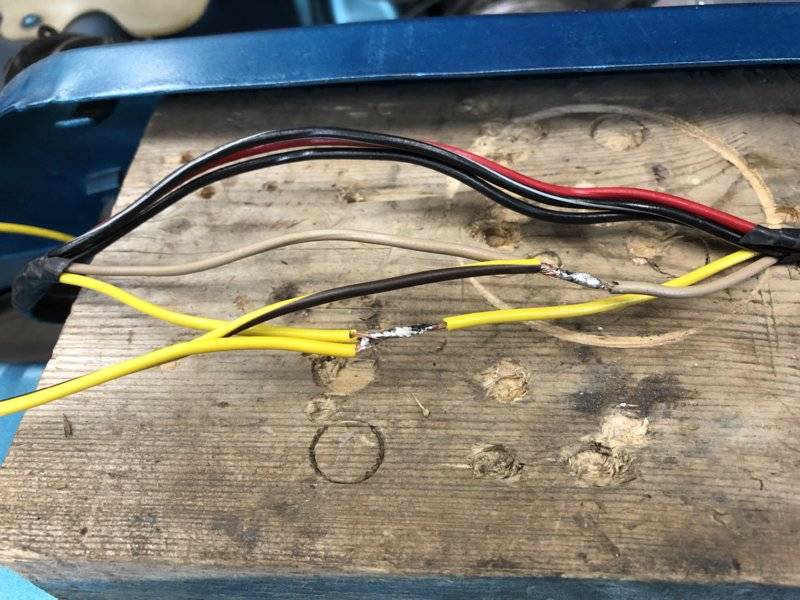

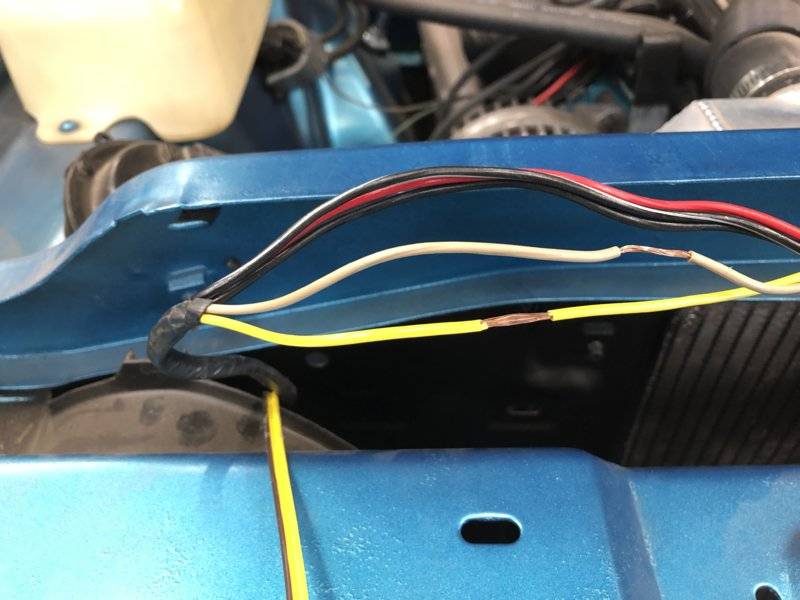

Next was an electrical gremlin that appeared a while back. I didn't put it together right away. When I installed my console, I had to modify the harness for the lighting. I swore I had everything working correctly when I did it. Then one day I hooked up the battery and moved the Coronet and noticed the interior lights were on continuously. I just parked it until today. It took me a while, but eventually I traced the short down. When I did the vinyl roof and installed the outer moldings, I caught the driver side sail panel light wire! Who'da thunk? Just enough to cause it to ground out. Well, I wasn't taking the molding off again, which would involve the headliner, so I just made a new wire and strung it in. Works like a charm. Now I'm off to get some LED bulbs for everything.
My Charger was my first Mopar restoration and learned all about that valve body the same way you did, quite the surprise!

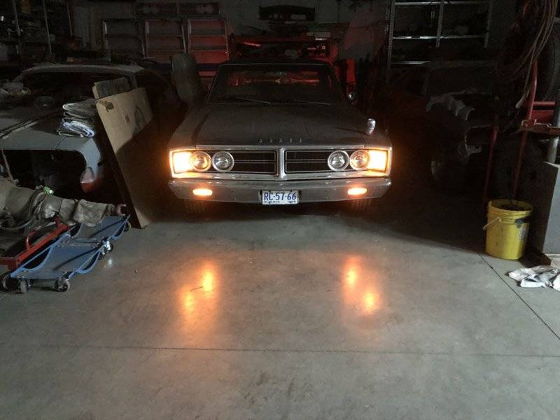

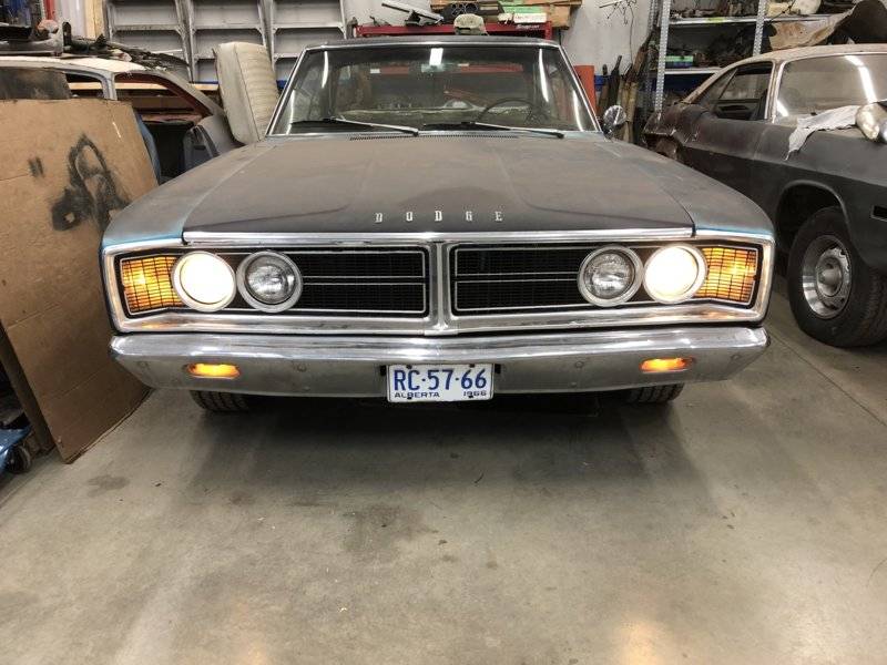

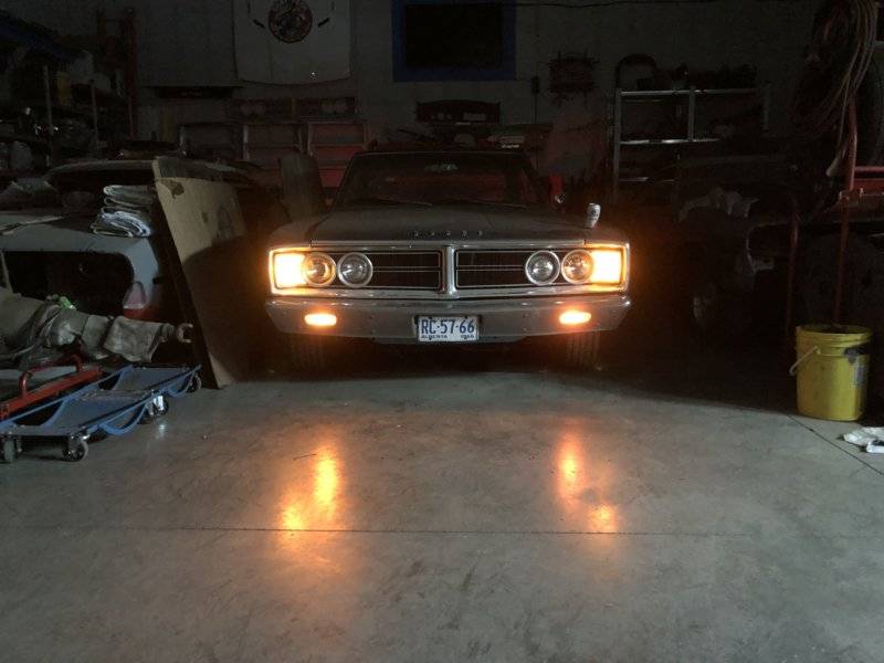

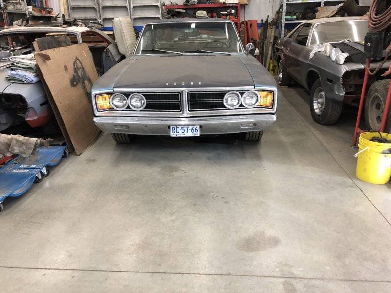

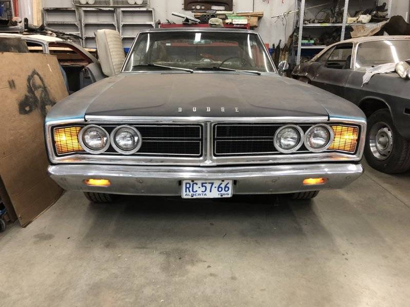

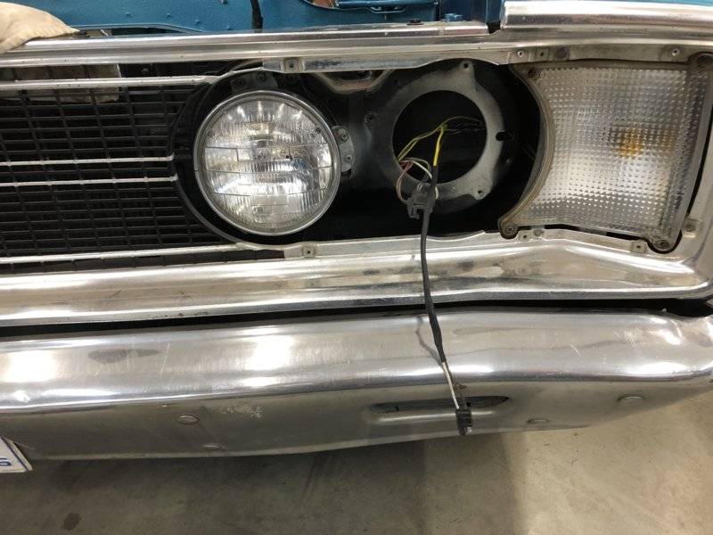

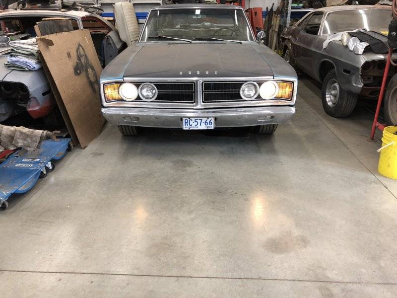

Today I put led lights in the console and the sail panels. Then I made a jumper wire on the headlight switch to make the front park lights stay on with the headlights. Pre69 shut them down when the headlights were connected. I like it better with them on. Now I’m going to make some wiring to bring the 67 bumper lights to life.
Done deal. I was just going to make them market lights only. I changed my mind, they are signals as well. I used a boat trailer plug to make the connector. I cut the outside two prongs off and it matched up to the factory plug perfectly!
