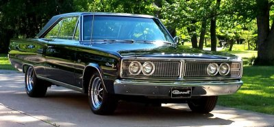

I have 8x15 Magnum 500's with a 4.5" backspace on my 66 Coronet 500 on the rear. Tires are 235/60R15.
